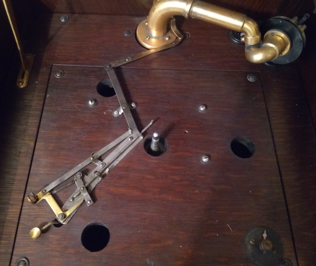

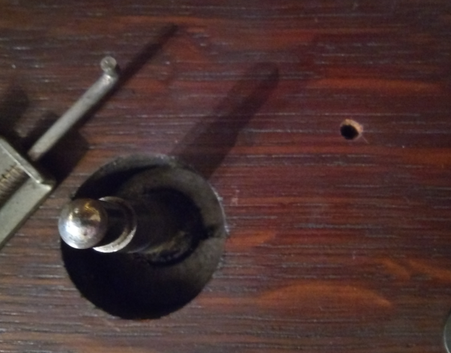

Motorboard Top
This post is just for documentation purposes.
You get a good view of the elaborate and highly effect auto-stop mechanism. I cleaned the mechanism up a bit yesterday and lubricated it all with an expensive light weight synthetic grease. It works better and more quietly now.
Also of interest to those interested in the minutia of things, you can see the hole in the motorboard for the screw for the shipping block that would have held the tone arm securely in place for shipping from the factory. The A-V user manual provides instructions for the removal of the block. I wonder if any shipping blocks have survived - rarities of rarities but probably not any collector's holy grail.

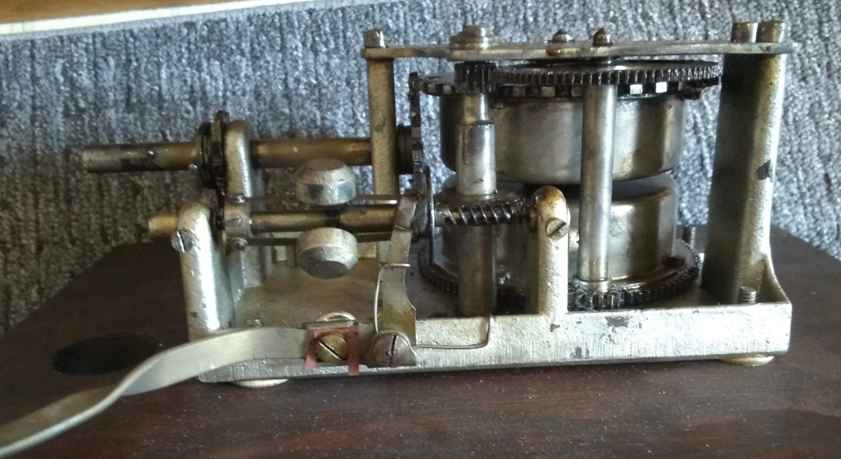

The Motor
This post is also for documentation purposes.
But there is a tangent to the topic of lubrication discussed in these recent threads below and a number of kind and helpful PMs I received on the topic. Lubrication is, it seems, a topic of some divergent opinion.
viewtopic.php?f=2&t=44099
viewtopic.php?f=2&t=51900
The dual spring motor is large, heavy, and strong. It has no problem playing anything, even the most atrociously worn 78s from the late 50s and early 60s.
Mine has obviously been serviced in recent years. It was slathered in some excellent quality light weight grease, something in the netherworld between light grease and heavy oil. It has a grey/black component to it. Graphite? Molybdenum? The service person's fingerprints have been left in the grease on the bottom plate with the A-V name.
I have removed a lot of this grease from areas that do not need lubrication. There was way more than could be justified for corrosion prevention purposes. And it was running off the motor and pooling on top of the horn.
I also removed a lot of it from sensitive parts such as the governor. The motor runs better and longer with adequate rather than excessive lubrication here.
Another thing of note is that motor was hanging loosely, suspended from the motorboard rather than secured to it. I do not suspect the service person of negligence here. I think it just works itself loose over time with winding and play, The fact that the motorboard was not actually fastened to the case before I put proper screws in it may have accelerated the loosening. Checking the tightness of the screws is now part of general periodic maintenance. They do loosen ever so slightly all on their own.

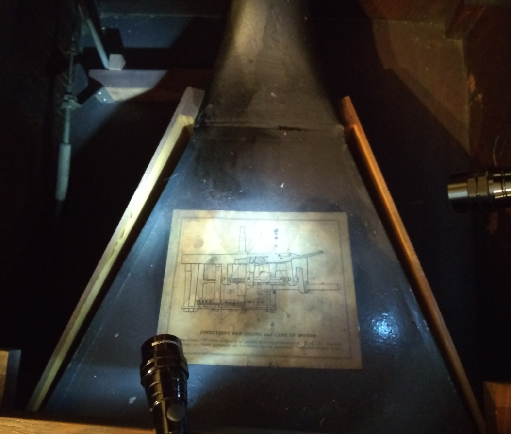

Inside the Horn Chamber
The service/lubrication instructions glued to the horn are now visible after I removed the deep pool of grease from the top of the horn. My double-ended magnetic snake light photo-bombs the shot.
On the left you can see the Graduola linkage. I forgot to lubricate this. Oh well. Next time.
I had to remove the block with the heavy felt bushing for the crank because I needed to figure out why the external Bakelite (?) bushing kept working its way out of the case while winding. It was in no danger of falling out. I had a very hard time removing it. I put a piece of electrical tape inside the hole, the piece about ¼ the length of the hole's circumference, then worked the bushing back in as far as possible, and finally used a wooden mallet with a very soft spruce drift to drive the bushing fully into place. Then I had to use a razor knife to trim the excess tape from the inside of the cabinet before reattaching the block with the felt bushing.
