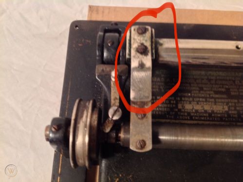

Ok another thing I noticed, is the half nut supposed to look like this or is something missing that goes on the half nut and spring to adjust the tracking?

Am I supposed to have the part I circled on the spring and half nut or is it a different design?

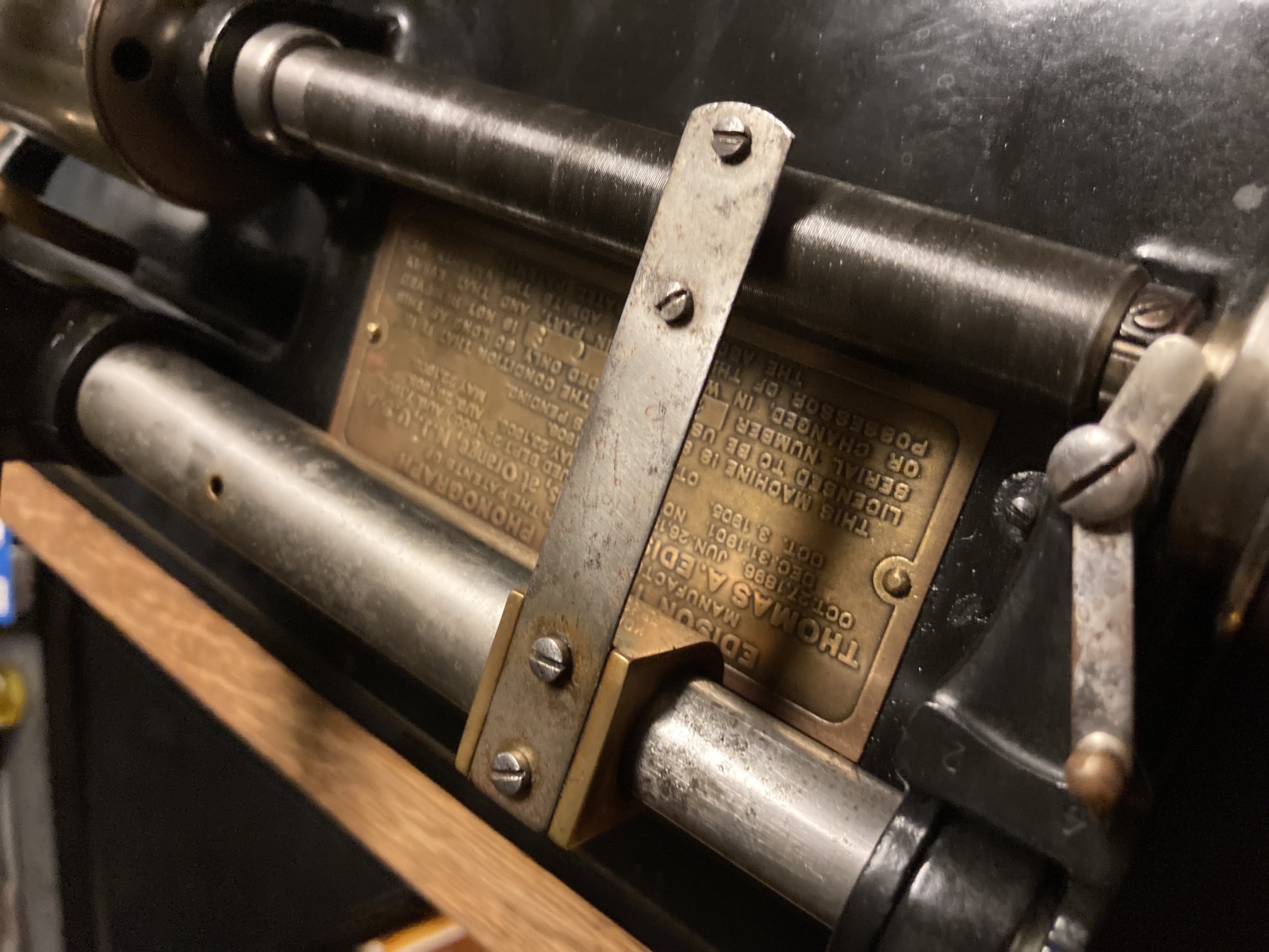

The half nut bar on my Triumph looks much like that, except it has a little dogleg to it, instead of being straight.AmberolaAndy wrote: Wed Jun 08, 2022 10:03 pm Ok another thing I noticed, is the half nut supposed to look like this or is something missing that goes on the half nut and spring to adjust the tracking?

Is the “dogleg” the part I circled in the other photo?Lucius1958 wrote: Wed Jun 08, 2022 10:56 pmThe half nut bar on my Triumph looks much like that, except it has a little dogleg to it, instead of being straight.AmberolaAndy wrote: Wed Jun 08, 2022 10:03 pm Ok another thing I noticed, is the half nut supposed to look like this or is something missing that goes on the half nut and spring to adjust the tracking?
