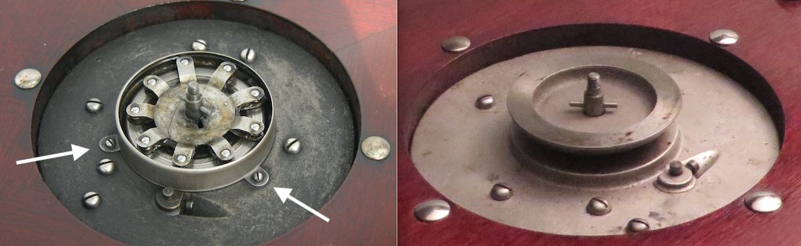

Re: Victor 6
The early motors have a simple spindle because the gear is not part of the spindle. It is critical that the spring are completely slack, otherwise you can injure yourself and ruin the gears. To remove the spindle, be sure that the springs are not applying any force, clean and oil the shaft below the gear, back the two set screws off and slide the spindle out. It may be a bit stubborn because the set screws can displace a little material.
I have attached a picture of the ball bearing setup. Also, the pin that holds the ratchet gear in place is a straight 3/32” steel pin, (.09375”). They are typically a slip fit into the hole and the pin has a small, displaced crimp near the center to provide an interference fit.

Re: Victor 6
I just want to note that Josh's motor and mine are the same, in that they do not have the holes in the casting for the ball bearing set-up.

Re: Victor 6
I understand that these twe motors never had the ball bearings. If “Look for the Dog” is correct, then both of these motors probably came from Pooley VTLAs. If Josh’s motor board lacks holes for bumpers, then it probably didn’t start out with that motor. If I was fortunate enough to own a Victor 6, I wouldn’t sweat that detail.
The nut in the top of the spindle can be reproduced with a counter bored extension like the one on a VV-XVI D, or a short sleeve can be added over the short cylindrical end of the spindle the prevent the turntable from “yielding “. I would prefer this to adding bumpers, (and holes). The risk of bending the spindle seems pretty low, but would need to be considered. The later motors had a .375” diameter spindle rather than the .3125”. The Victor D has a 12” cast turntable and a .3125” spindle like the Pooley and the 6, but had no ball bearing race or yielding turntable and seems to do fine.

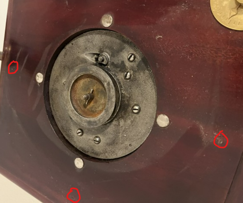

Josh_boro20
- Posts: 124
- Joined: Tue Oct 29, 2019 11:04 am
- Personal Text: Vintage sound
- Location: Seattle
Re: Victor 6
Those bumpers on the motor board screw in? If I have no holes in the wood nor evidence of it ever having bumpers. Would that mean it came with a yielding turntable?

- Posts: 6825
Re: Victor 6
Are you 100% certain you don't have the holes from bumpers??? Zooming in on these spots kind of shows holes to me. The holes that we're referring to are tiny nail holes, made by small tacks that stick out of the backside of the bumpers. They would be easy to miss, and maybe easy to have been filled in during a refinish. Look very closely.
