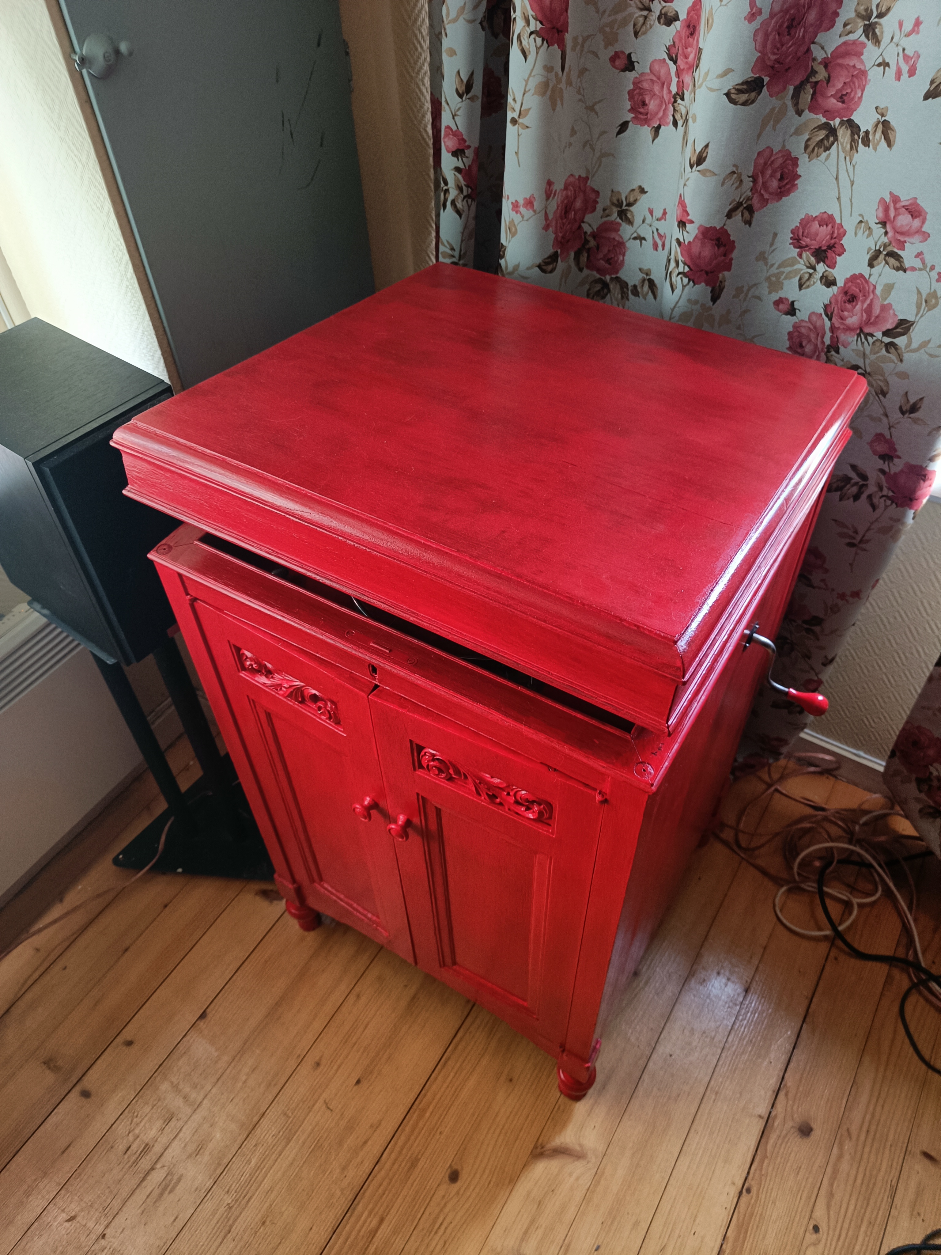

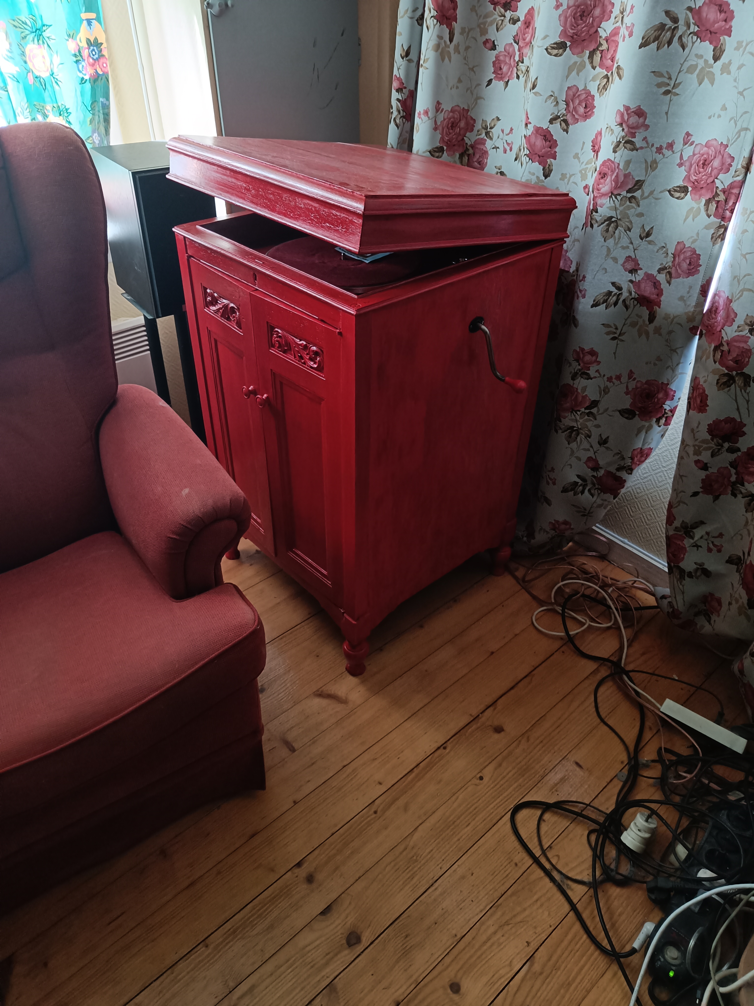

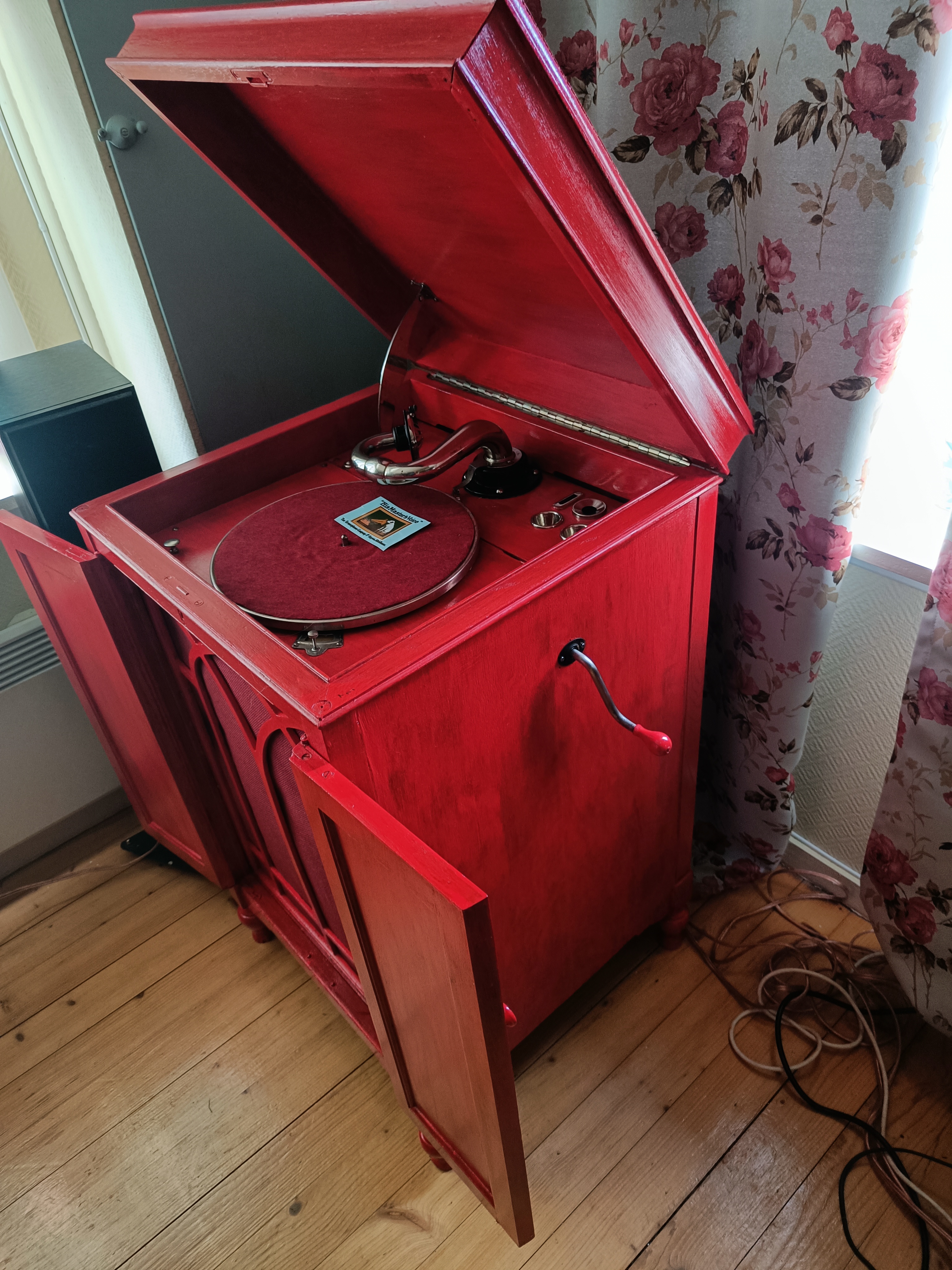

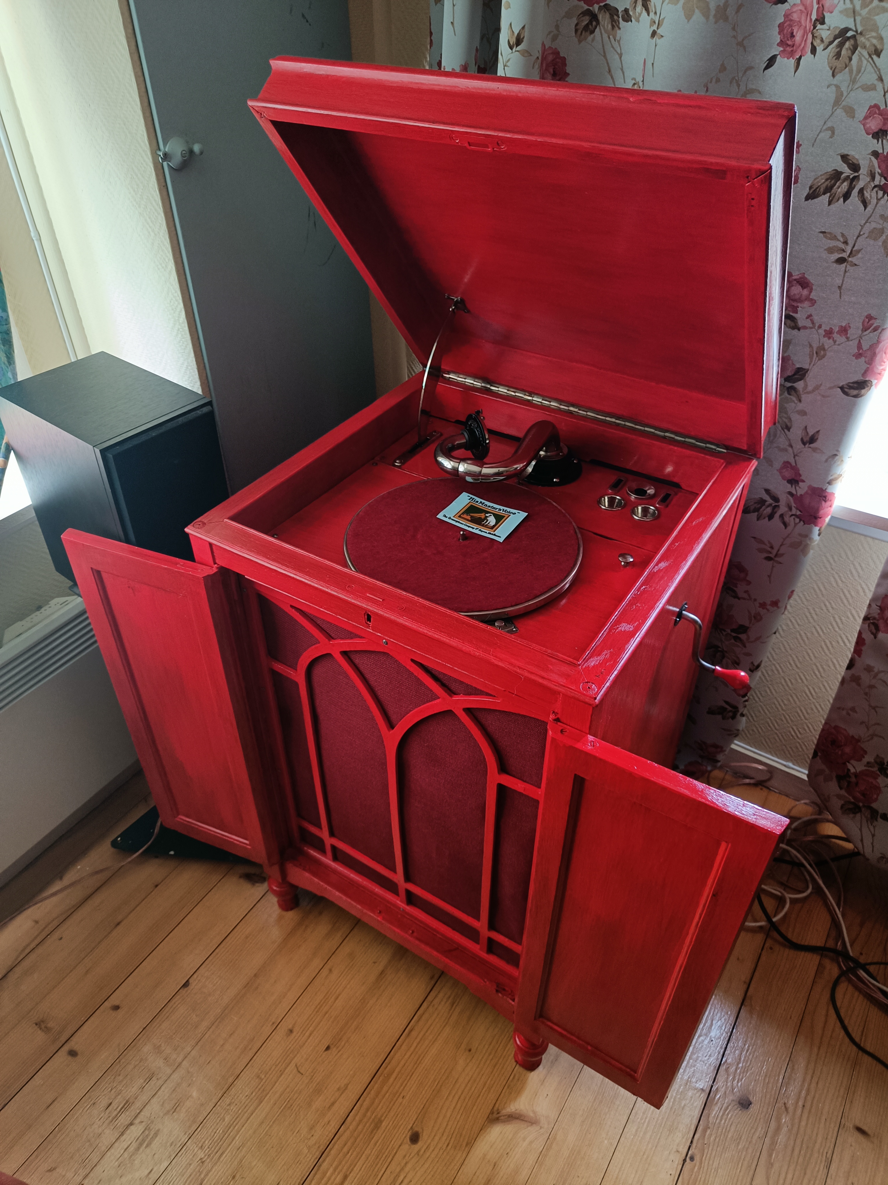

Okay, so here we go... :mrgreen:
No more leg cutting, and here we see the end result of restoring this already crippled 163.
Possibly the first red, yes red, HMV 163?
It very possibly has become a bastard, I am prepared to hear that, or whatever one choose to call it.
BUT, it plays as wonderful as any 163, and I like it a lot better now than in its "original" stripped and re finished condition.
I like it so much, that I have decided not to sell it, but keep it in my bedroom, next to a red recliner, where I can sit close to the oven
on cold winter evenings and play my favorite 78 rpm records :rose:

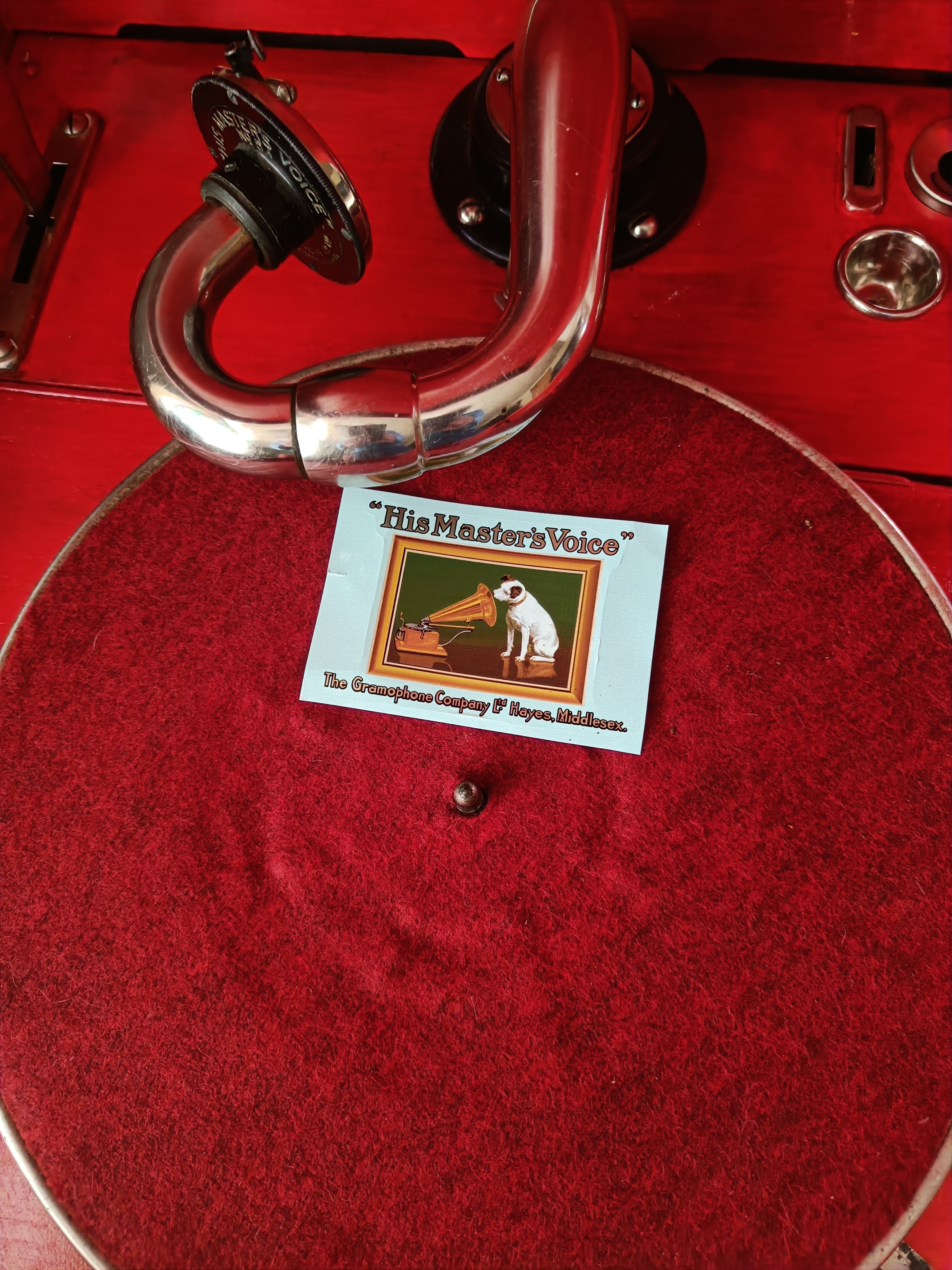

There is only one thing left to do, to attach the new decal, bought from Peru. I have looked at it, but am afraid of destroying it. Does someone know the procedure for removing the decal from the paper? I tried to loosen it with the nails, but it sits pretty hard, so I decided to ask before getting sorry.
PS. The grill cloth is bought from England, from a supplier of tested and tried loudspeaker cloths.

You don't peel the decal dry. You soak it in water first and then it'll easily slip off its backing but be careful it is SO easy to tear the decals when placing them! The decal should have come with instructions. I know this seller in Peru and his work is outstanding. If you follow his instructions you'll be fine!

Oh dear, I am happy I asked here. The decal came with no instructions, he must have forgotten to attach it.
Steve, do you remember how many minutes it should be soaked, in cold or luke warm water, before it slips off the paper?

I decided to use a red stain (two layers), that is sold for decorating art objects etc. On top I have applied 4 layers of shellac to allow it to shine, and protect the stain. It has been an interesting and time consuming work. And now it fits the color of my recliner, and bedroom curtains, and well..I wanted something that was bright, and not dark/black this time, since my sitting room is dark enough already from the rest of my gramophones.
Now my bedroom is keeping its bright style... :lol:

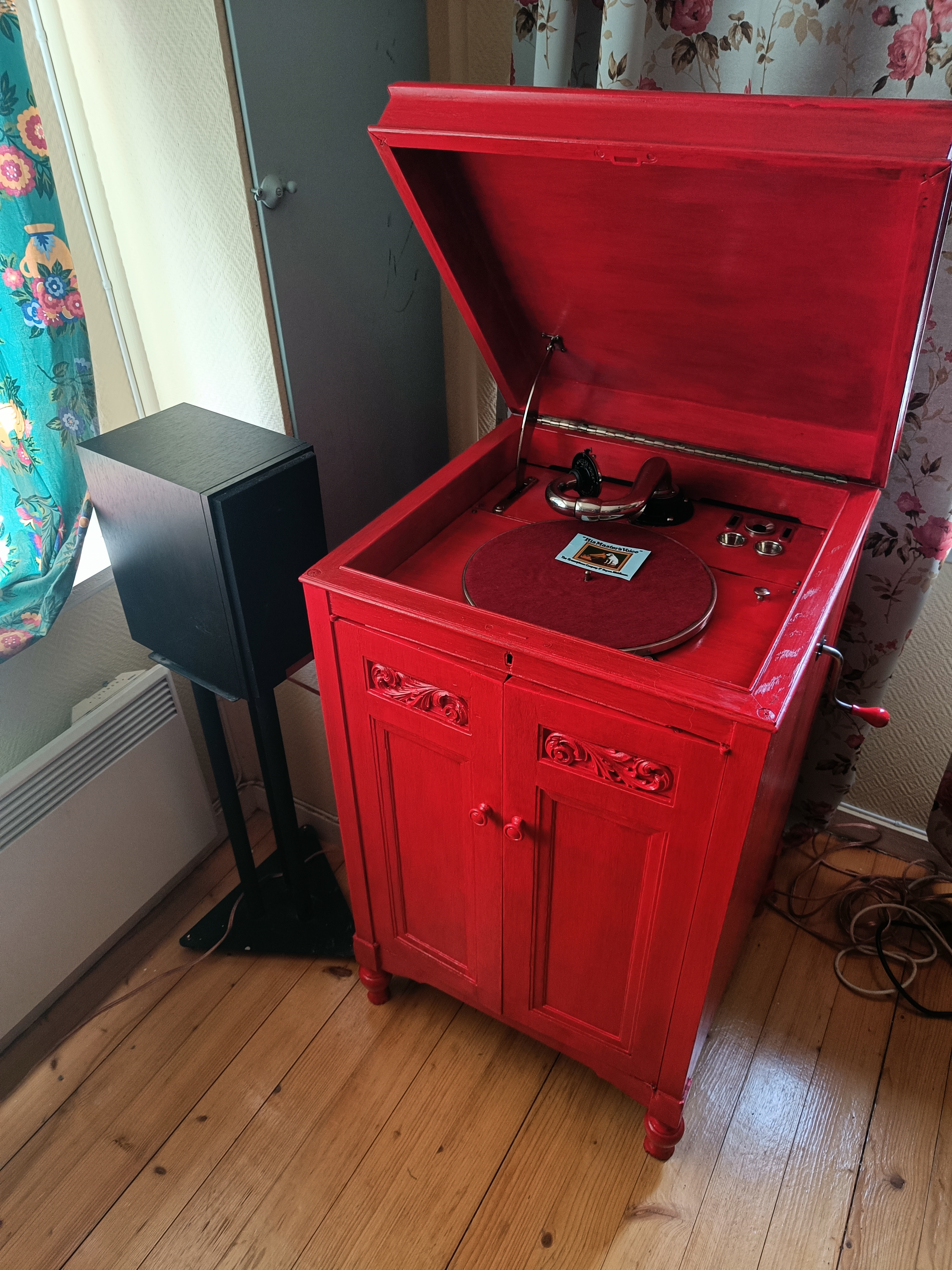

Looks neat, and you did good job, but for me it is too bright. I rather prefer Chinese a little bit darker red lacquer.

I don't know what Chinese lacquer is, and it for sure wouldn't be something I would get in my area. Actually, I had to choose from this red color, or orange, and well..it was an easy decision. :lol: But that said, yes...I would also have preferred a somewhat darker red.
Here we can see how it appeared this morning, it is somewhat darker, than the uploaded photos from yesterday, in different light conditions.
