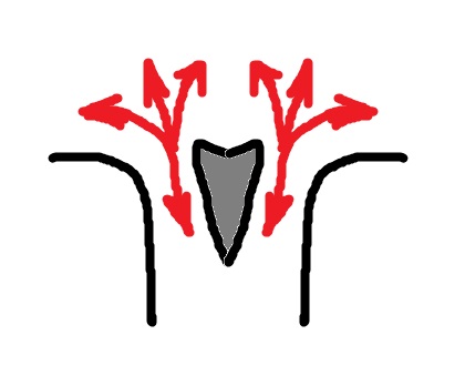

The three-leg thing with the bullet shaped prong that goes inside the soundbox outlet or neck is the 'phase plug'. The three legs are only the means to support the central bullet, which is the real core of the contraption. This helps channeling the air currents coming from all around the back of the diaphragm into one single current inside the neck. Of course the flow of air is turbulent, goes back and forth and so on... so the conclusion on the benefits of the presence of the phase plug must have been 50% theory... and 50% trial and error! But examining the shape of the neck or outlet that goes from the air chamber to the tonearm, the outer part has a soft curvature, and the inner part has the bullet, which makes it all a conduit in this shape, in cross-section:
phase plug.jpg (21.72 KiB) Viewed 409 times
