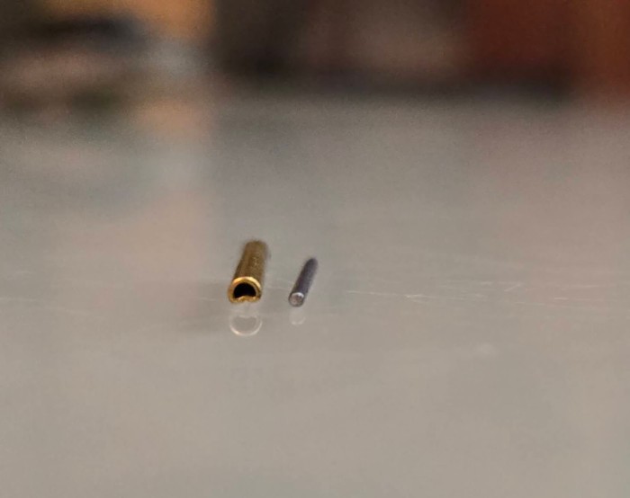

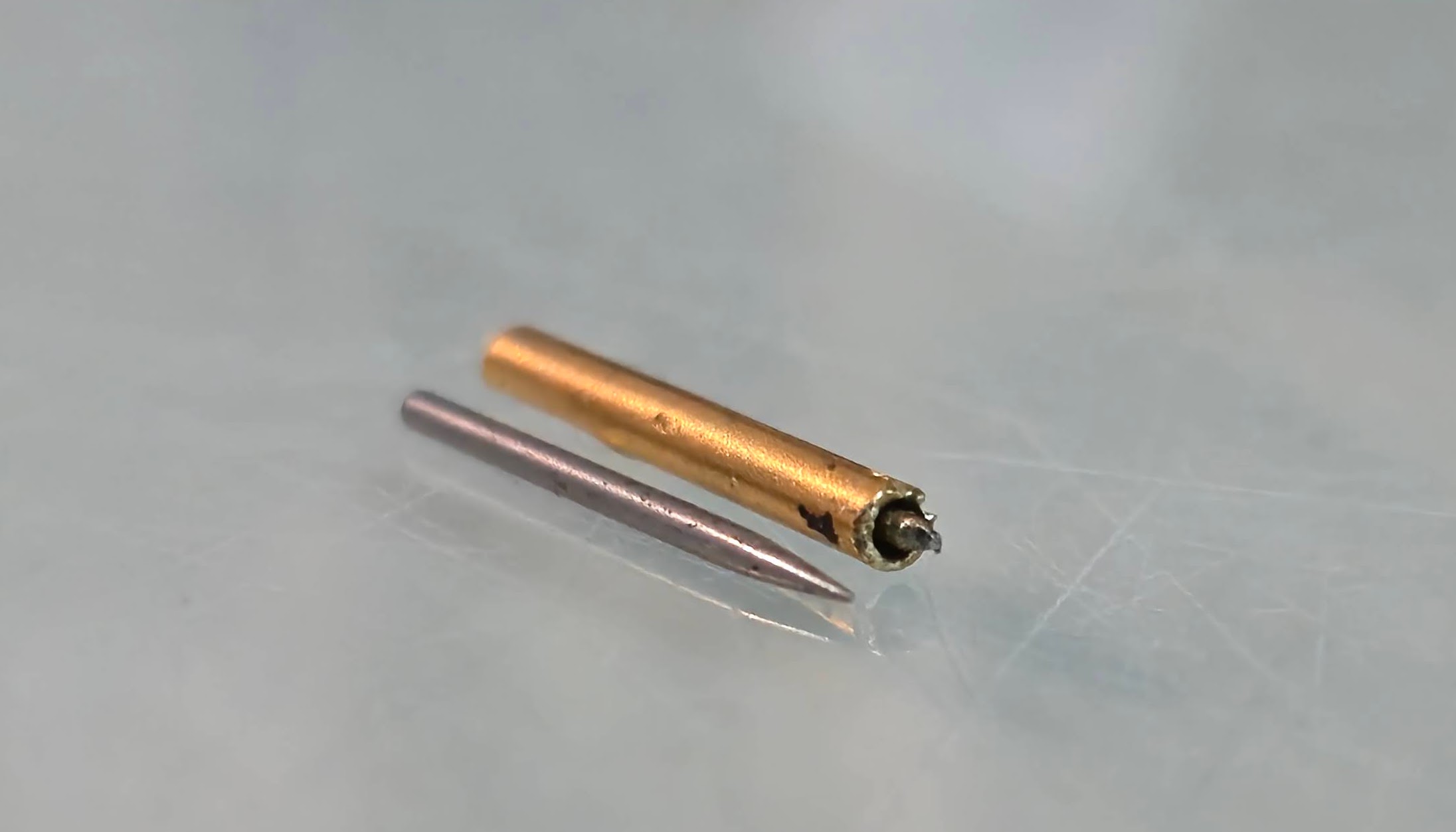

Wondering if my issue is the housing the needle is in. It's a small piece of conduit and increases the overall size. I tried pulling the old needle out with needle nose pliers. Just the very tip of the needle is exposed, but could not get a good grip on it. My plan was to put a new needle in the tube housing. I took side-by-side pictures to show the size difference. No idea where to buy these metal tubes, or if I really need one. Has anyone seen something like this?

That is not a case for inserting needles. That actually looks to be a shot multi-play phonograph needle, which was used on 1940s era electrically amplified phonographs. I once tried using this type of needle on a victrola, but it ruined the record groove after only one play.

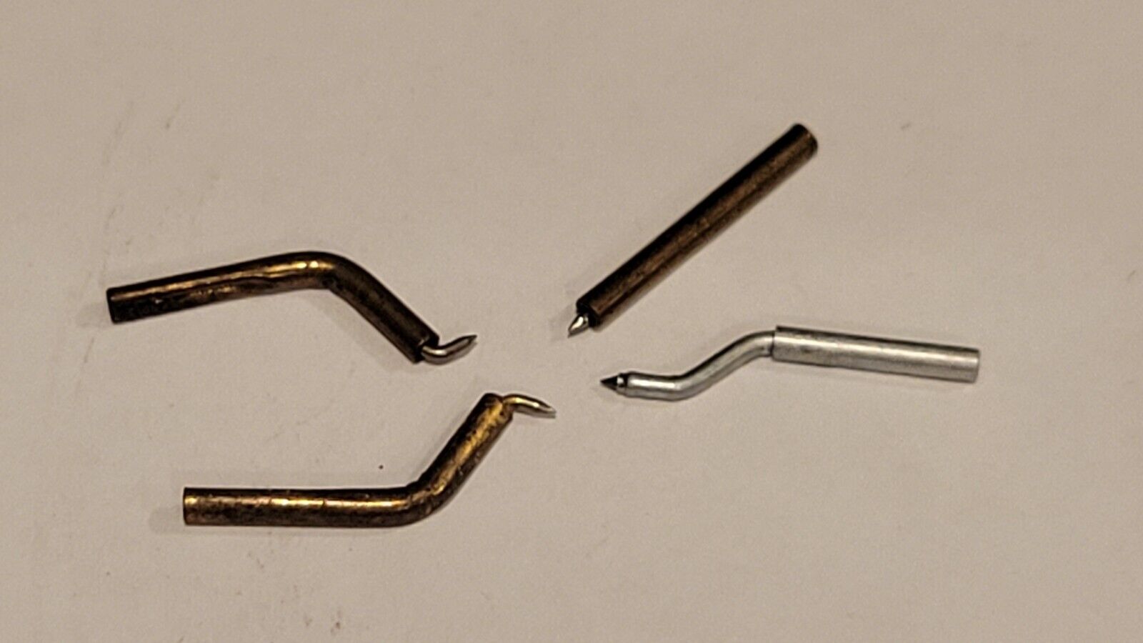

The "tip" is not removable from the shank. Some had jewel tips, some were plated with a protective metallic substance. (All wore out in time--they were good for X-number of plays.) A variety were sold; some oddly shaped. Here are a few examples culled from an eBay ad --
Your best bet is to use a conventional steel needle, which you insert directly into the needle bar's "hole" and fasten tight with the thumbscrew. About the only option for a long-play needle on an acoustic phonograph would be the Tungsten Tipped stylus, described here -- http://www.victor-victrola.com/Needles.htm (You could also use a fiber needle or a thorn/cactus needle, which requires resharpening after each play.)

Thanks for that! I was thinking it would better place the needle in the correct spot, but maybe need to stick with the basic steel needle.
