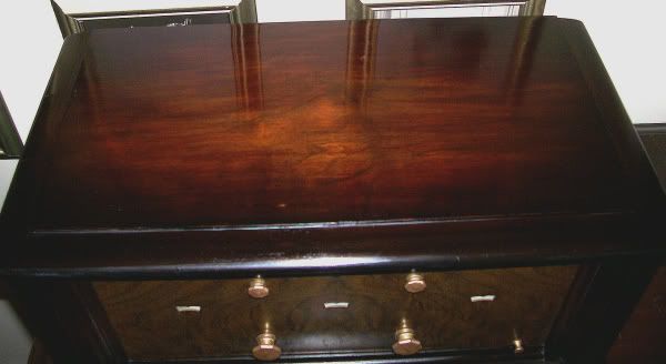

I can, and do, but generally only for resale, for I prefer my oen machines to have glossy, ever so slightly checked original finishes. Below are photos of a Sparton radio of 1925 or 1926 vintage which came out of a barn. It was the first set of the grandfather of a friend of mine. The finish had entirely fallen away, and the veneer on the lid was peeling and shattered. I re-veneered the top of the set with appropriate walnut, filled and stained the wood (I use Plaster of Paris rather than pumice, as the work sets faster) and then French Polished the resulting surface. The rather pronounced "Blended Finish" is directly copied from an original in my possession, and was produced with the use of Analine dyes, about half-way through the finishing process. In all, that rough radio cabinet took about four hours to restore, over a period of about a week. It is not a particularly good job, but the photos were at hand.

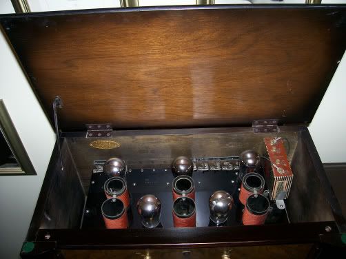

Now, this Atwater Kent breadboard was an alligatored, rusty mess. I disassembled the entire set, repainted the cans, rewound the audio transformers, replaced the brass parts with well preserved AK parts salvaged from an early AK Model 20 cabinet set, re-wound two of the RF transformers with wire salvaged from old Atwater Kent tuning coils, restored and overpolished the badly deteriorated, rough, nearly black original finish on the base-board, carefuly leaving a just a bit of checking, and then reassembled the set, offering it at auction as a restored radio. The buyer subsequently sold the unit on a well-known auction site as an extrordinarly well-preserved, working original example (for more than twice what he paid).
I do try to make my work unobtrusive, but as complete as was this restoration, it only occupied three evenings puttering in my shop last November. The photos posted above were taken by the buyer. He is a far better photographer than I.

That's fraud, pure and simple, but the vendor must not fear to be unmasked, when I consider the knowledge of some chance buyers. Because, on one hand, this speaks for the quality of your work, which is very good indeed, judging from the images. But on the other hand, objects time-savingly restored with not contemporary methods or materials are also sold at high prices. Many collectors are amateurs when it comes to the question which craftsmanship would be appropriate on a 100 year old technical object. It is not enough to know which reproducer is correct on your phonograph.Uncle Vanya wrote:The buyer subsequently sold the unit on a well-known auction site as an extrordinarly well-preserved, working original example (for more than twice what he paid).

Beautiful job on the AK breadboard.

Your work looks to be stunning.

I would be thrilled to have that radio, no questions asked. If it had been plugged in, in its before state, it would have set the house on fire. Beautiful work! I don't collect radios anymore......nothing to listen to!
