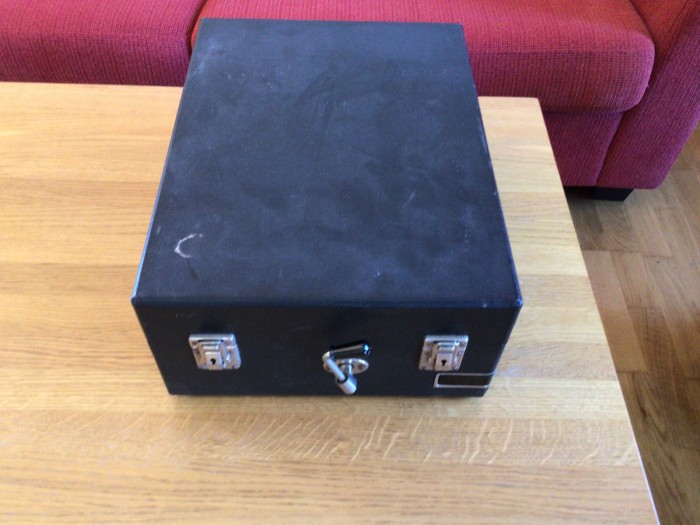

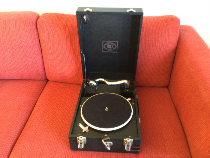

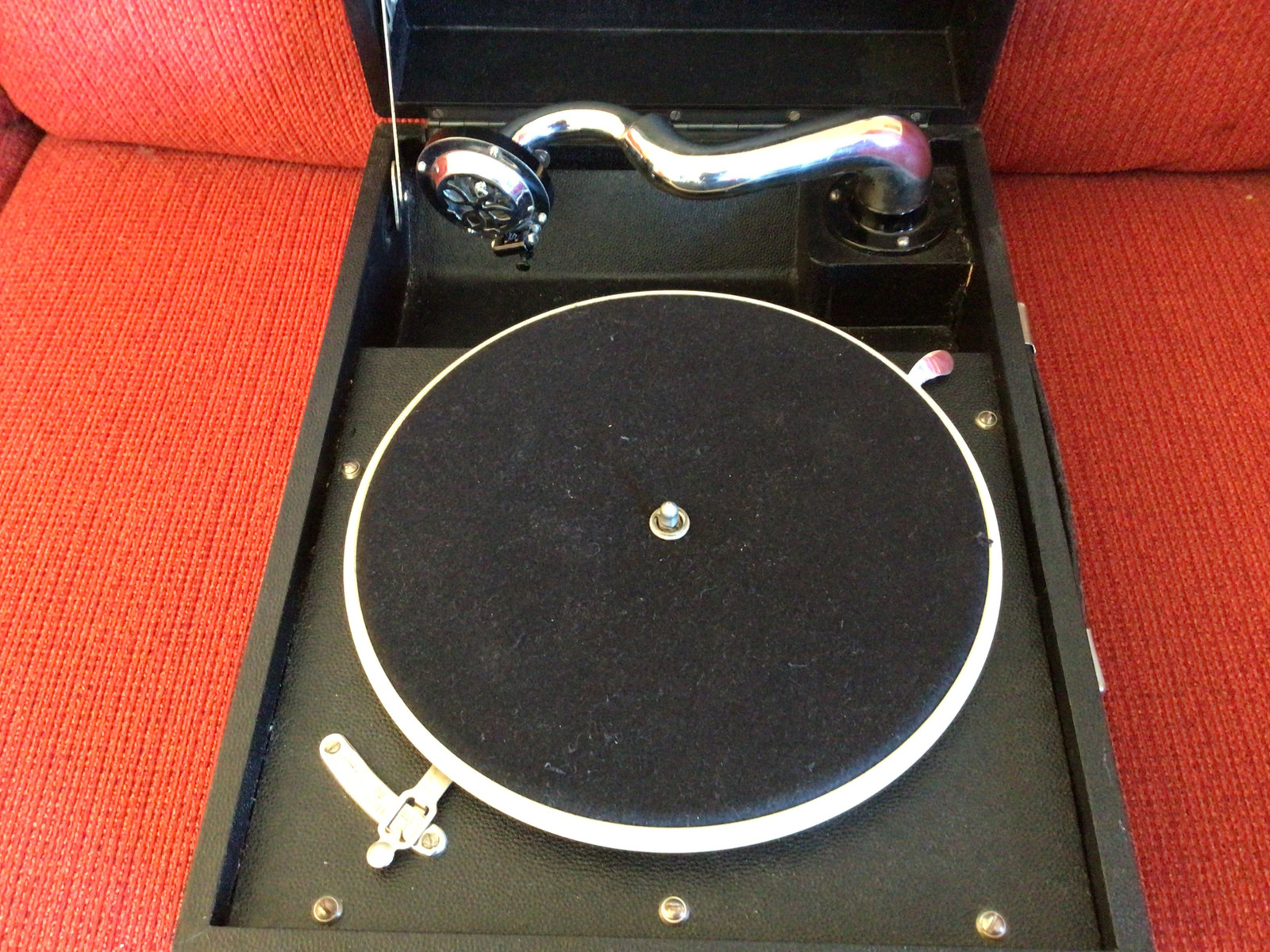

Does someone know anything about this portable brand, Trek 505? I used Google, and found a similar machine was sold in South Africa in the past, and also understood this make
was sold down there when searching the forum. It seems to have a Garrard motor actually, but was it made in the UK for export only, and by whom? Unfortunately there is a big hole in the lid, but apart from it it looks good, even if the seller says the machine is not running. € 30 is the price. I am tempted, because of the Garrard motor, and the soundbox that looks intact.
- Posts: 4682
Re: Portables to identify and discuss
It looks great... and has its details, as the brass grommet in the turntable felt. The hole in the lid doesn't look terrible, it could be repaired. And springs for Garrard motors are easily available (soundgen, for instance).

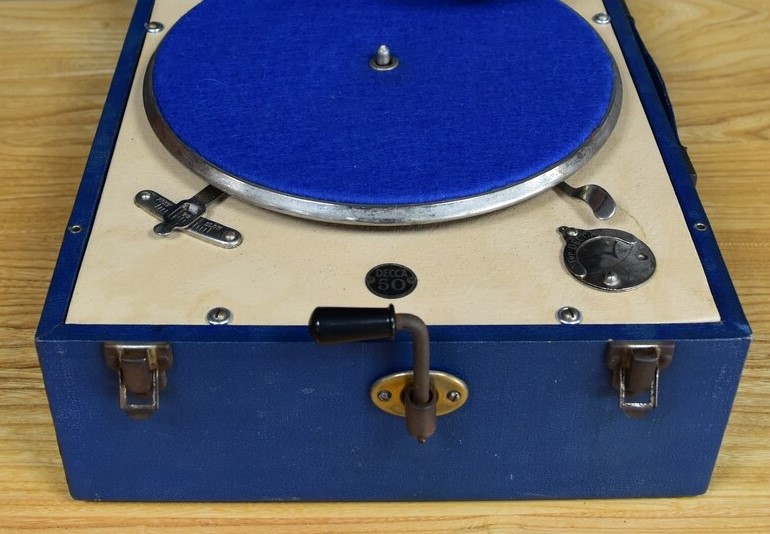

I don't know who made the Trek portable, but the distinctive winding handle which folds against the case rather than into it (as with pre-EMI Columbia portables) was also used on many post war Decca portables such as this Decca 50 :

When we look at the Decca 50, both the speed control and the manual brake looks exactly similar as on the Trek machine. But I don't know if this brake and speed control also was used on other UK machines, than Decca?

The speed control and brake are Garrard fittings, and came as standard with the motor. They are fitted to hundreds of different models.nostalgia wrote: Sat May 08, 2021 9:15 am When we look at the Decca 50, both the speed control and the manual brake looks exactly similar as on the Trek machine. But I don't know if this brake and speed control also was used on other UK machines, than Decca?
