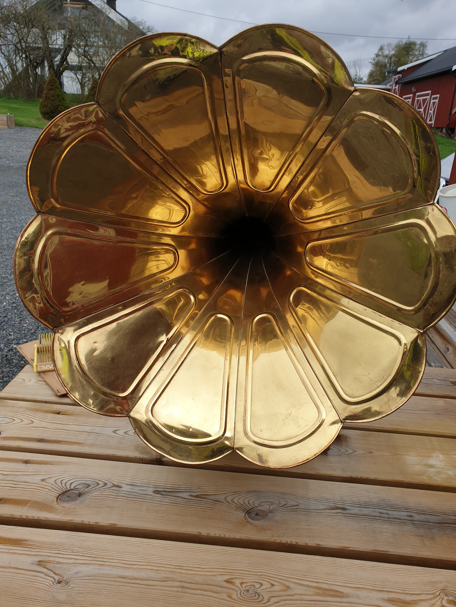

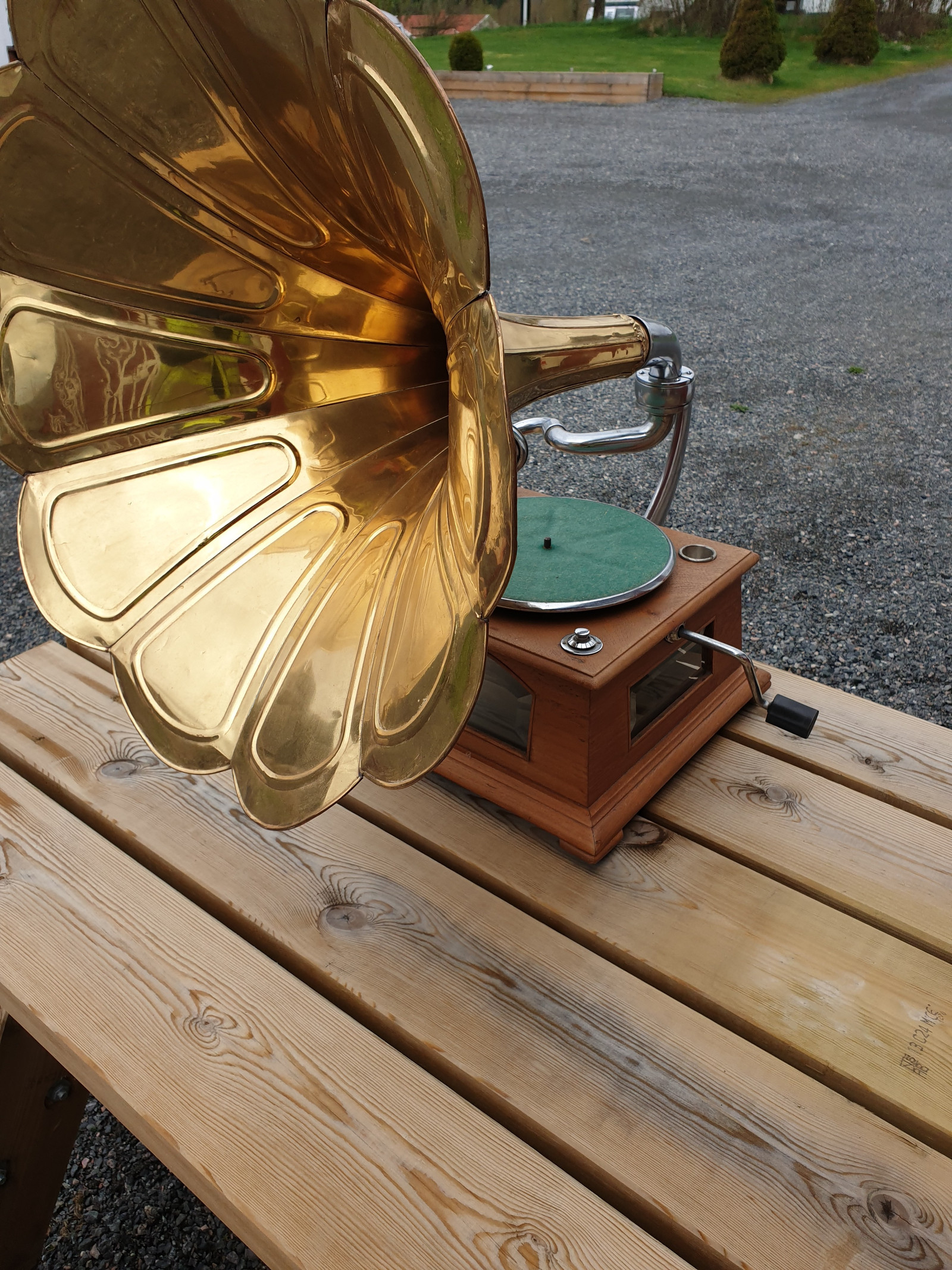

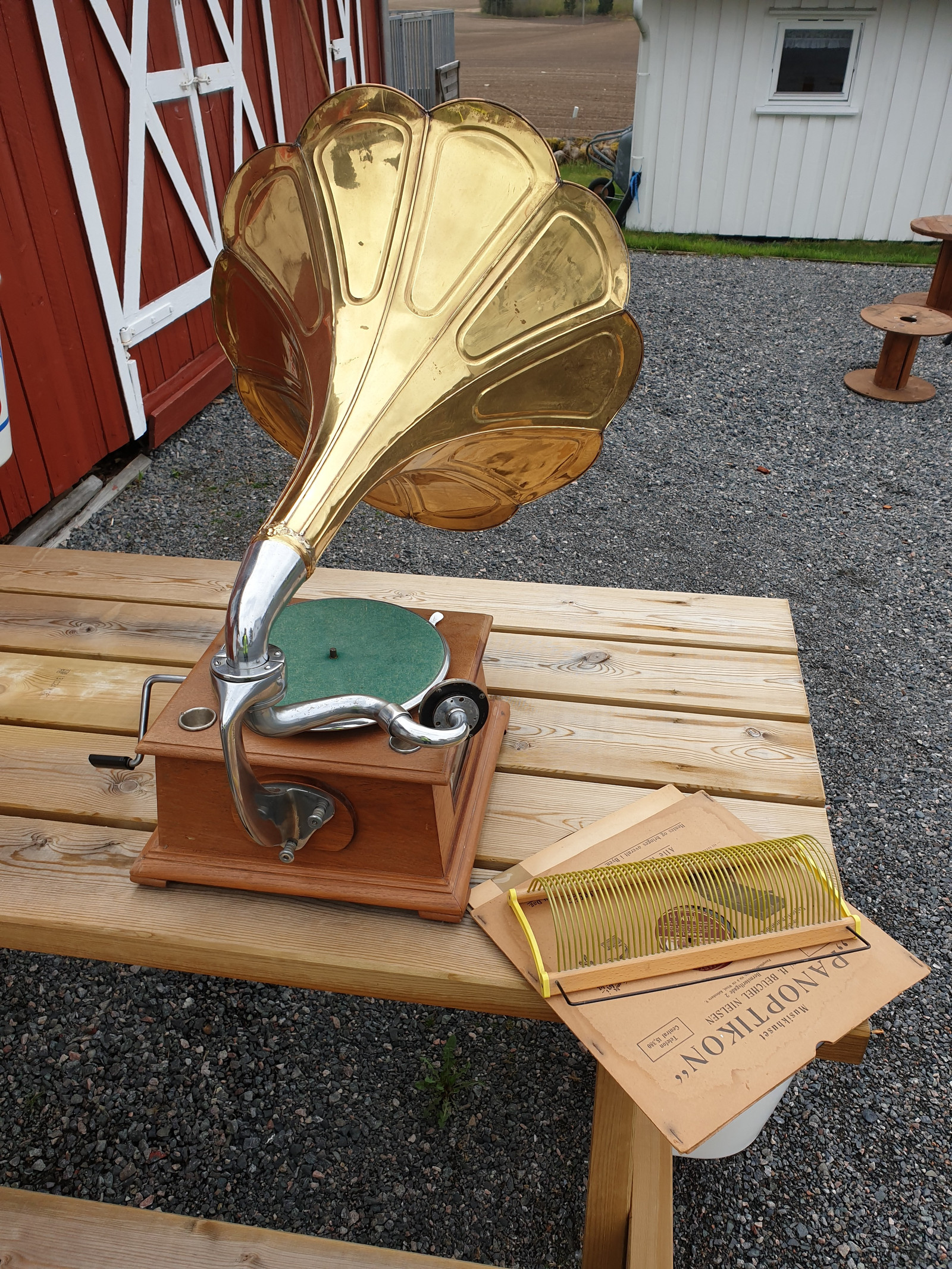

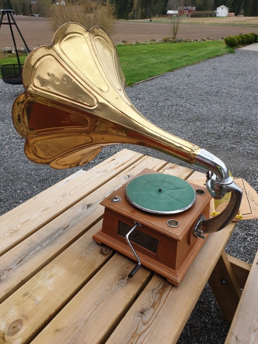

I am adding another horn gramophone. What is this really? Do they make repros that are this sophisticated?

Re: Horn gramophones to identify and discuss
It looks similar to the Crown gramophone discussed in this thread :
