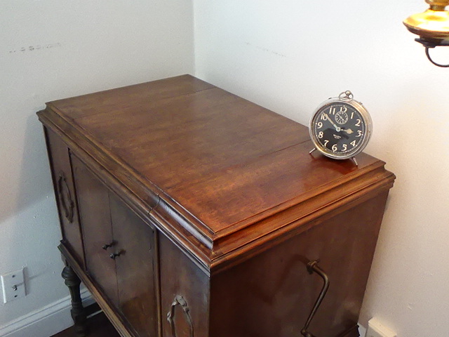

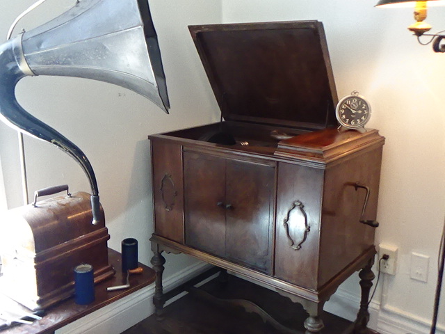

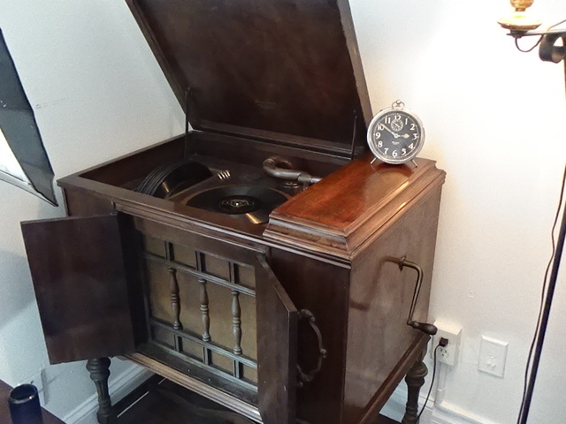

Final update on the Panatrope 15-8.
This turned out wonderfully. It's a little too much phonograph for a tiny single-room apartment but it is a wonderful machine.

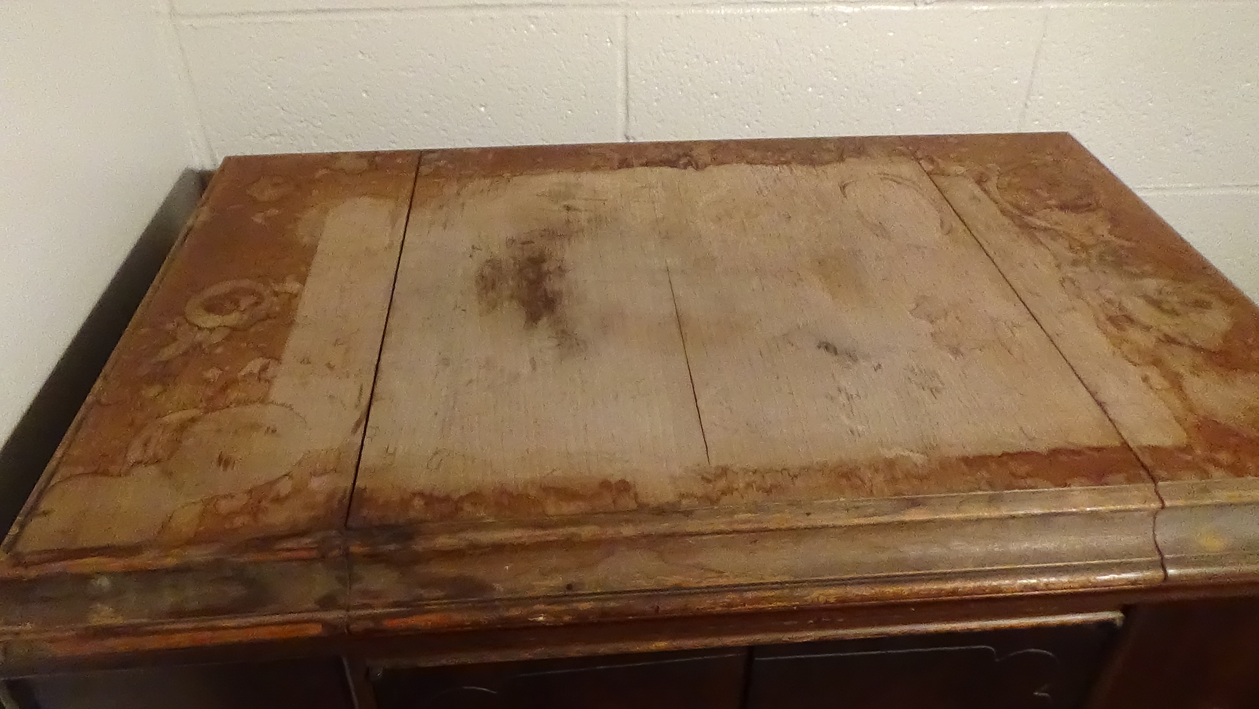

It certainly looks better than this--
Looks aren't everything but it has plenty of performance to back up its good looks. It sounds lovely with the Wyatt Markus-built reproducer and the big spruce horn--the motor is one of those classic smooth-running Brunswick double-springs. The Panatrope reproducer has lots of compliance with a ball bearing needle-bar (which was why I can't rebuild it) so I can play anything from 1900 to 1945 on this without any problems.
It will never be "perfect," but it's here & it's always ready to crank up & play a record.
So for me it is "just right."
Great thanks to Jerry Van who helped me out a great deal with a brass bodied Panatrope reproducer which ended up becoming the core of the present reproducer installed, Wyatt Markus who helped rebuild said reproducer by adding the original diaphragm & a new needle bar, David Zavracky who is very into Panatropes, Martin (Mormon S) whose wonderful builds are always an inspiration to fix stuff up, and the whole Talking Machine Forum. This is the first walnut phonograph in my collection and fills the niche for a high-quality late 1920s acoustic floor model.
Happy collecting!
Charles
