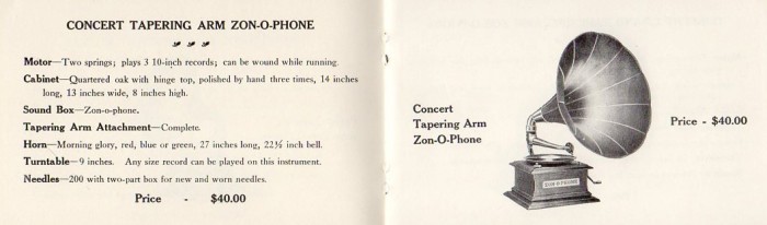

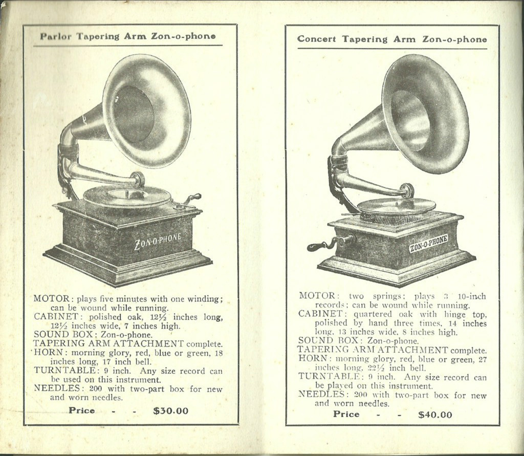

Maybe the catalog pictures below will help deciding what model that is? Sorry, don't have a pic of the later Home model.
Andreas

Yes it does. Mine would be the Parlor model!

The Zono Concert shown above still uses the metal motor board. David's machine is of later design. Here's a page from a later Zonophone catalog (no earlier than 1907) showing the later Zonophone Concert.

No, the Parlor has only a single mainspring, and lacks the chamfered cabinet corners. Yours is the Concert.dzavracky wrote: Mon Dec 20, 2021 12:15 pm Yes it does. Mine would be the Parlor model!

Does the decal not look a little different in the ad though?

The catalog illustrations all show those odd-looking decals on the fronts of the cabinets. I suspect it was artistic license to make them show up on the wooden cabinets in the catalog.
