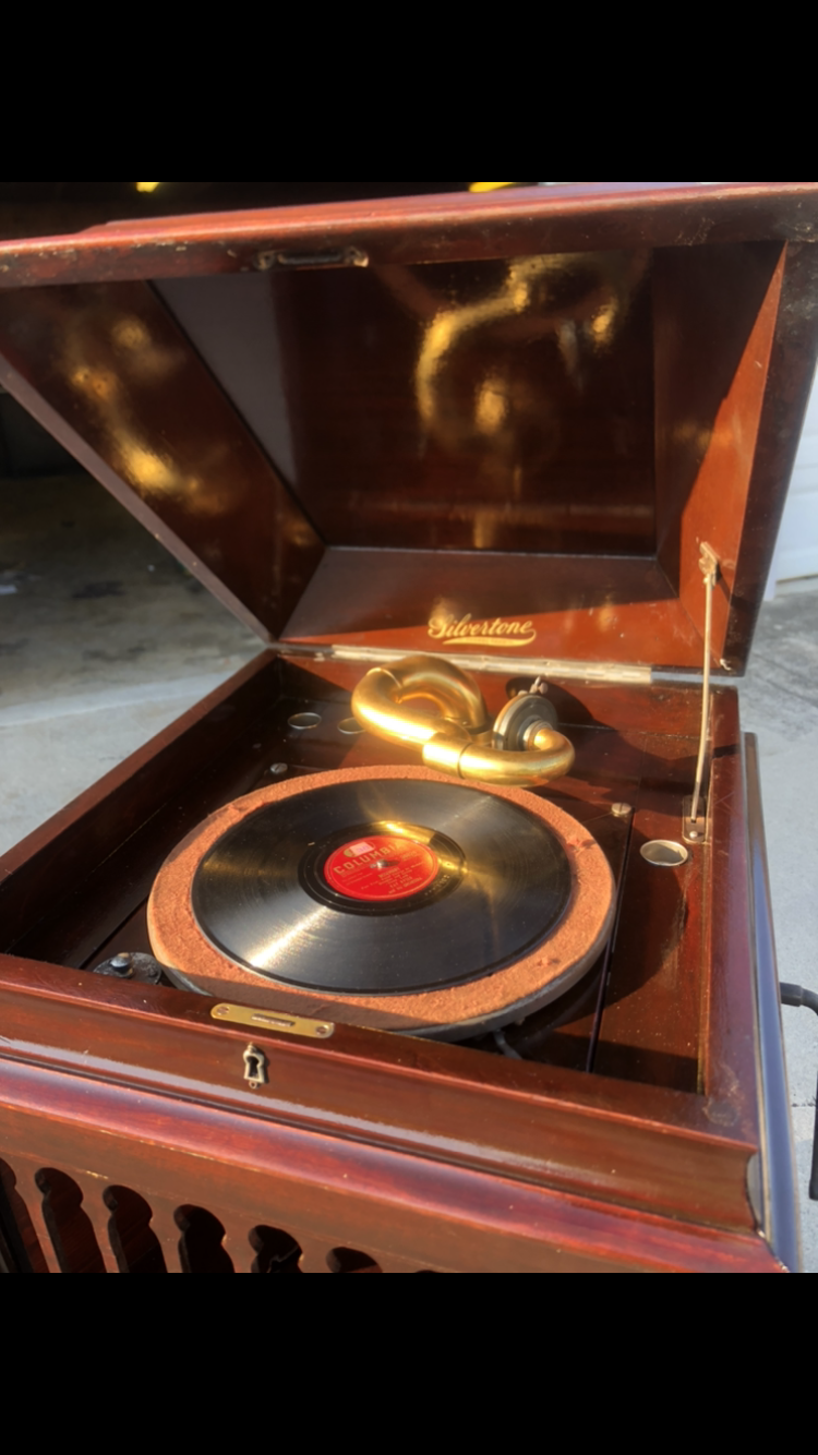

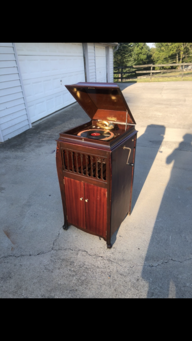

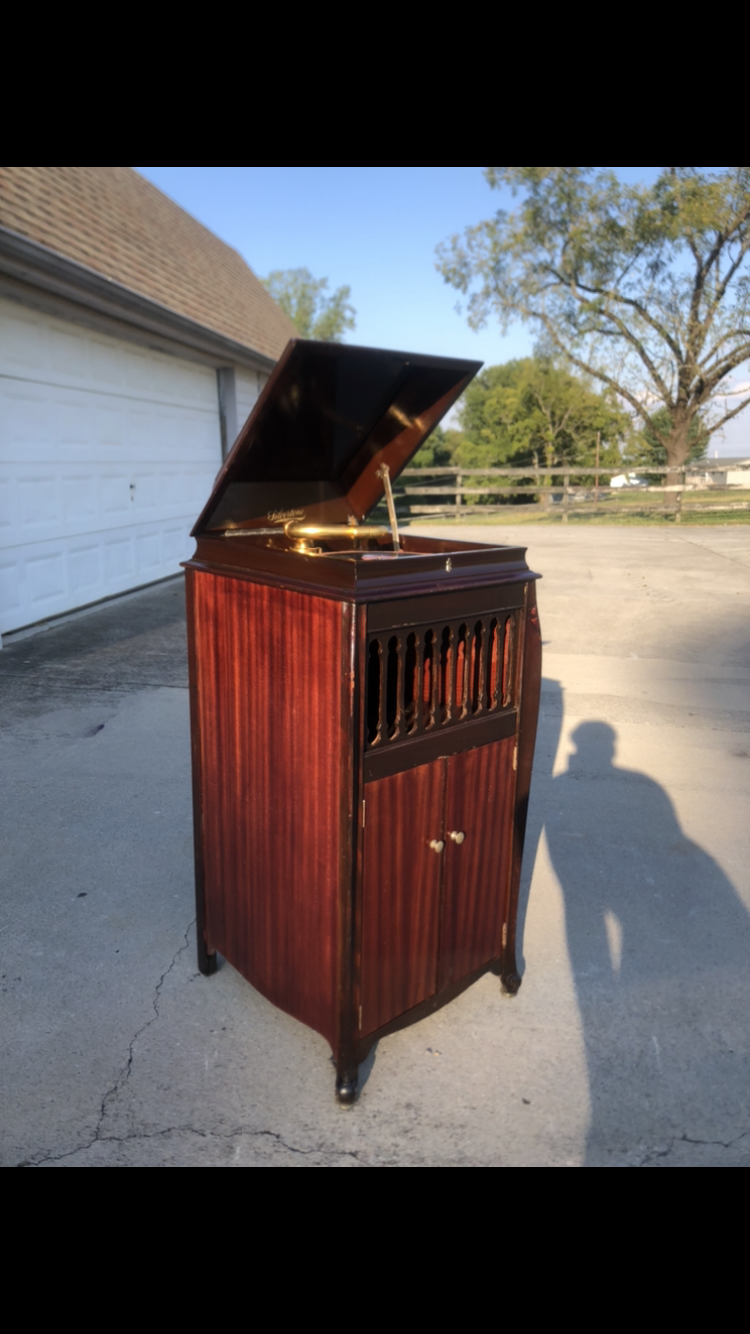

Finished up this project today. I cannot wait to have it gone :lol: :roll:
I tried my best to get the all the colors to match… but didn’t have much luck. It’s not even really noticeable when it’s under normal lighting. He’s happy with it so… so I am too.

Honestly, I think it looks really good in it's own unique way. Already with the reproducer/tonearm (IMO the best available at all) it's a bit of an oddball, but the two-tone is pretty neat.

Looking back… I should’ve just stripped everything down to the bare wood… but I was successful in saving the original finish/stain. I should’ve used a brown mahogany dye instead of red :cry: it definitely would’ve matched the original color better. But it’s weird that the lid is the same color as the new veneer… which is what I was basing my color off of.
But from what I started with and what I ended with I’m not too upset. The veneer was a touch challenge for me… I’d never done veneer before :?

The new finish may well darken with time, too, coming to be a better match. In all events, well done!
