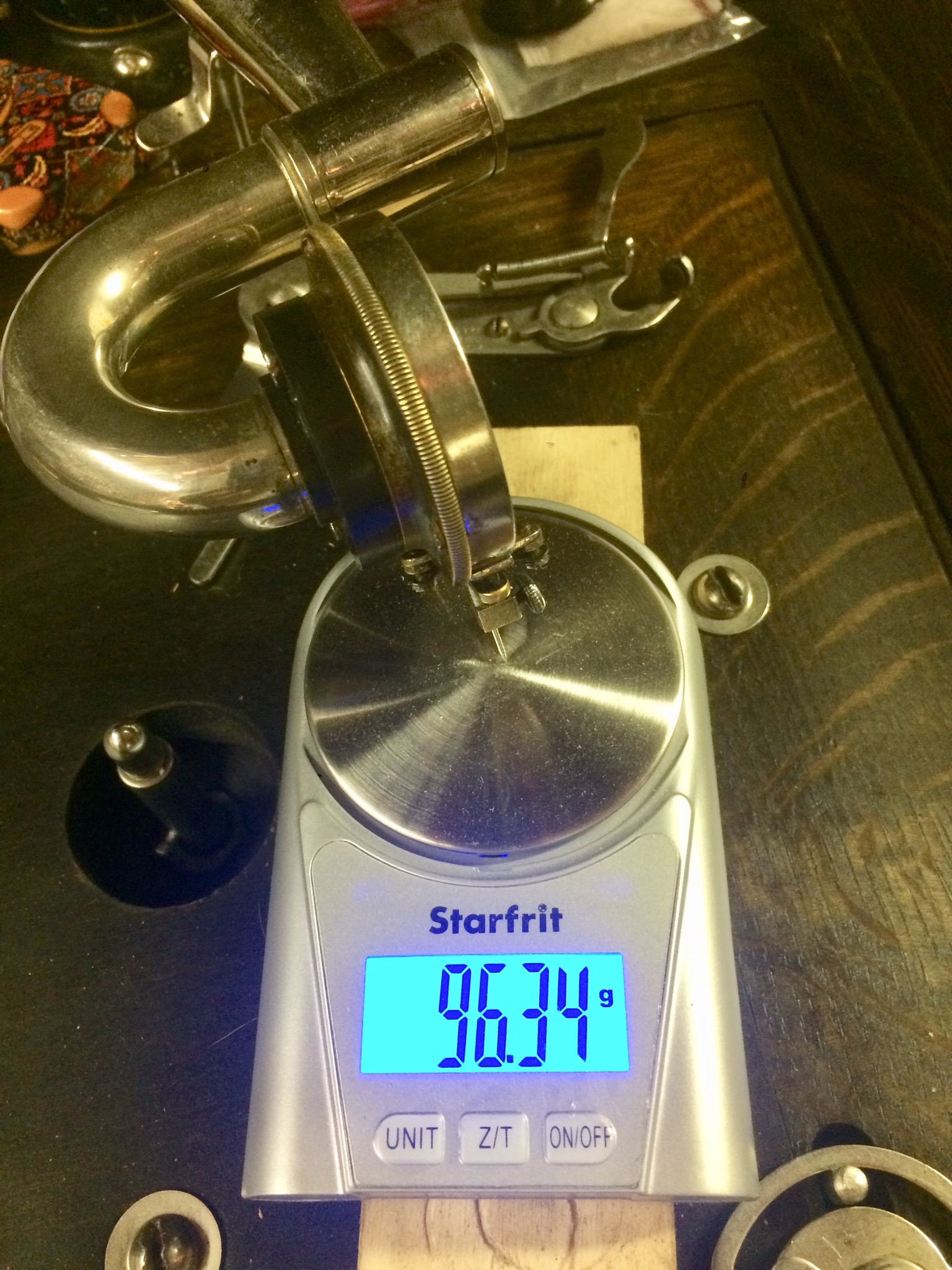

You're off by quite a bit since the Canadian 1 cent coin weighs about 2.35 gm and the American equivalent is about 2.5 gm.
The easiest way to estimate tracking weight is just to weigh the reproducer, so just for grins, I did just that.
The Exhibition, No. 2, and Orthophonic each weigh roughly 150 gm, give or take 5 gm or so. That's over 5 ounces.
I think there's another thread on here that further discusses tracking weight, including the Diamond Disc, which IIRC tracks around 165 gm.

Thanks.52089 wrote: Fri Jan 07, 2022 8:09 pm You're off by quite a bit since the Canadian 1 cent coin weighs about 2.35 gm and the American equivalent is about 2.5 gm.
Don't know what I was thinking (or not).
The AR balance scale instructions said that an American penny was about 2.5 grams.
Average the pennies at 2.45 grams x 50 and we get 122.5 grams (an estimation probably still way off).

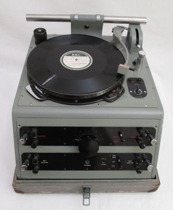

With regards to what sort of turntables might have been used in the 1937/38 BBC study of needle use, the turntable in the attached picture is claimed to be a BBC turntable from the late 1930s.

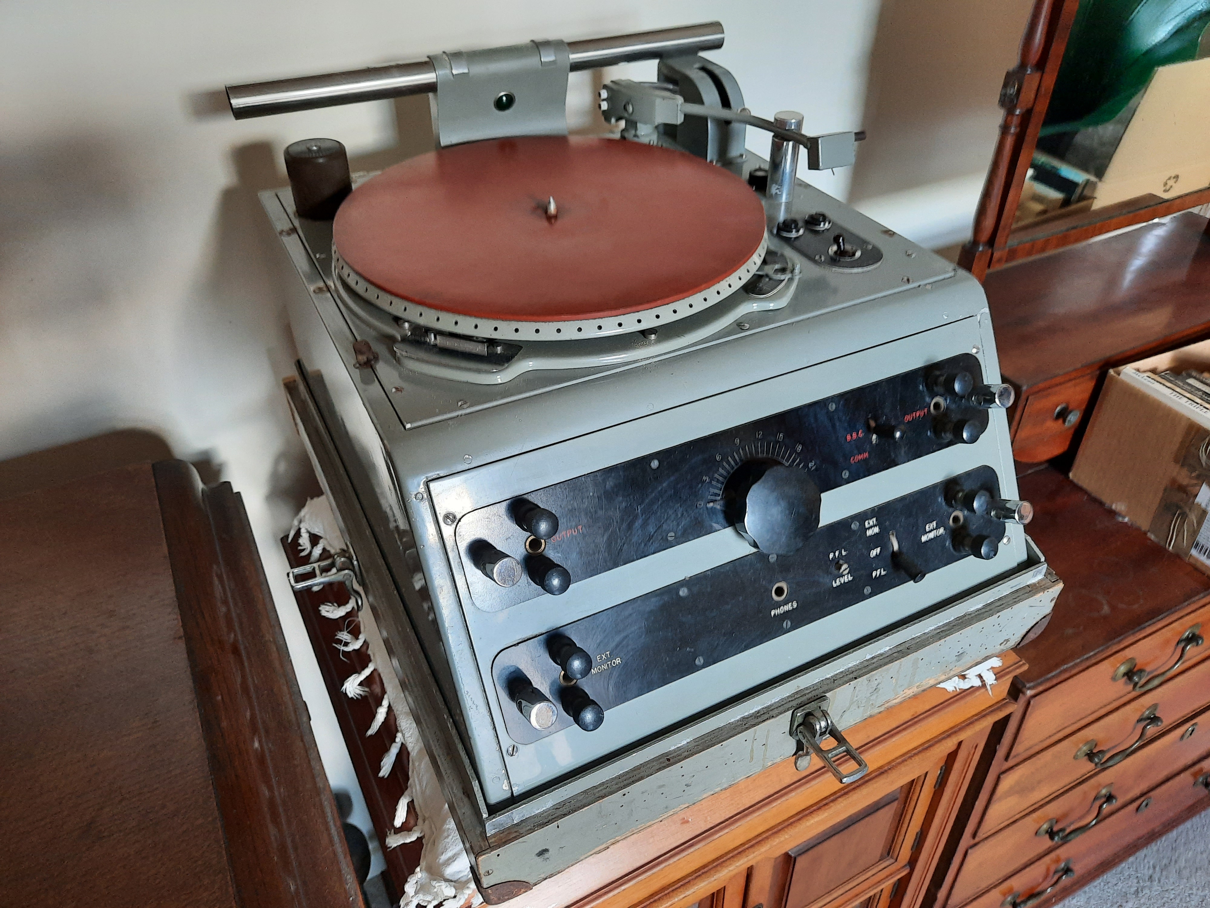

Wow, what a coincidence to see that photo - I've just dug mine out (soon to be sold to a fellow collector):Lah Ca wrote: Sat Jan 15, 2022 6:04 pm With regards to what sort of turntables might have been used in the 1937/38 BBC study of needle use, the turntable in the attached picture is claimed to be a BBC turntable from the late 1930s.

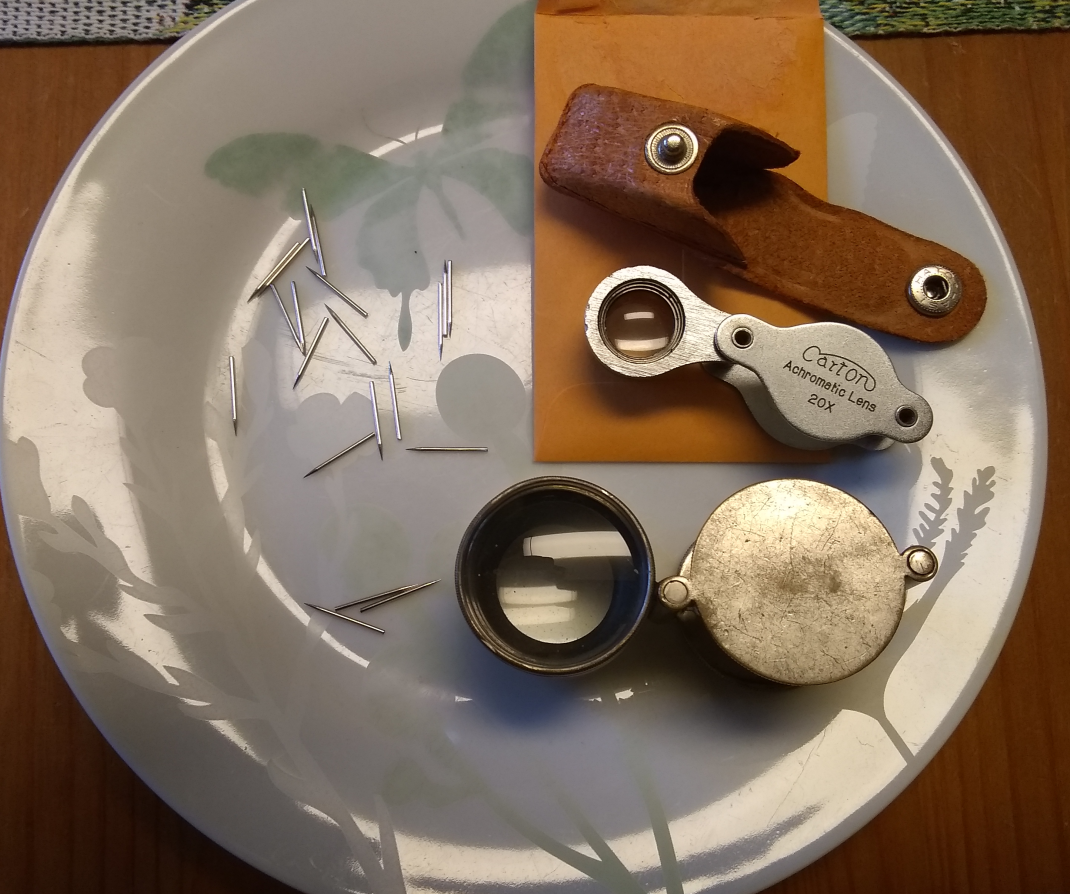

The Cull!
I just opened a new pack of soft tone needles and went through them, examining the tips with hand lenses.
The large hand lens is ancient (something I found in my grandfather's effects) and is of relatively low power, and being so, it is easy to use - easy to maintain focus. I use it first. Good needle tips are quite obvious.
I use the smaller 20 power lens to examine suspect tips more closely. It is harder to use.
Anyway, out of a package of 100 new needles (I did not actually count them), 20 are defective, or so I would judge them to be, anyway. Some have tips that look alarmingly like microscopic garden implements - they might be OK if I could be certain that it was not the blade of the hoe that was facing downwards ready to break up the soil of the shellac. Mostly the problems seem to be with malformed nickle plating, but with some it appears to be the needles themselves.
The rejects lie on the left side of the plate.
Quality control?
Quality control?

I have found needles with hooked ends also. The condition has been covered in past forum threads. I "inspect" each needle by running my finger along the shank, towards the tip, and feeling for any "snag" against my fingertip, caused by the notorious hook. Not as good as your loupe inspection, but I have caught a few. Never had one get by, to do actual damage.
My assumption/theory has been that the needles are polished in a tumbler and that every so often, a needle tip hits another needle, or the tumbler shell, in just the right way to bend the point. Chances of that type of collision may be slim, but thousands of needles, tumbling for how long.... I dunno
