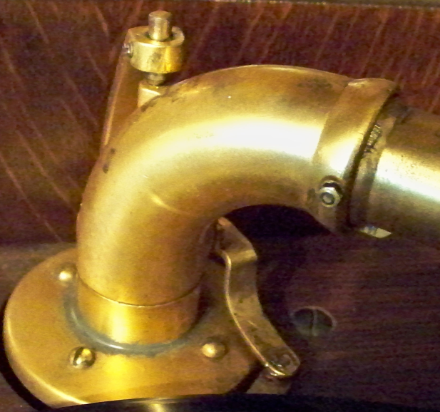

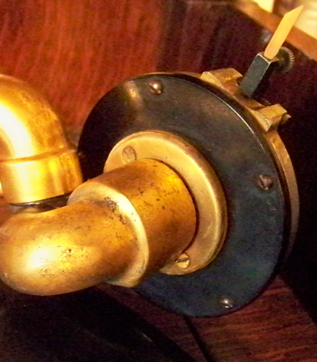

The Arm
I suppose I should document the arm. I didn't take pictures when I had if off the machine because I was working with oil and grease, so I will have describe what is there.
The base of the tonearm is fixed to the motor board. It forms the convex ball part of a loose ball and socket/cup joint with the arm. The cup at the base of the tonearm sits loosely on the ball. The tonearm is held in position by an arm that comes up from the base. There is an adjustable pointed pin that goes down into receptacle socket on top of the tonearm. The pin is held in place by a set screw. (If you are ever working on one of these machines, be sure to remove the pin and set it aside even if it seems to be stuck in place. It can easily fall into the opening of the horn where it could be very difficult to recover if not caught by the grid in the horn opening.) The arm moves laterally on the ball and pin. With the pin in place very firmly there is still a bit of vertical movement of the arm on the ball. By design or by wear? Who knows? It was quite loose with a lot of vertical travel when I took it apart. I lubricated the ball and cup and pin and socket with a good synthetic grease. I moves laterally effortlessly now, not that it was stiff before. I experimented with pin settings, as tight as I could get it to as loose as it was when I took it apart. Neither setting made any difference to the ease of horizontal movement, but I think it sounds better with it fairly loose with a bit more vertical play.
Along the arm, up from the base and over the curve, there is another loose ball and cup joint held together by a laterally placed machine screw which forms the axis for most of the arm's horizontal movement. There is a flange which limits downward movement. My arm was quite grubby here and was thus a little stiff. I cleaned it up without dismantling it and lubricated it with the synthetic grease. It moves effortlessly now.
The next point of articulation in the arm is where the lateral portion of the arm bends downward form a joint with the elbow tube that allows the soundbox/reproducer to pivot laterally for playing vertically cut recordings. Bearing in mind Inigo's dire warnings about this joint, I only cleaned it up externally and lubricated it lightly with a good quality oil. There is spring loaded ball in this joint with two ball sockets that indicate and lock the positions for vertical and horizontal play.
The final point of articulation on the arm is where the elbow tube meets the soundbox. The joint allows the soundbox to rotate up and down, up for changing needles, down for play. There is a spring loaded ball and a socket that indicates and locks the play position. I did nothing with this joint either other than give it a drop of oil.

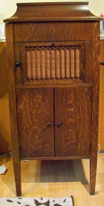

The Finish
Here it is ready for the show room floor.
Gibson guitar polish helped clean the grime of ages off the machine (and inadvertently exposed some long ago and very well done surface repairs on the top), all without stripping finish or stain. It also brought out the richness of the colour, heightening dark and light contrasts, and improved the definition of the figure in the oak.
With the grime gone, the 100-year-old plus varnish was a little rough. I think that the machine did not receive the best of care for a long while and was stored somewhere subject to wide temperature and humidity changes. On one side the finish is more badly checked - perhaps this side was exposed to direct sunlight.
After cleaning, I polished it up with a number of light coats of palm wax which will help preserve the varnish. The wax has brought a bit more showroom gloss to the wood, something closer to A-V's advertised piano finish anyways, It also makes it easier to dust. I will reassess in a few days after the wax has fully hardened and may add another light coat or more.
