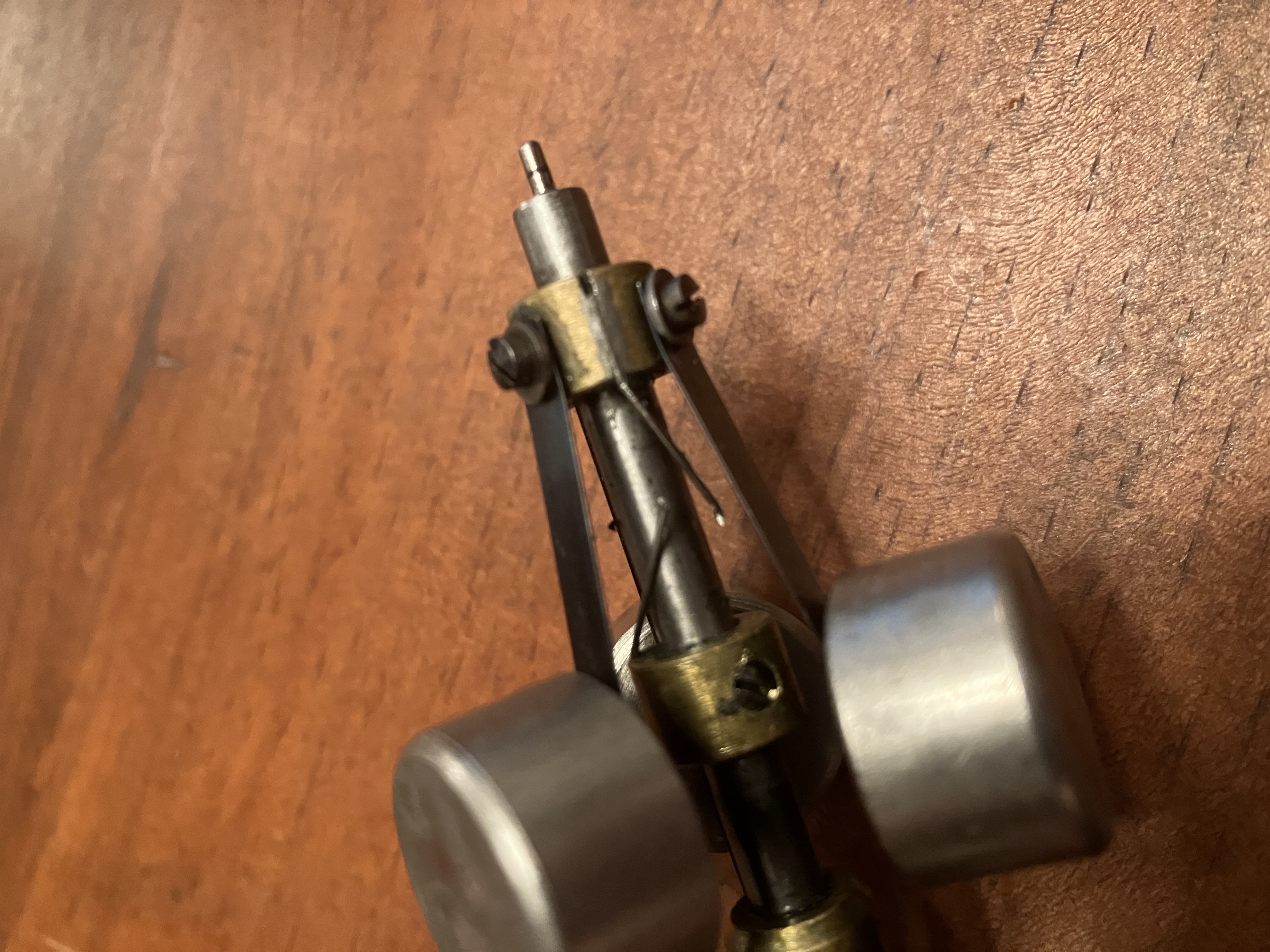

It’s not supposed to be bent? I thought it bent, when I moved the brass ring to the right? Because I was trying to get the brass disc on the left to move closer to the felts, that hang down. I was doing this, because the governor was moving way too fast and caused everything to speed up! I thought the bent spring was supposed to bent, when the collar was moved to the right? Mine came that way when I bought the governor.
No. It's not supposed to be bent.
so I need to buy a new governor then?

Well, I snapped the wire, and I can’t replace it. :cry:

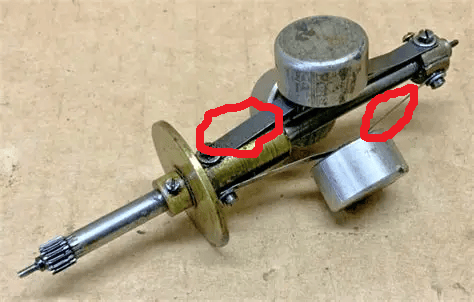

Do you mean these circled parts? I'm just reading this. I think they can be fixed, but I'm not quite sure.

paradroid1793 wrote: Sat Nov 22, 2025 5:59 pm Do you mean these circled parts? I'm just reading this. I think they can be fixed, but I'm not quite sure.
It’s the thin wire between the center brass collar and the brass collar on the end. It’s a tensioner wire, I did not know was supposed to bend?

Well, I received an email from George Vollema saying that his daughter Kris was able to find a replacement spring weight for the one that I snapped off.

Received the part I needed and put on the governor, and now the phonograph is running like it should.
