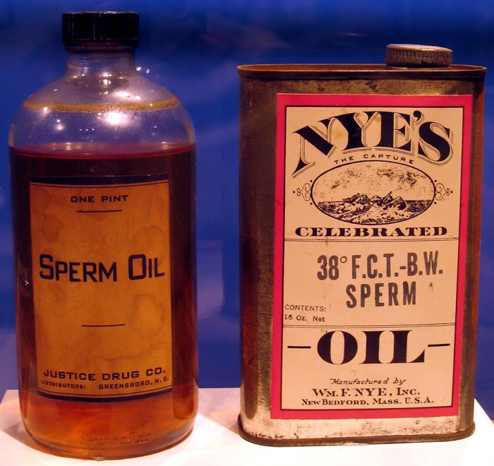

Post by Curt A »
"I'm not turning my talking machine into a Frankenphone lubricant monster! ... Vaseline and graphite ... it's the real deal ... authentic to the period."
So is whale blubber, bear grease, buffalo fat, etc. They all "worked", but stunk and made whales & buffalo endangered... That being said - use whatever makes you happy.
