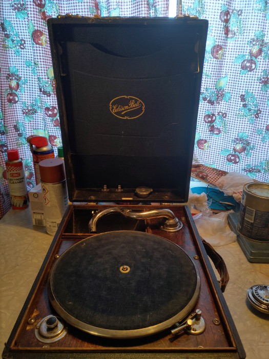

I am adding another portable to this thread. There is no need to identify it as we can see from the photos, but maybe someone want to discuss it, or watch/keep the photos as a reference.
There is another thread with some quite detailed information about Edison Bell portables on the forum, but that machine has a double spring motor, while my machine has a single spring motor: viewtopic.php?f=11&t=49754&hilit=edison+bell+portable

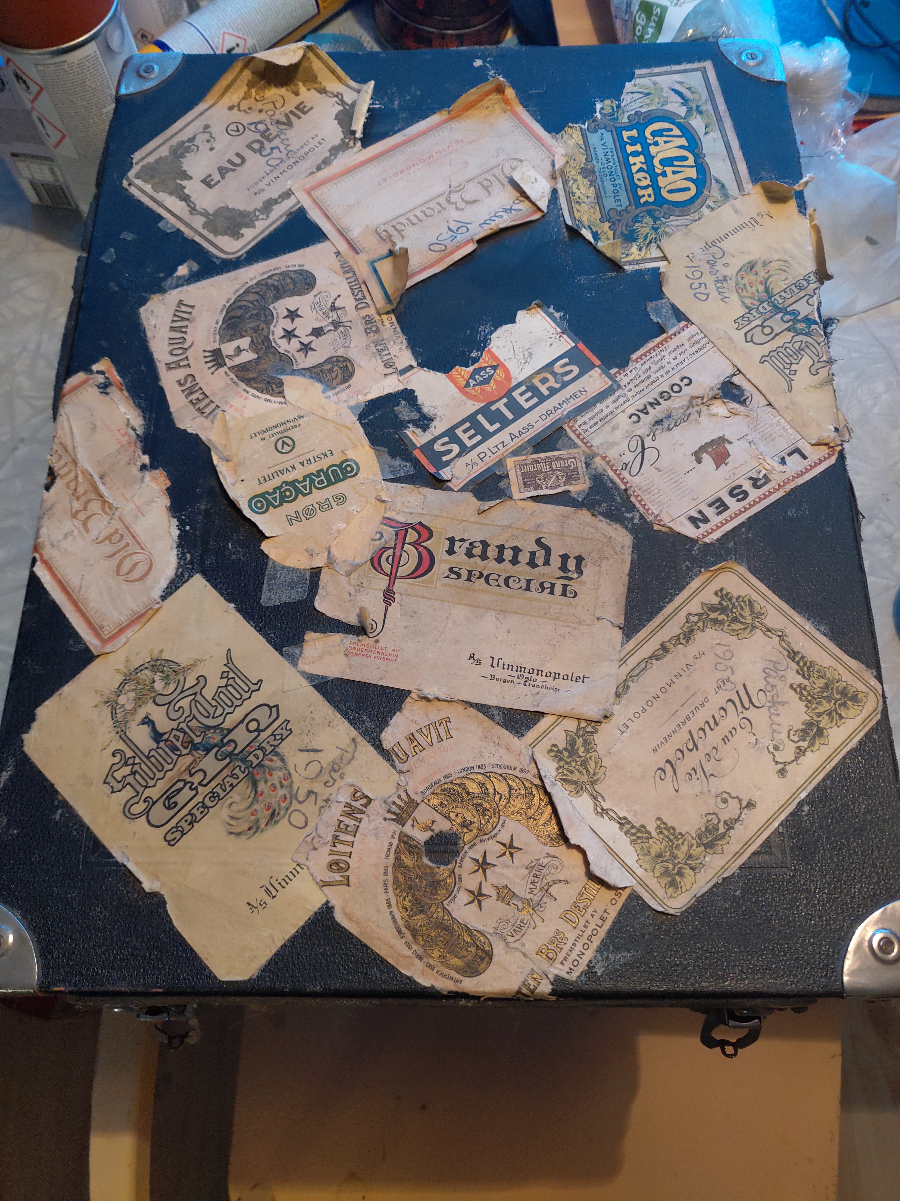

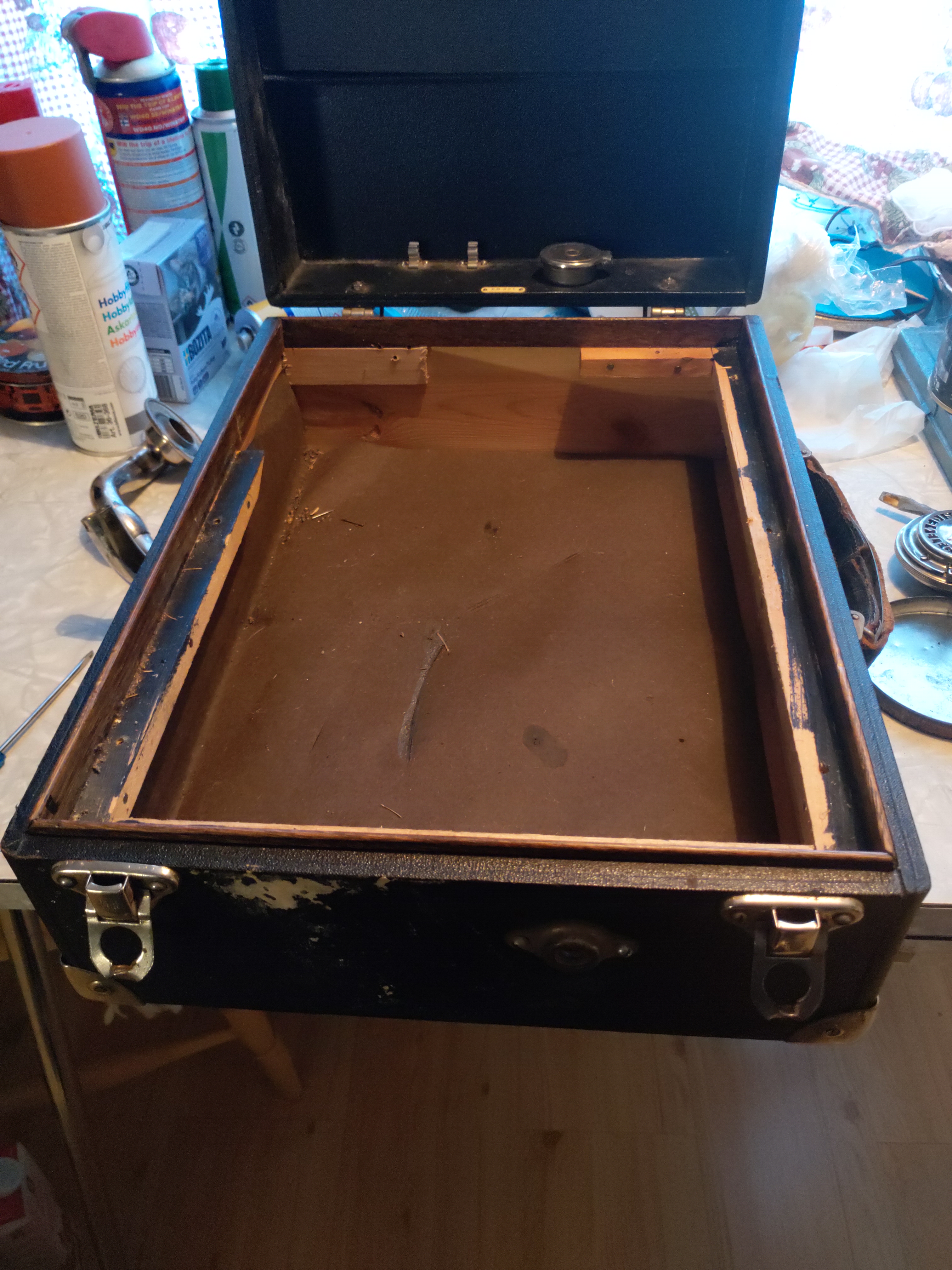

As we can see one of the previous owner also had other interests than music, when looking at the lid cover ;) I don't know how the top lid will look after removing these labels...

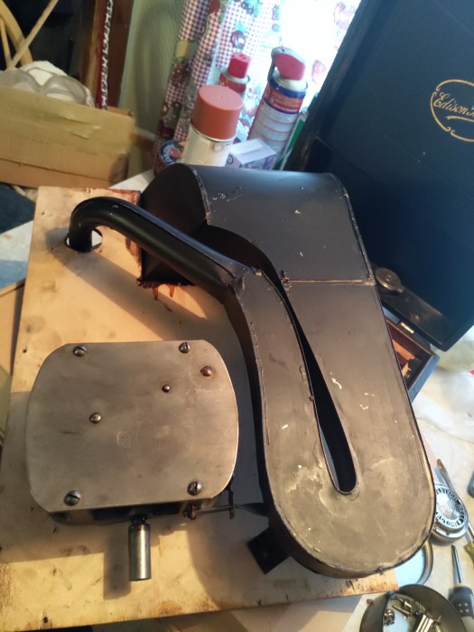

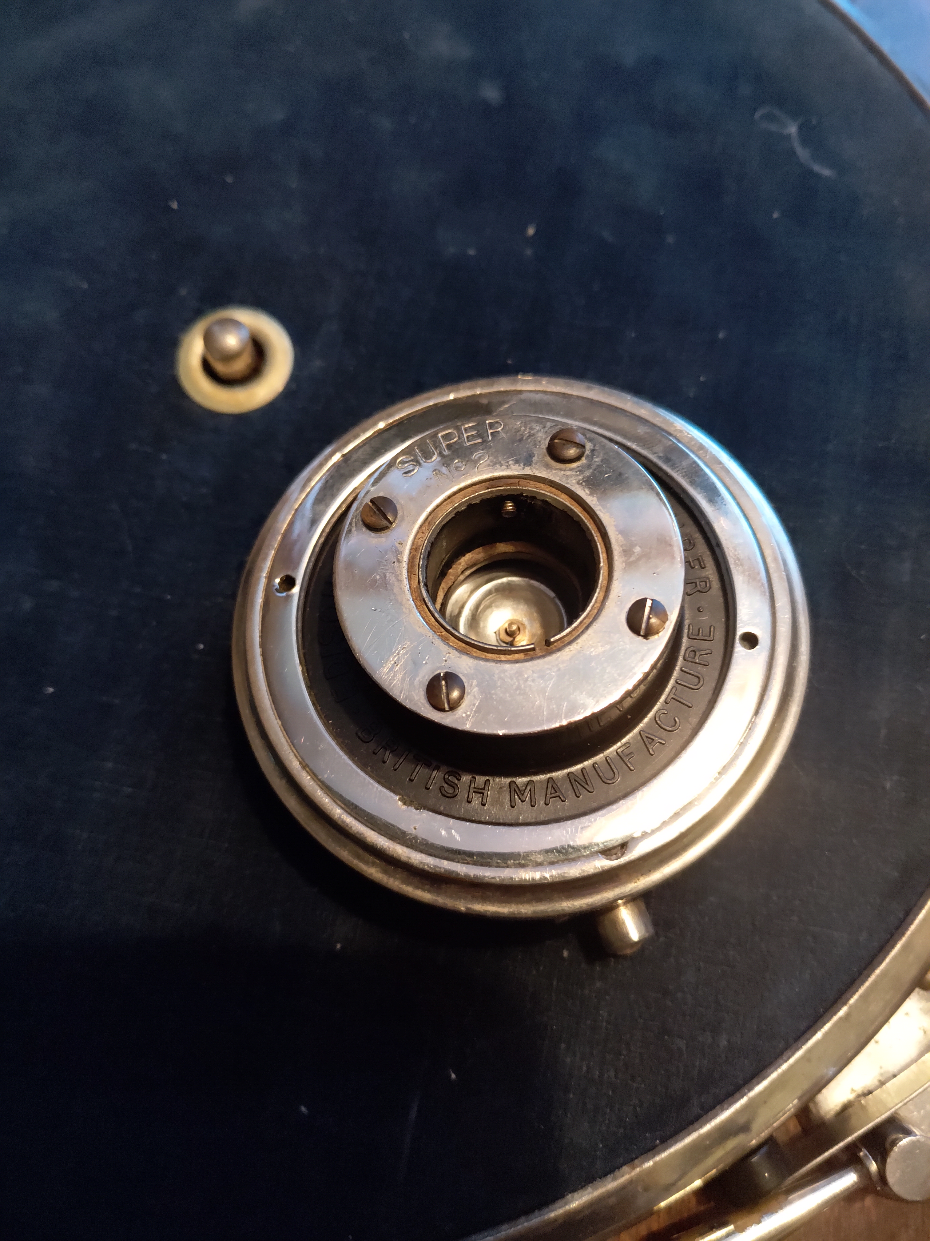

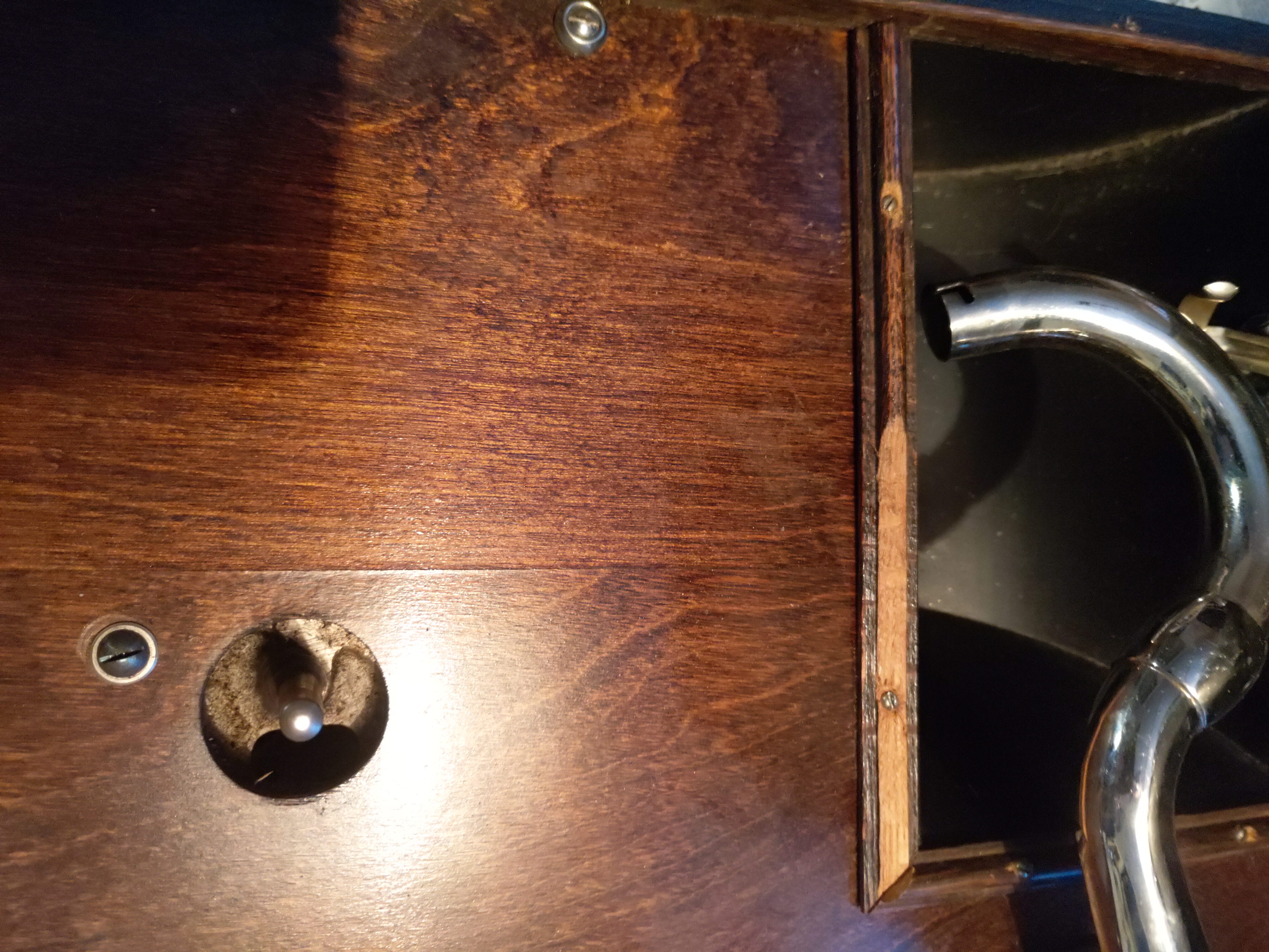

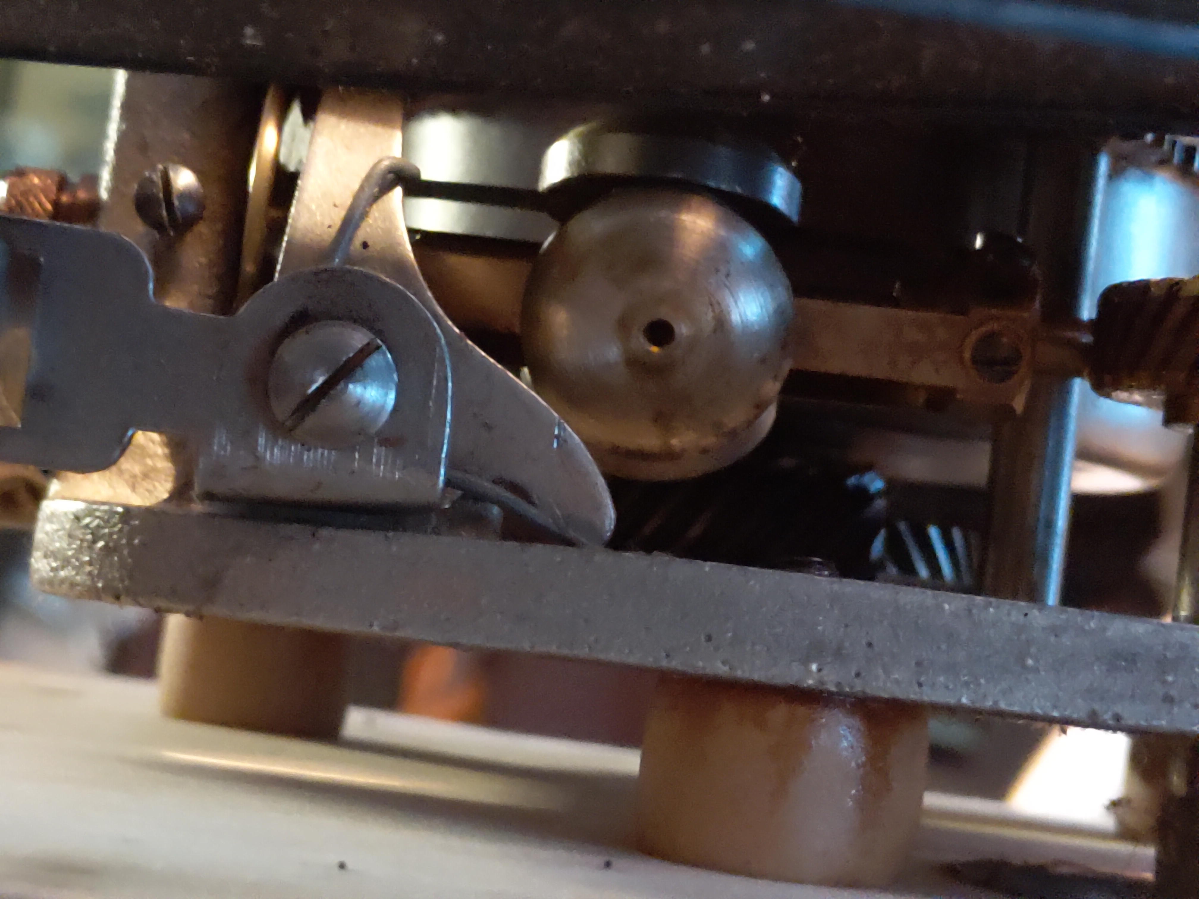

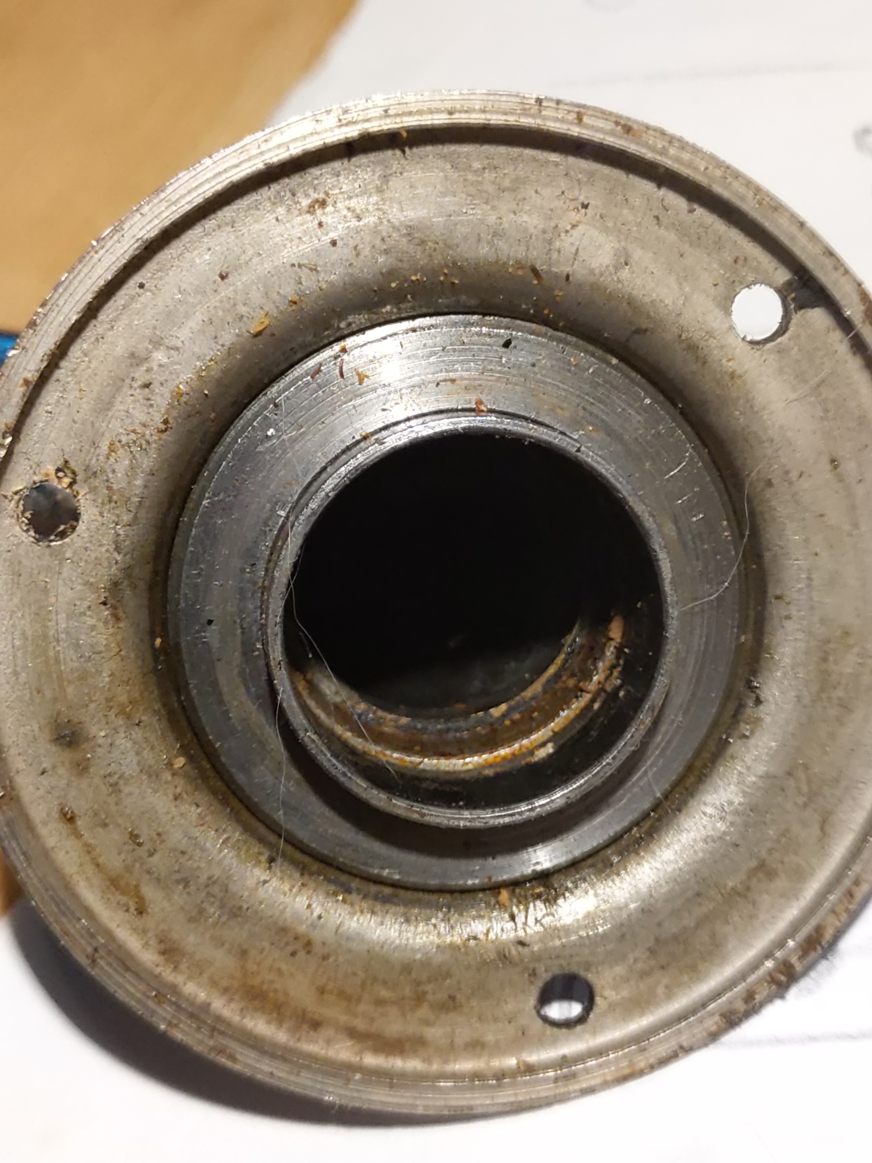

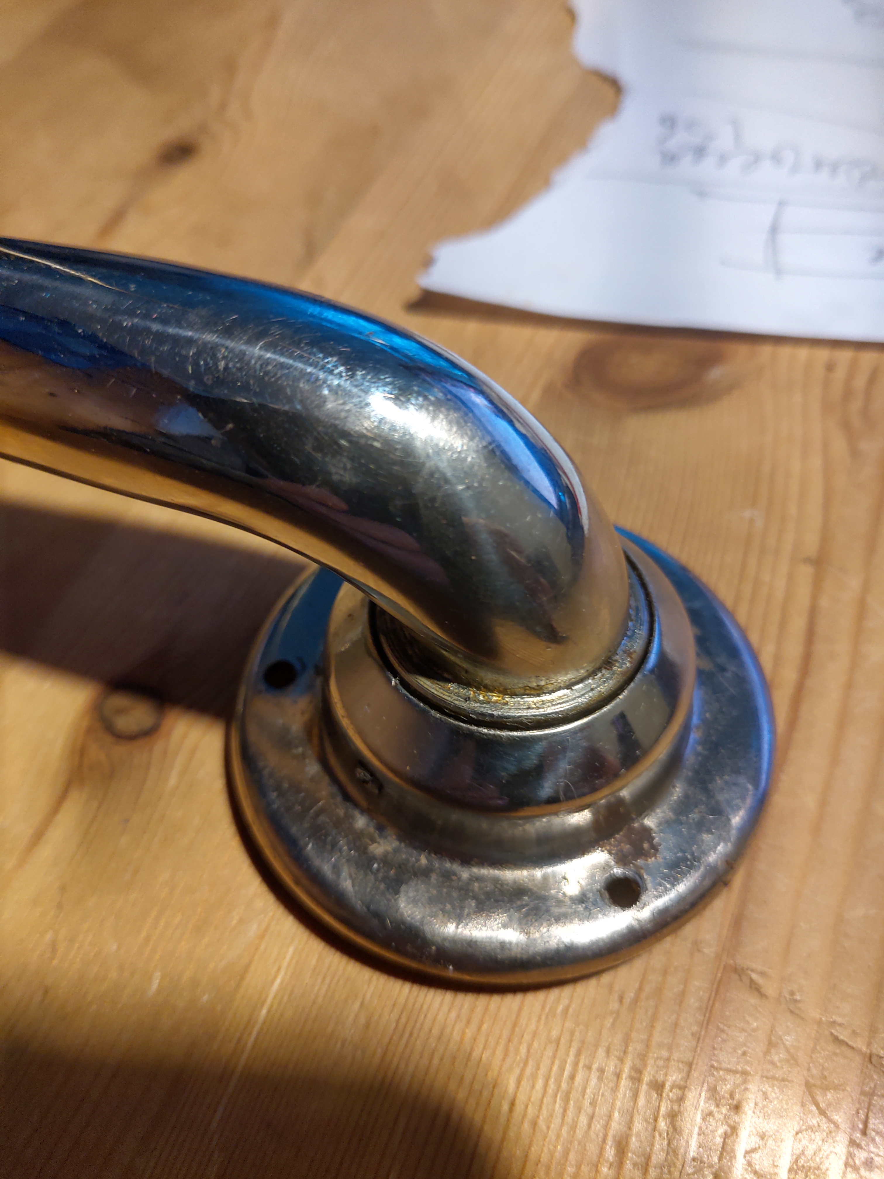

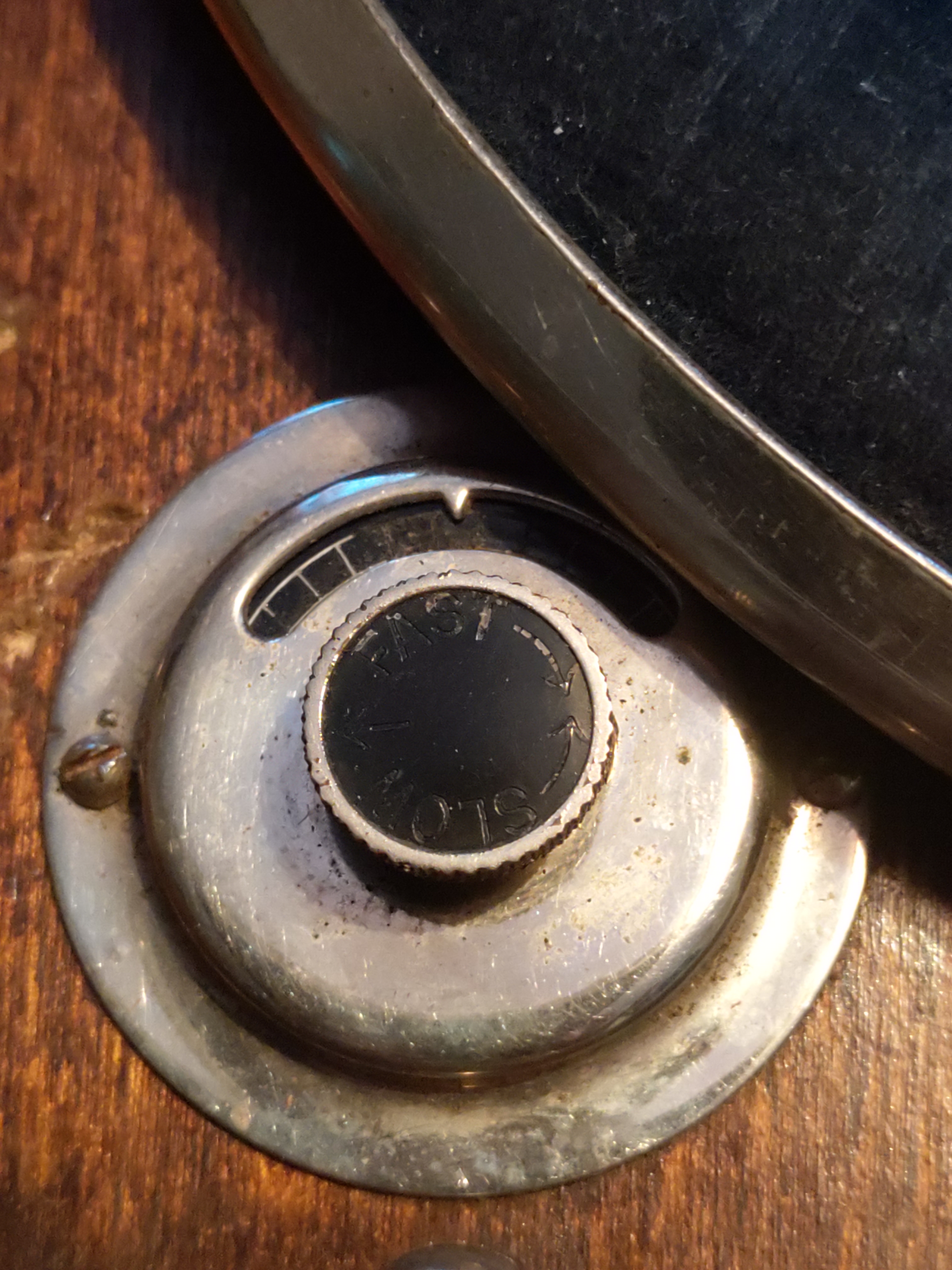

I found a small ball bearing inside the horn, and it must belong in the tone arm, since the tonearm is somewhat loosely fastened to the base. There is a small screw that opens the tonearm/base assembly, I know what awaits me there...a number of small metal balls. Still, I would like to try to get the small ball bearing back in position, if possible.

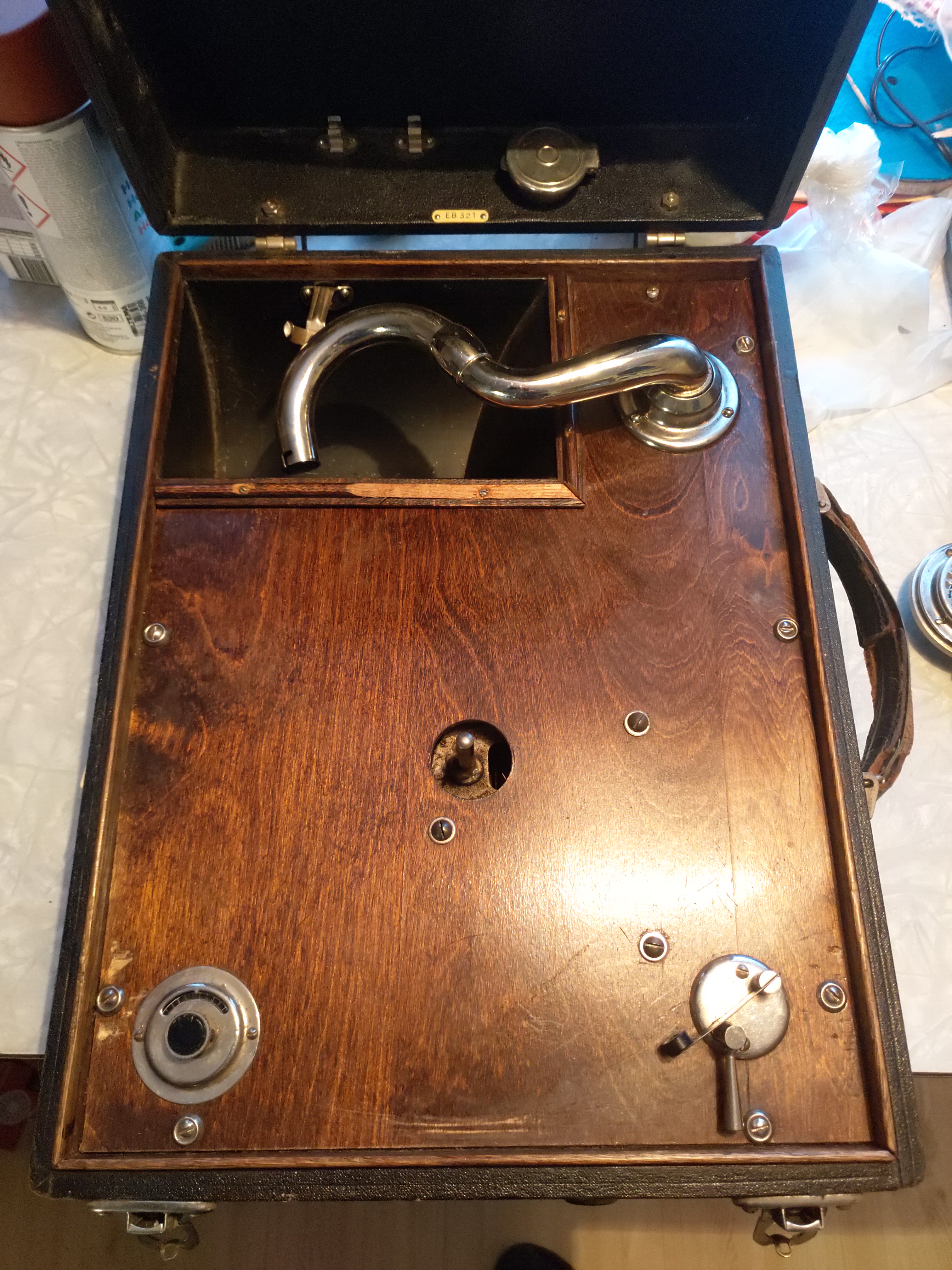

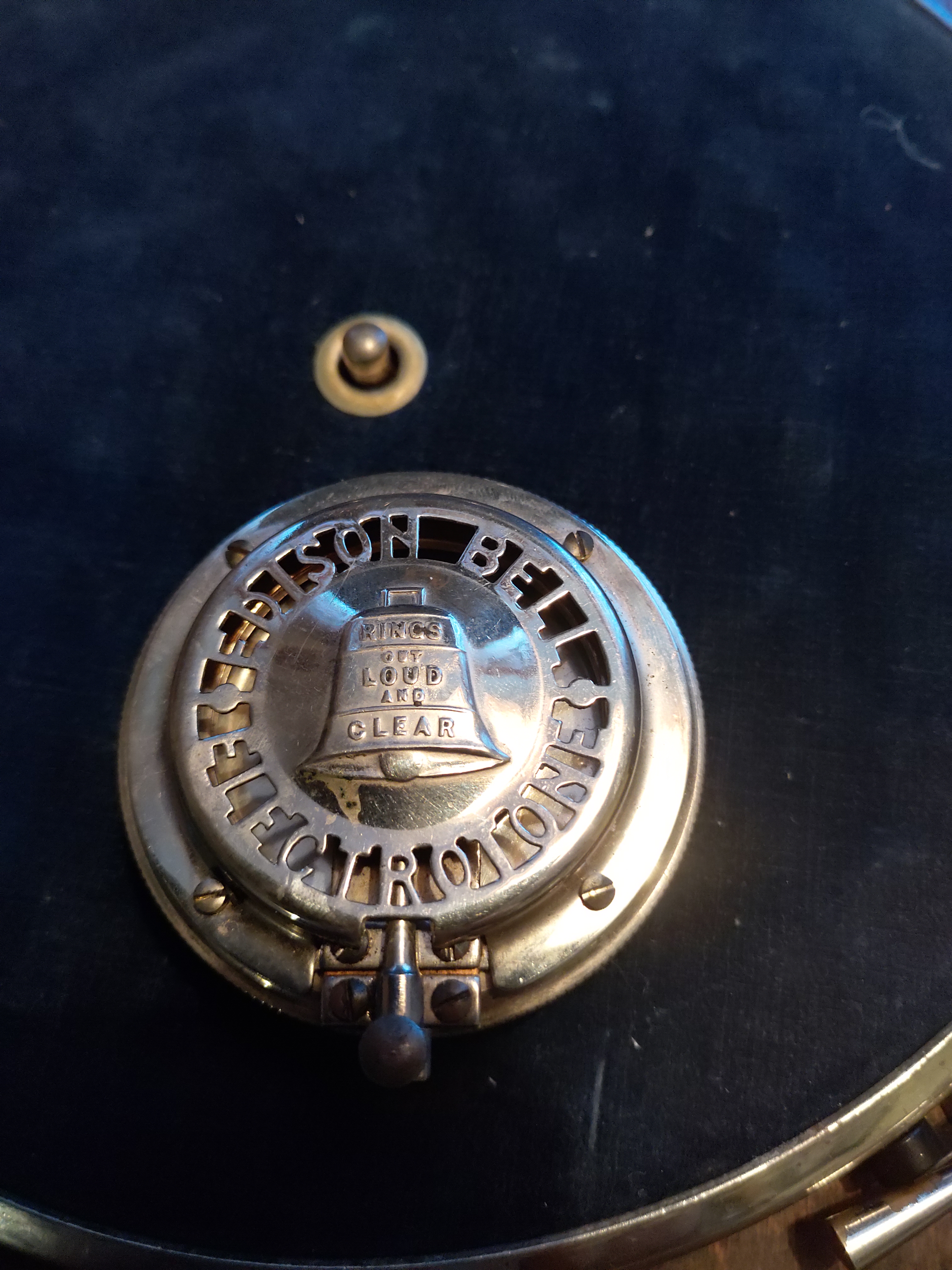

I picked it up for € 10 last evening in Oslo. I was visiting Oslo to see a gramophone friend, and saving this machine was an easy decision, even if my house and rented storage lockers..are full already. It is the first Edison Bell portable I have seen here, and the soundbox alone was worth the buy for me, really.

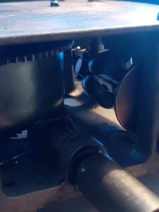

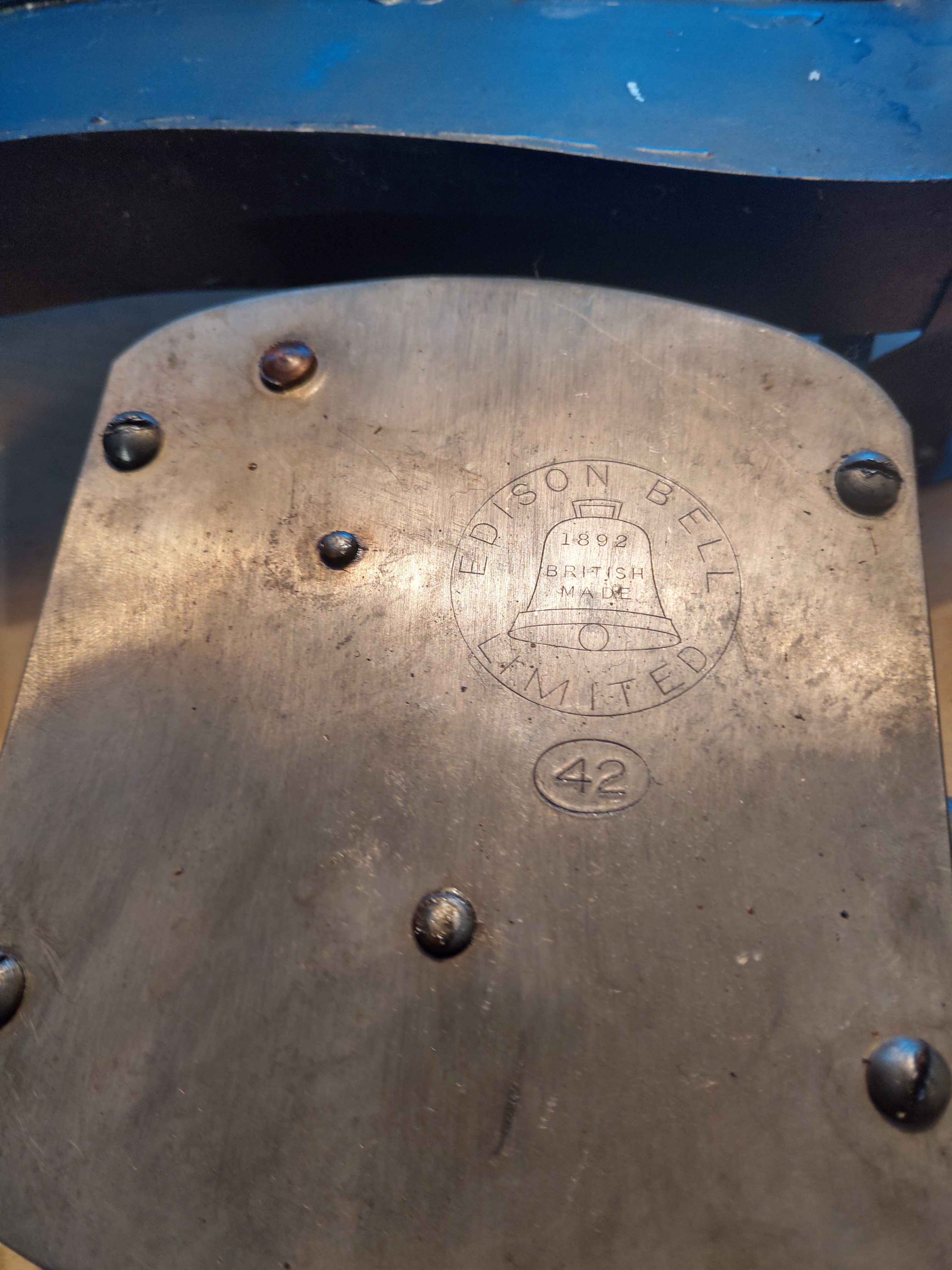

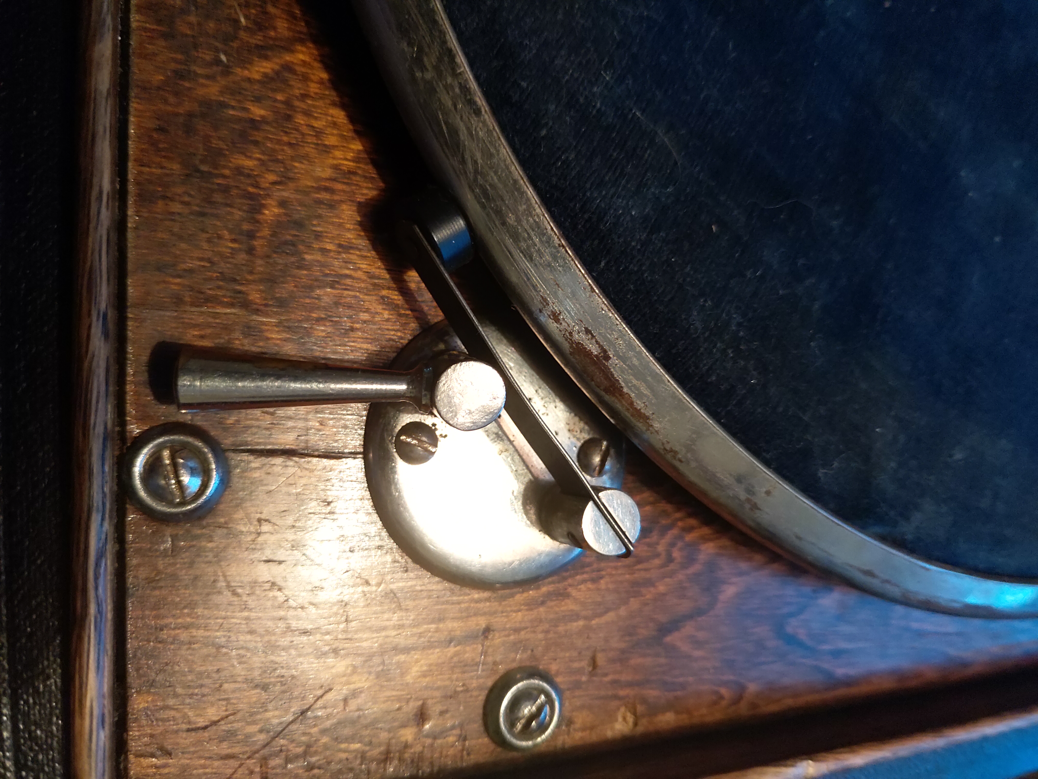

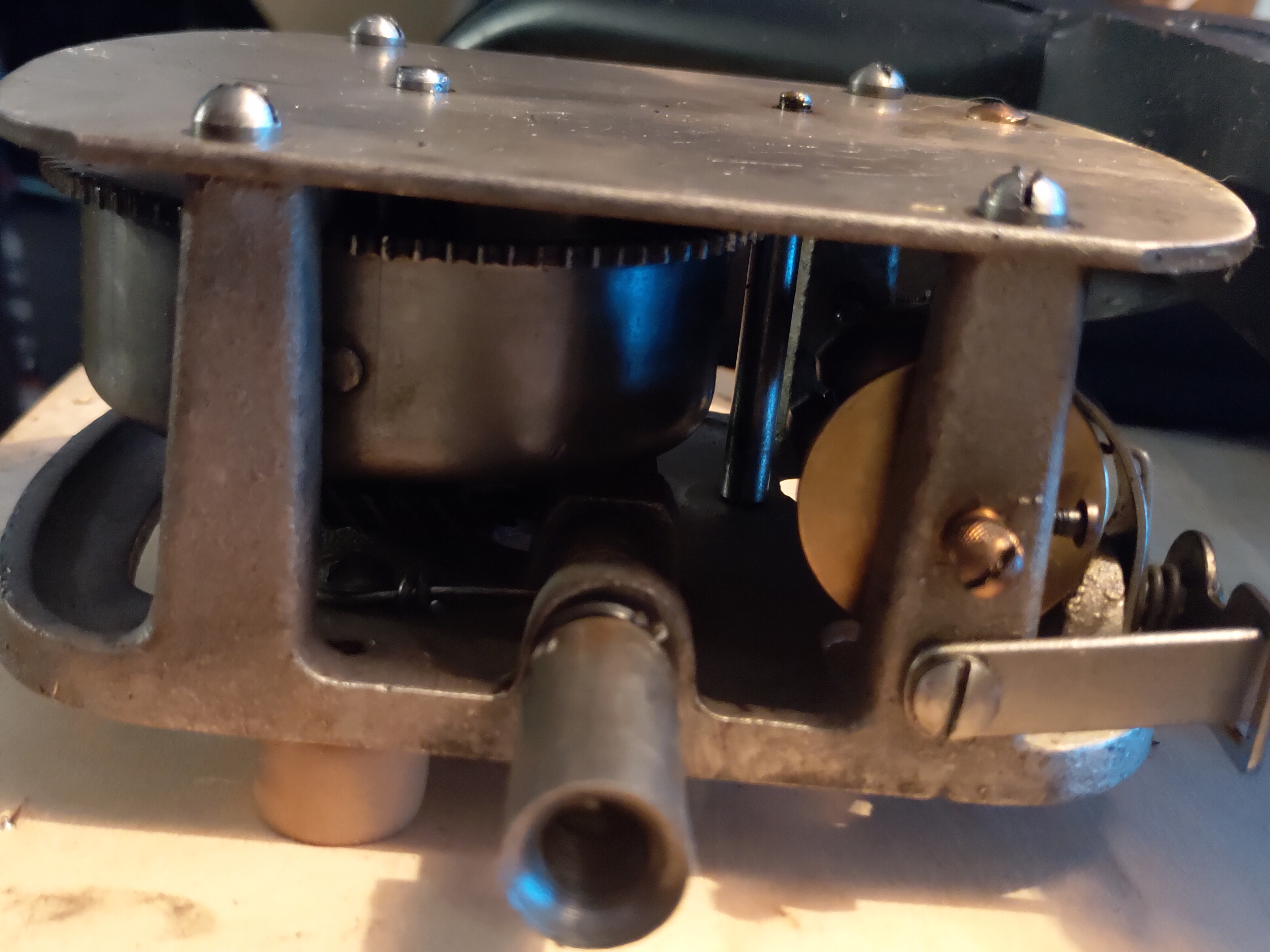

I am adding many photos, for reference. If someone need/want better close up photos of the motor, just tell me, and I will upload more after disassembling the motor. It actually runs, and as we can see it is a front wind motor.

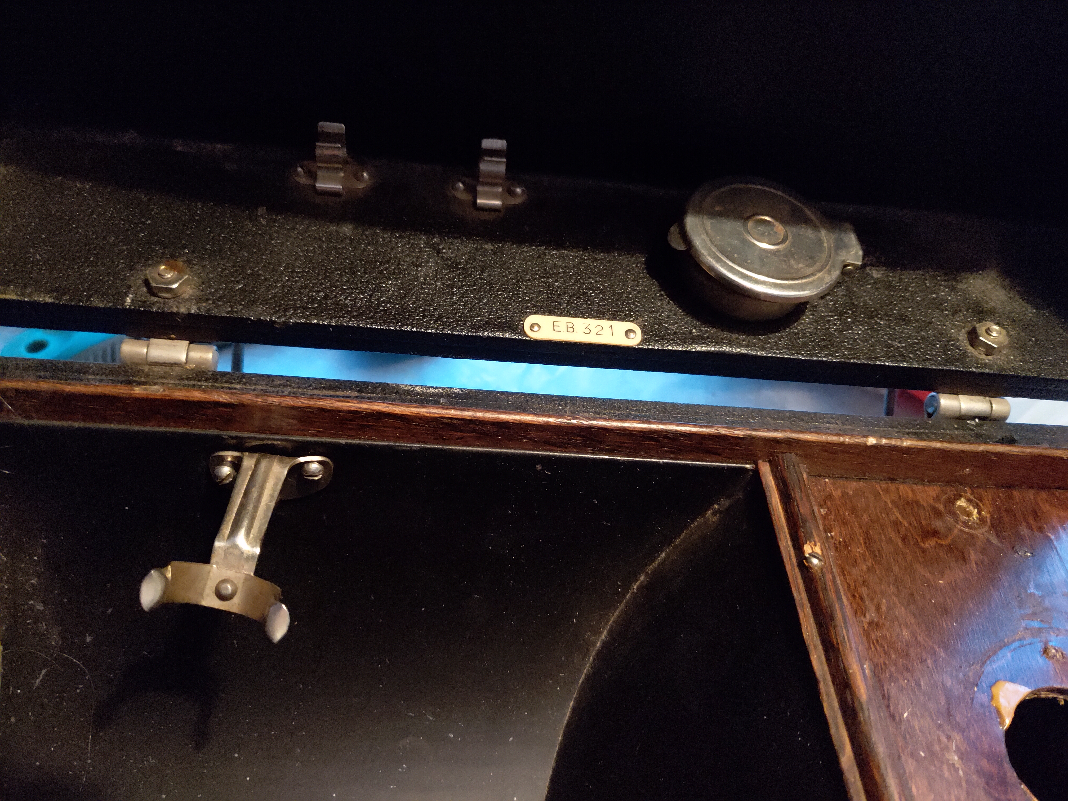

The model number seems to be EB 321, looking at the decal at the bottom of the lid. At first I thought the lid stay was missing, but after looking more closely and checking the lid, we can actually see there are not supposed to be an internal lid stay, the external hinges at the bottom of the lid also works as springs and are holding the lid when it is all open.

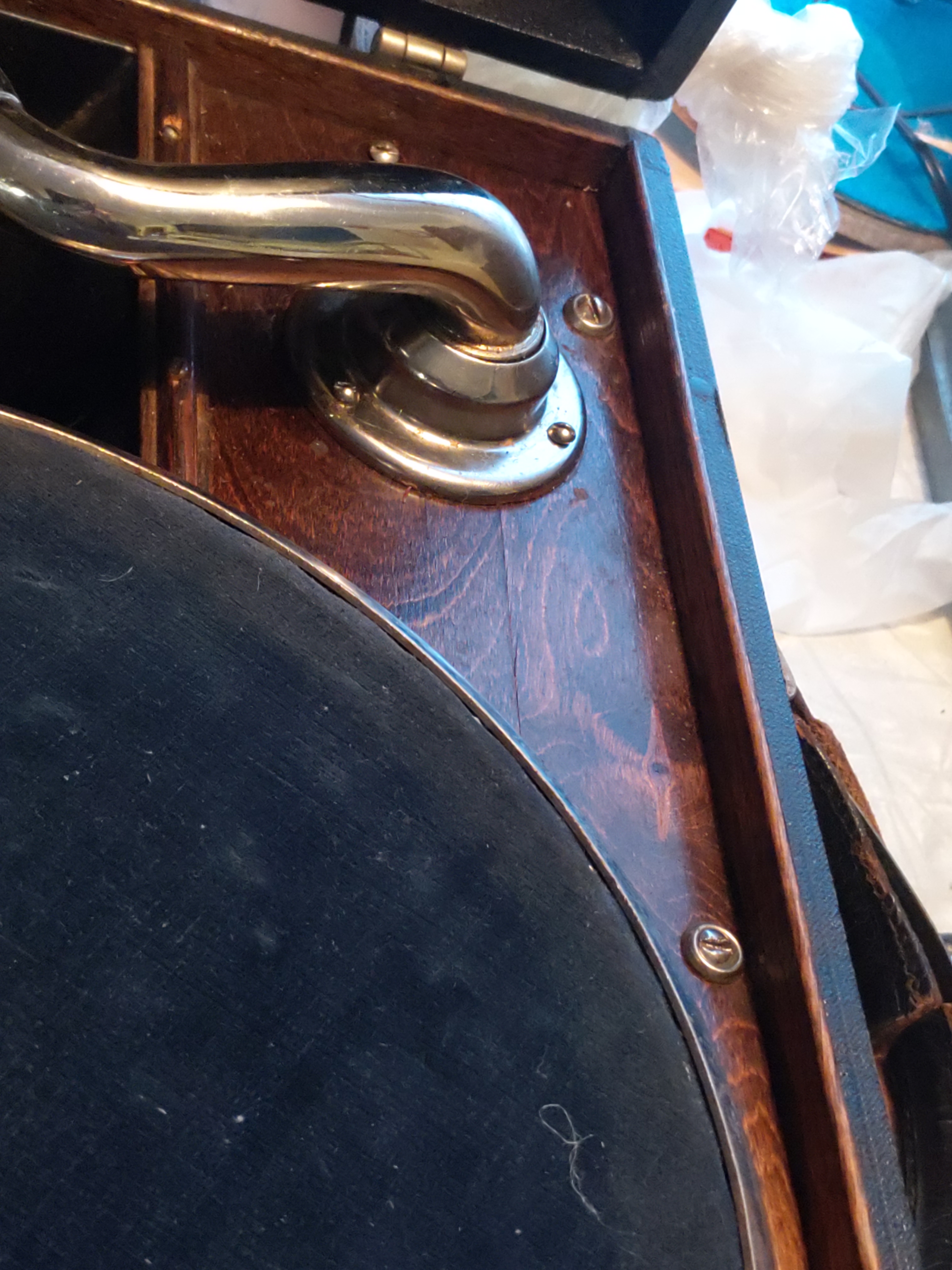

We can also see wood carved out at the rim surrounding the horn, it is necessary to allow the turntable to spin freely!

The labels on the lid are old and should be easy to remove by sponging with water, for just long enough to soften the gum.
Be grateful that they are not self adhesive. That would be a longer and more difficult job.

epigramophone wrote: Wed Feb 02, 2022 4:44 am
Actually I like the labels. You can have fun by drinking while listening to the music and as the bottles deplete, replace the old labels with colorful brand new ones. I keep a gramophone that belonged to my aunt, that she covered with labels, not of liquor but of hotels she stayed - this was from the times when hotels issued these labels to be glued to travelers bags.

I have used replica pre-war luggage labels successfully to disguise damaged case covering on a portable.

What if you try to restore the labels and preserve them? It would look nice if you removed them and clean the Rexine etc... but it's a pity to destroy that interesting story of the machine! What a dilemma!

CarlosV wrote: Wed Feb 02, 2022 12:06 pm
This was my thought entirely. The labels are part of its history. Without them it's just the same as another example. I'd definitely keep them. Granted, labels showing the travel of the Gramophone would be more interesting but.........
Everybody's different.

I actually had the same feeling when collecting the gramophone, to keep the labels, but then started to doubt my initial feeling, thinking about cleaning up the machine to make it shine etc.
The labels seem to be from the 1960s as far as I can see, I recognize this particular "Selters" label from that period.
I am still hesitant...also because I am a lousy drinker myself.;)
