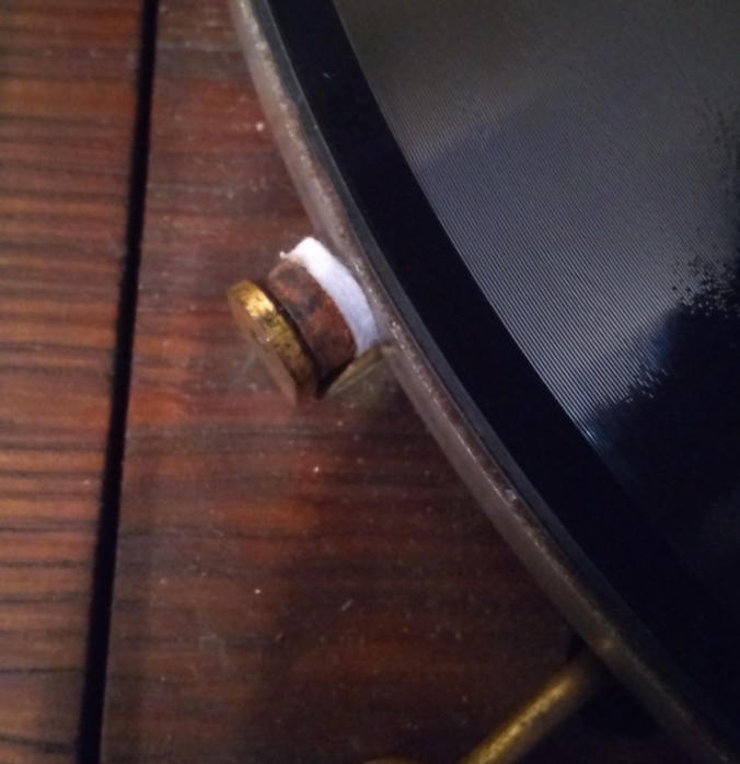

The Brake Pad
A hardware store in my neighbourhood is having a going out of business sale. I wandered around and found some furniture pads of exactly the right size for use as brake pads, a 75-piece pack.
The existing brake pad was very easily shaved off with a razor sharp knife.
As this is an experiment, I did not clean up the end of the cork pad much. The shaving had produced a quite smooth flat surface. I peeled a pad off the sheet of pads and stuck it on, an exact fit. I put a small spring-loaded clamp on it for a couple of hours, and then I tested it out.
It works quite well, so far. It provides a slightly slower, more gradual, gentle stop than the abrupt near-immediate stop of the original. This may change as the pad compresses, wears, and conforms more to the curvature of the platter. It remains to be seen how well the pad wears and how well the adhesive holds. For the moment, it is all good.

Nice! If it works well, and later the adhesive goes off, you can re-glue it with a more reliable contact glue or something.
Just a suggestion... These felt pads for furniture legs are also made in a much more discreet dark brown colour, and are very cheap. If you could find that, it would match better, I think...In my AV machine I glued a small leather pad, which works very well, also stops the turntable gently...
