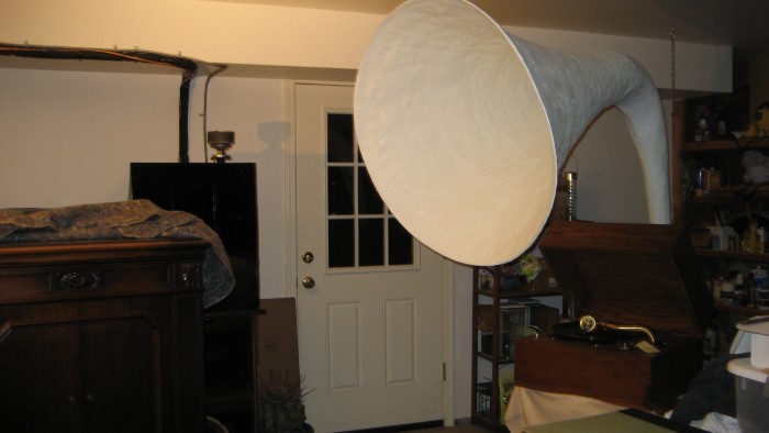

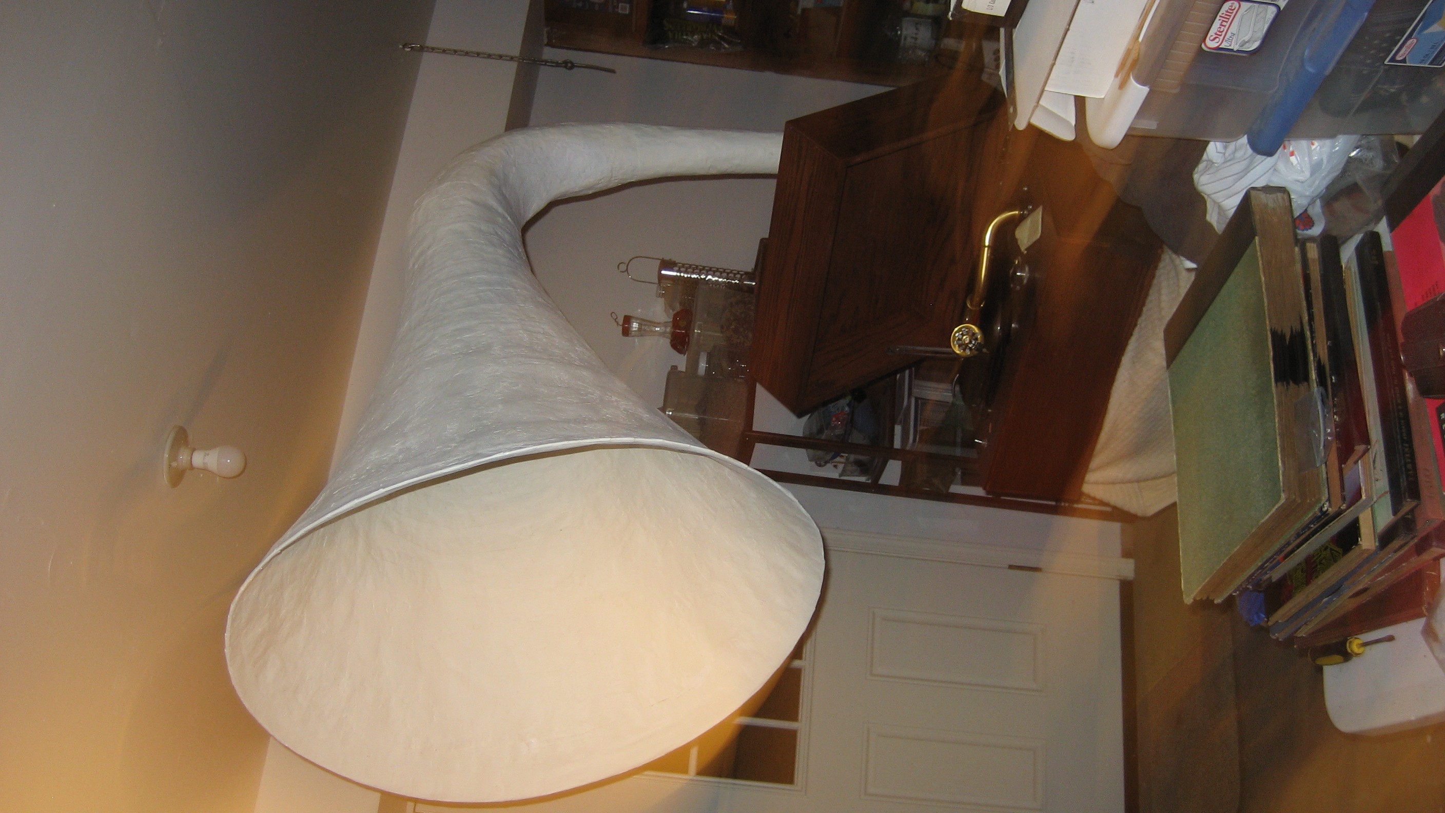

When you did the calculations for the horn length, did/does that include the length of the tone arm and the connecting piece between the tonearm and the horn?

Yes for the tone-arm; no for the internal conduit—the internal conduit is constant-bore and small diameter, so (according to Modern Gramophones, at least), it shouldn’t have much effect on the soundwaves going through it. The tone-arm is tapered, though, so it does act as part of the horn/horn length—I measured the diameter at the narrow end of the tone-arm I used at 23/32”, the diameter at the large end at 1 ⅜”, and the length at about 14”, which gives a cut-off frequency of about 100 Hz, so I used that as the cut-off frequency when designing the horn. Ideally, the internal conduit would have been tapered, too, so that the entire thing, from the soundbox to the horn mouth, had the same flare (in which case the tone-arm and the conduit would both have contributed to the horn's length), but the 100 Hz contour flares quickly enough at the tone-arm outlet that the curvature would have become quite tight.anchorman wrote: Thu Oct 27, 2022 2:04 am When you did the calculations for the horn length, did/does that include the length of the tone arm and the connecting piece between the tonearm and the horn?
I think I read somewhere that adding constant-bore sections near the throat does lower the resonant frequency of the air column inside the horn because it increases its length, and maybe boosts the bass at that frequency as a result, even though it doesn't change the official cut-off frequency--I'm not sure about that, though; I could just be making it up from bits and pieces of horn articles that I only half understood...

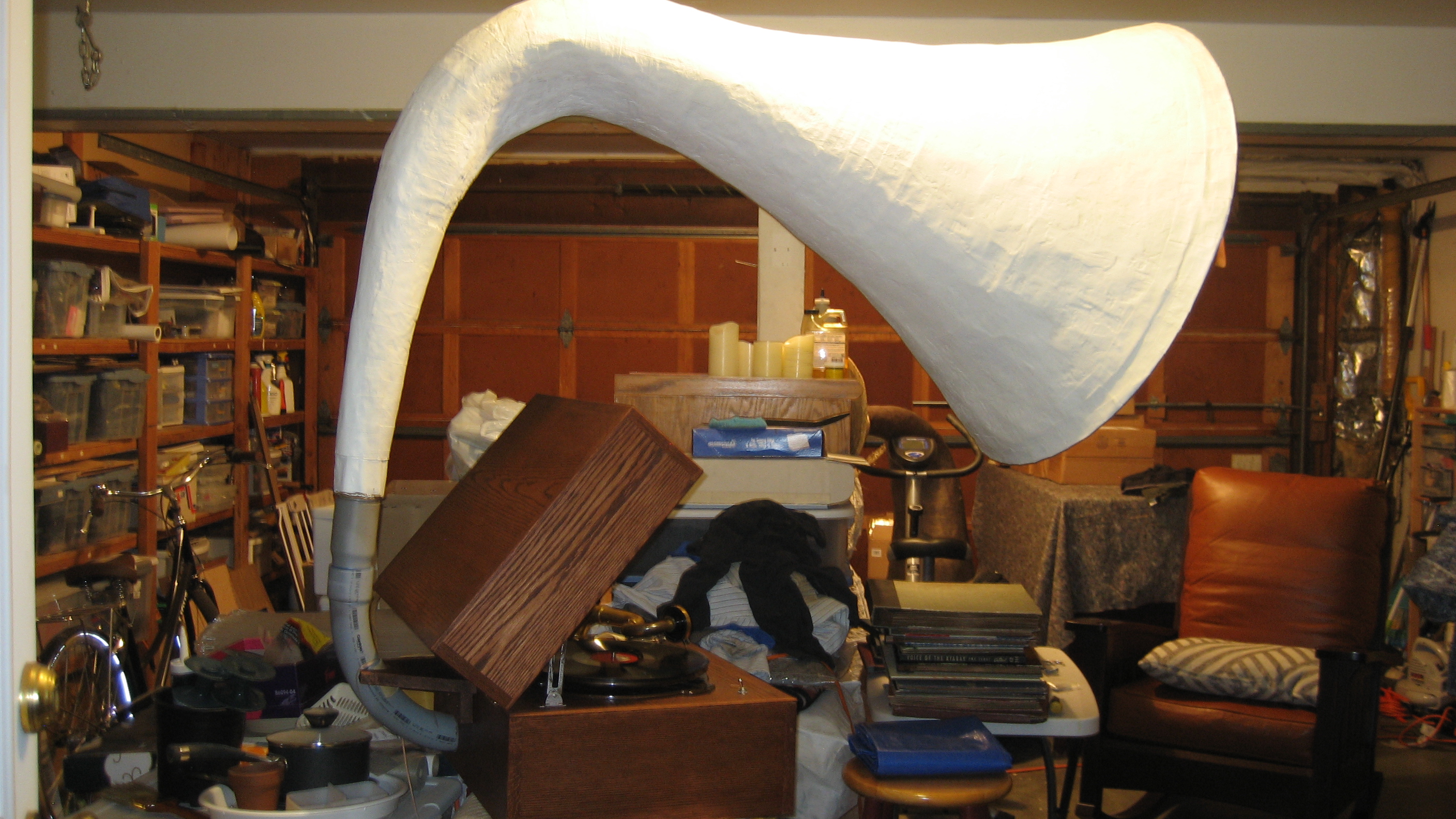

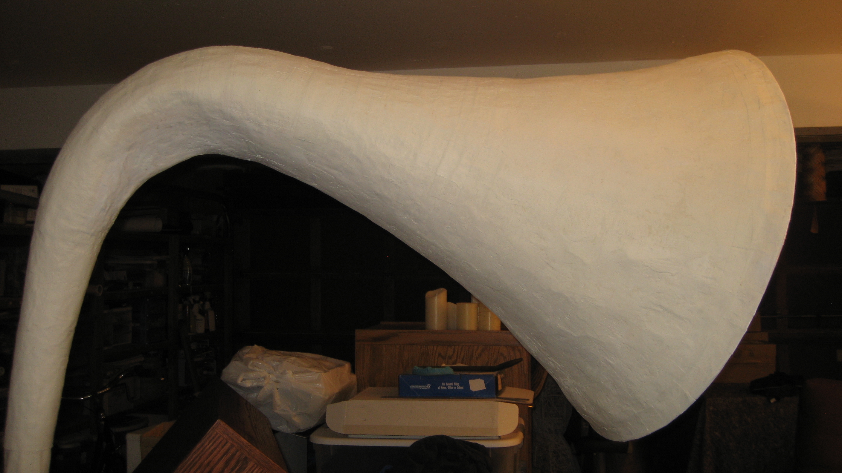

By the way, this is one of my home-made gramophones. The bell diameter is about 33". I use Collaro electric motor and Credenza's tonearm and Credenza's brass reproducer or Meltrope II soundbox. I use my hand-made susudake needles or thorn needles.

Hideki, I surrendered years ago to your charming achievements in gramophone things, your yt videos, your singing, and all that. On me you have an unconditional fan.
I already knew your emg-esque handmade gramophone, and it's great! Probably by one of your videos playing it...
