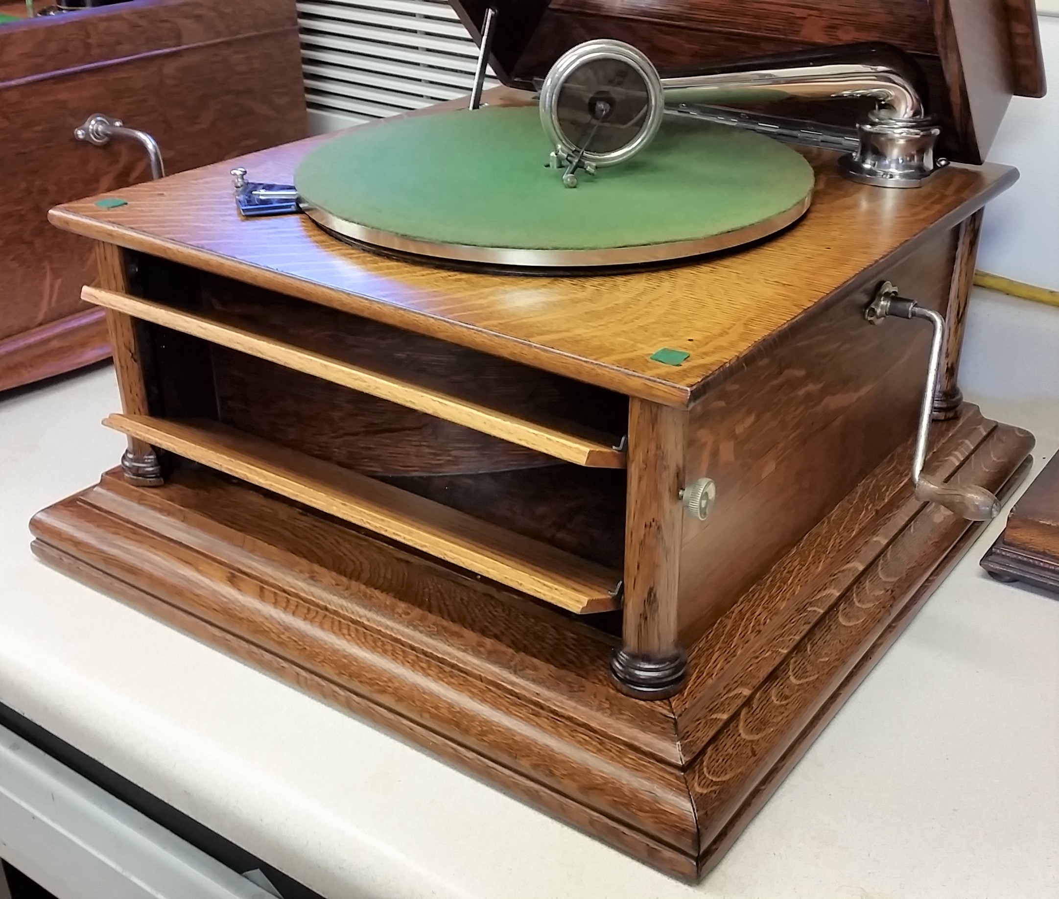

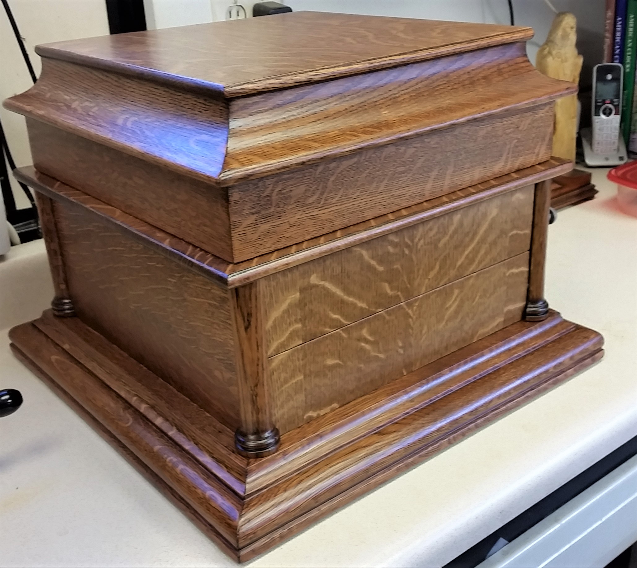

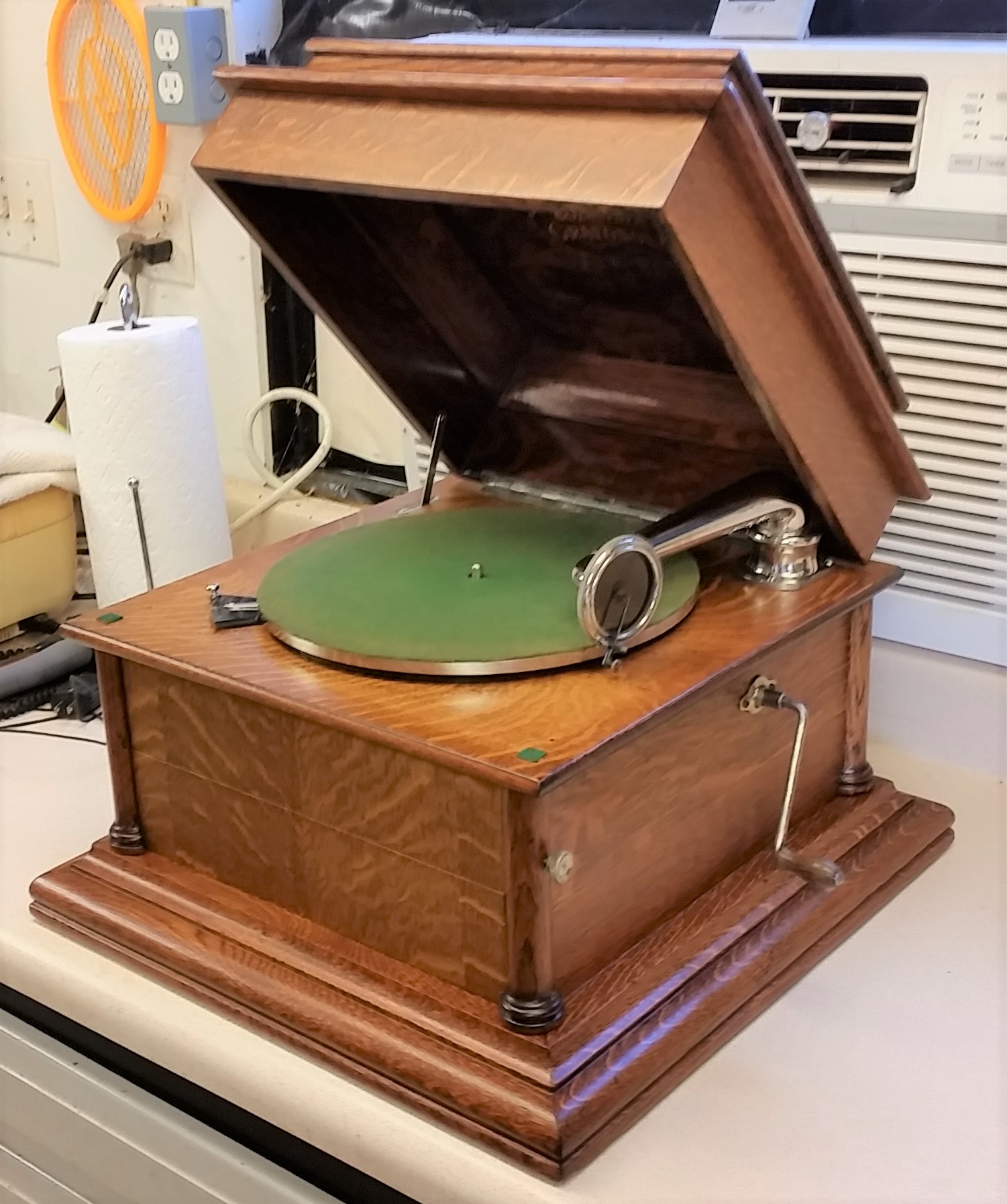

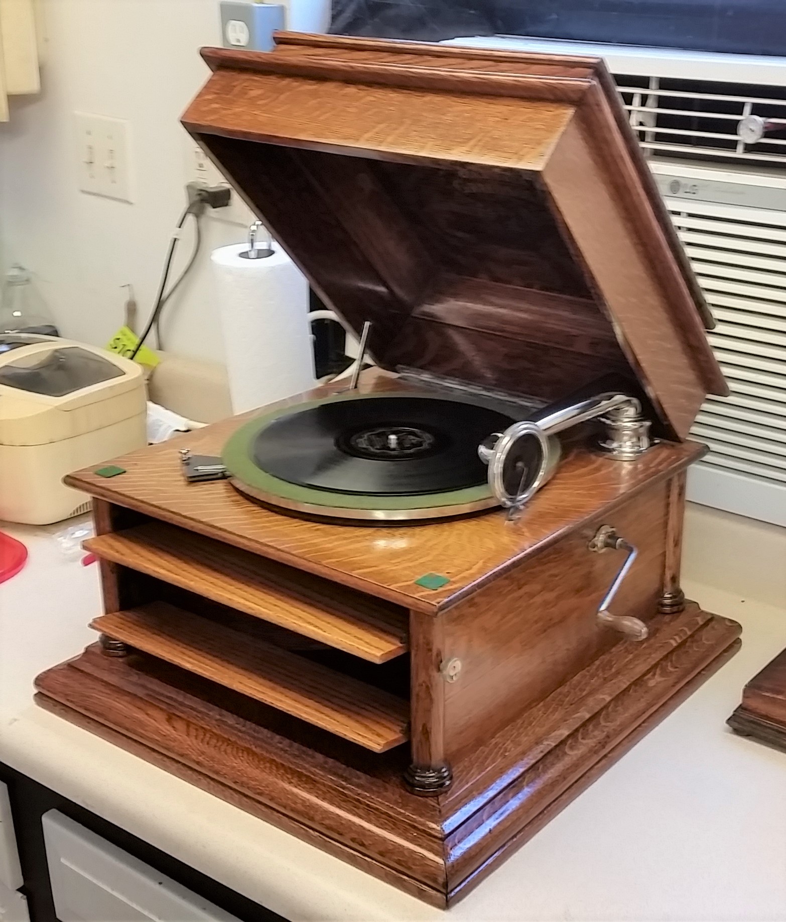

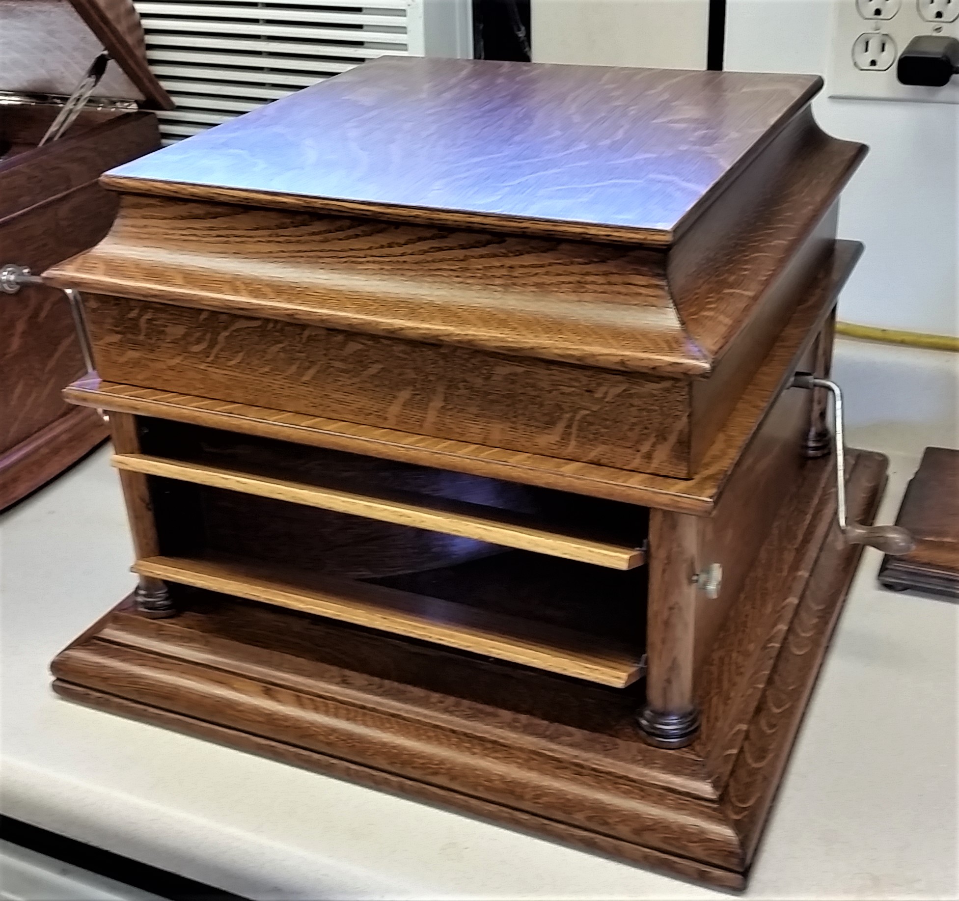

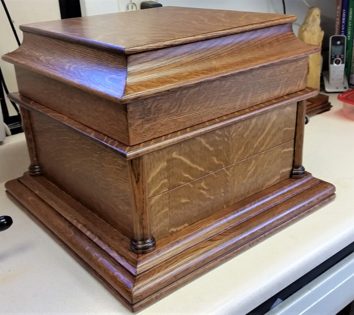

Well after doing a new finish on my VV-IX in satin lacquer I decided to redo my Columbia. I disassembled the machine and gave it a light sanding with 400 grit and a #0000 wool wipe. I put 3 coats over the 10 coat shellac job in satin lacquer. Now it looks like I wanted at the start of the project. I just did not know how to get there.
