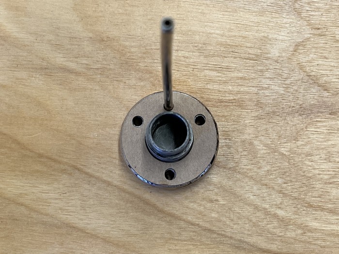

To get over this difficulty, new washers have been manufactured from a nitrile rubber, the definition of which is as follows :
DMR NBR is a black Nitrile Butadiene Rubber, commonly referred to as NBR, Nitrile or Buna. Good physical properties and chemical resistance to the most common hydraulic fluids makes NBR an excellent sealing material. NBR materials are one of the most commonly used elastomers in sealing applications.
The shape, as shown in the photos, is partly conical (45 degrees) which ensures that outward washer pressure is increased in line with oil pressure in the cylinder. The diameter of the plunger is 0.500” and the nitrile cone outside diameter varies 1/16” either side of this measurement.
I now have a good stock of these washers if anyone should be in need. They work well and should greatly increase longevity.

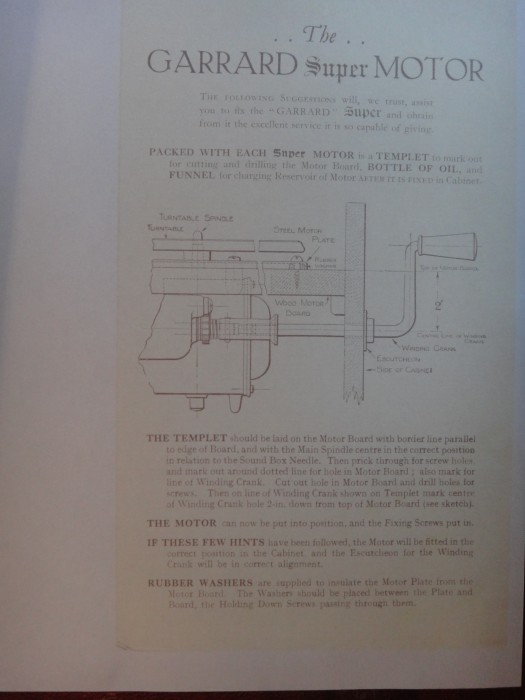

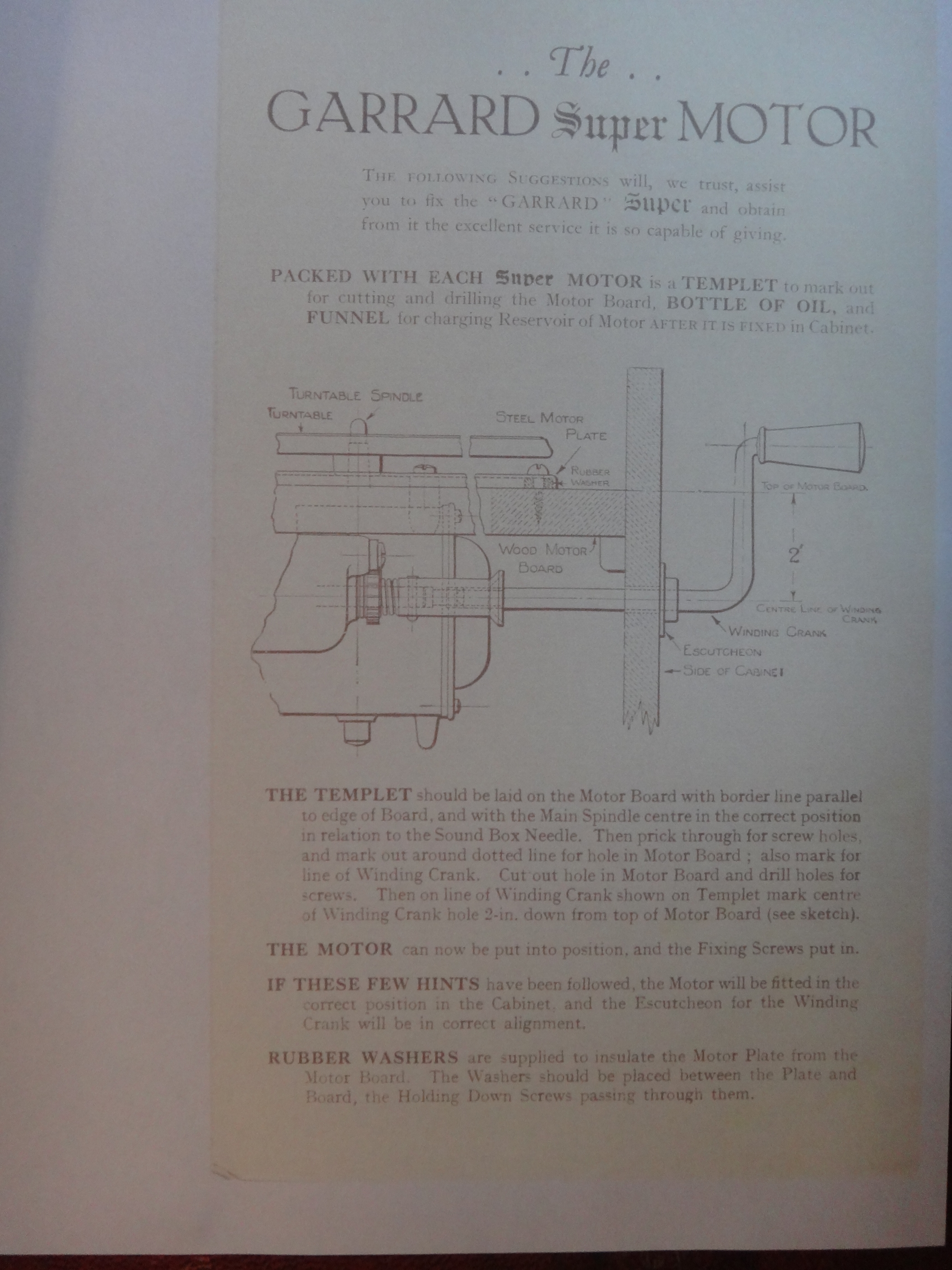

Garrard oiling instructions.

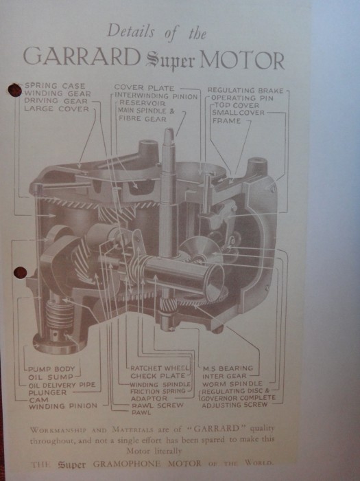

Here is a schematic drawing of the Super Motor.
Click on image to enlarge.
