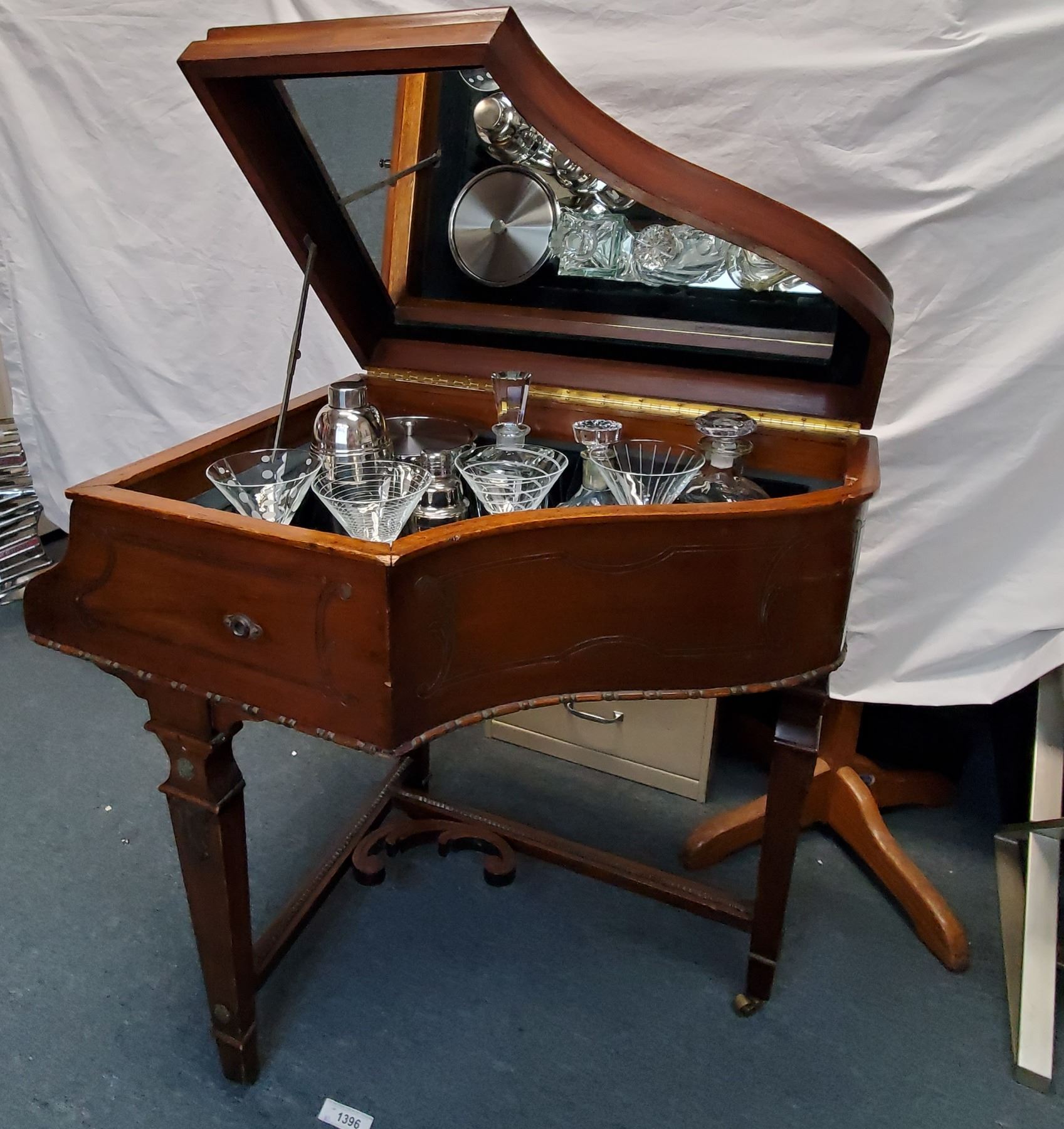

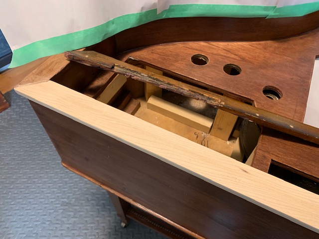

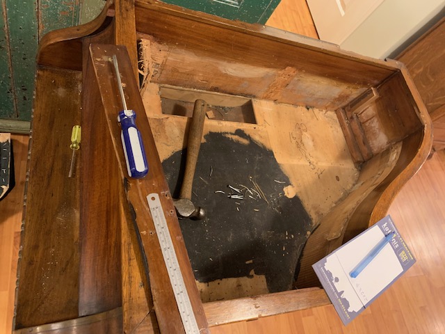

Over the past years, many fellow forum members have bemoaned the loss of phonographs to non- collectors, who preferred some form of shabby chic, or even the conversion to a liquor cabinet. Earlier this year I came across a unique gramophone cabinet which had suffered this fate, having its guts removed and replaced by mirrors, velvet, and all the glass ware required for a liquor cabinet. I could not pass on the challenge of returning this beautiful musical instrument to its former glory. I successfully bid against a couple others who thought it would make a great addition as a liquor cabinet in their “man caves”.
Once I got my prize home, I reached out to several collectors through this forum and determined that it originated from England, and I was able to locate photos of 9 other machines. It is apparent that the builder of the Operaphone used motors and upper works from whatever manufacture they could, mostly concentrating on Thorens.
The following is a chronology of the restoration steps that I followed:

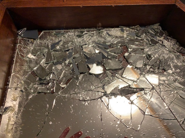

- Removed all evidence of the liquor cabinet (including having to smash the glass glued to the inside of the lid).
- Dismantled the cabinet and stripped all remaining finish and stain.

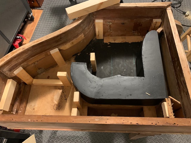

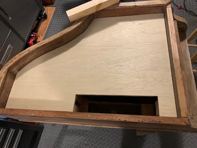

- Built the internal horn and cut the top decking and motor board from ¼ inch mahogany board.

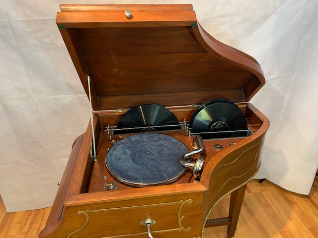

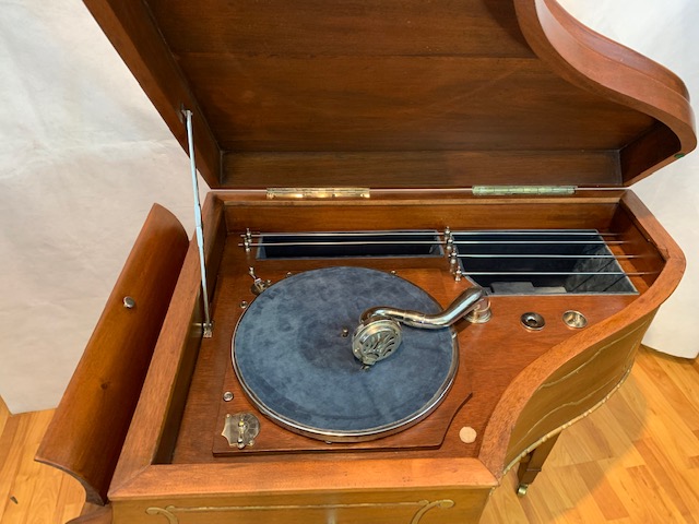

- Refinished the cabinet with light brown mahogany wiping stain (darkening the stain with a little walnut colouring to match the new wood to the old).
- Hand carved replacement trim pieces and painted the trims gold.
- Applied the wiping stain on the dried gold trim to dull the glint and give it an aged look.

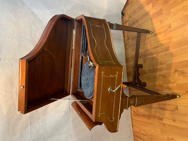

- Finished with a couple layers of satin lacquer, sanding after each spray, and then finishing with a layer of semi-gloss lacquer.
- I was fortunate to be able to keep the finish under the front speaker lid where the "Operaphone” decal was located, and I used this area as a guide for the remainder of the cabinet finish.
- Installed a Thorens motor and upperworks, and finished the turntable and record shelves with velvet matching a small sample (fortunately left behind by the liquor cabinet maker).

WOW! I am really impressed ;) . Can you upload a video of it playing?

Top notch transformation! :ugeek:

Clearly a labor of love. Congratulations on a job well done.

Really great to see a reverse restoration on a rare phonograph. That was a lot of time consuming and great work. Tom

Your craftsmanship and attention to detail are breath taking. A magnificent achievement.

Fantastic! Congratulations :)

Excellent work!
I like that you smashed the mirror. It was probably the only way to get it out, but even if it weren't, it deserved a good smashing! 8-)

Nice lovely restoration, Master!
