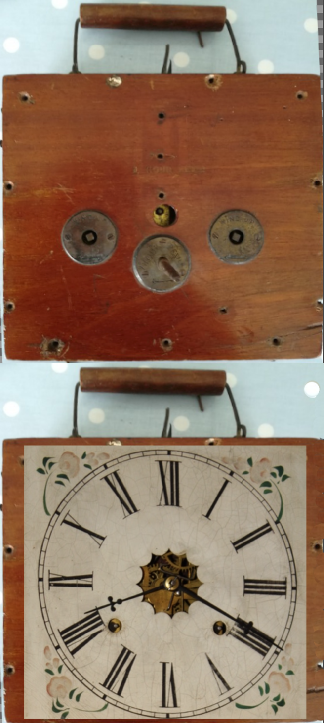

Shane, I didn't get John C Hoyer from the bottom left arm, but I thought I could see "Conn" on the last line. So, after some research on Connecticut clock makers, I came up with Waterbury Clock Co. based on the distinctive shape of the movement and its framework. I found a picture of a Waterbury movement which appears to match the movement in the OP's box. I made a composite picture comparing the two and I believe that they match.
So now the question is: "What is the boxed clockwork for?" Maybe, a traveling clock of some kind...? :? :roll:

I found a period square Waterbury clock face, so adding it to the original picture of the box, gives an idea of what this would look like as a traveling clock... Who knows?
