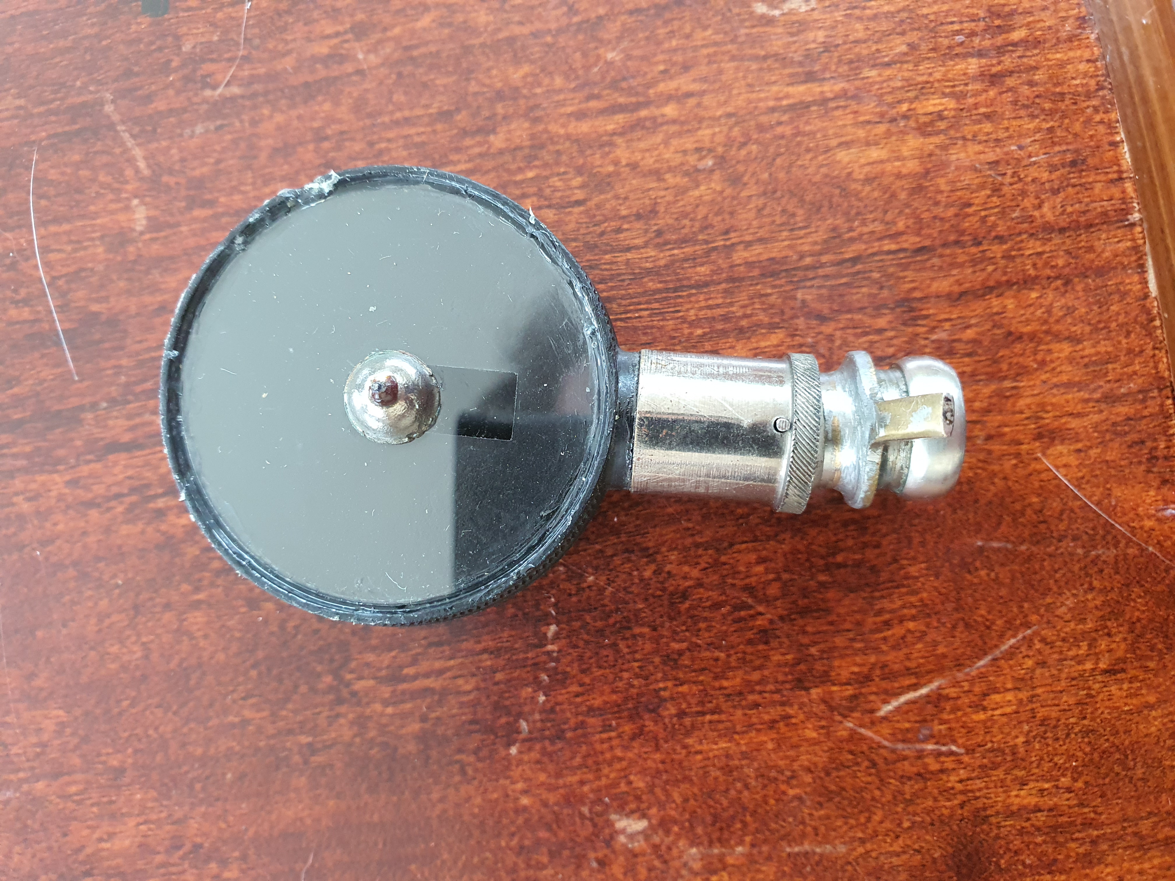

I'd also appreciate a photo of the underside of the reproducer. I'll need to make a stylus holder and would like it to look as close to original as possible.

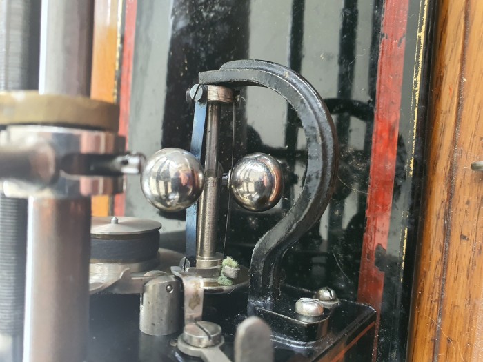

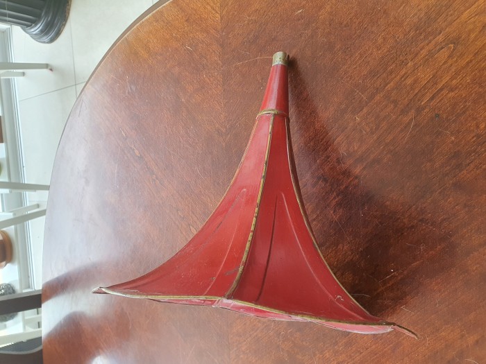

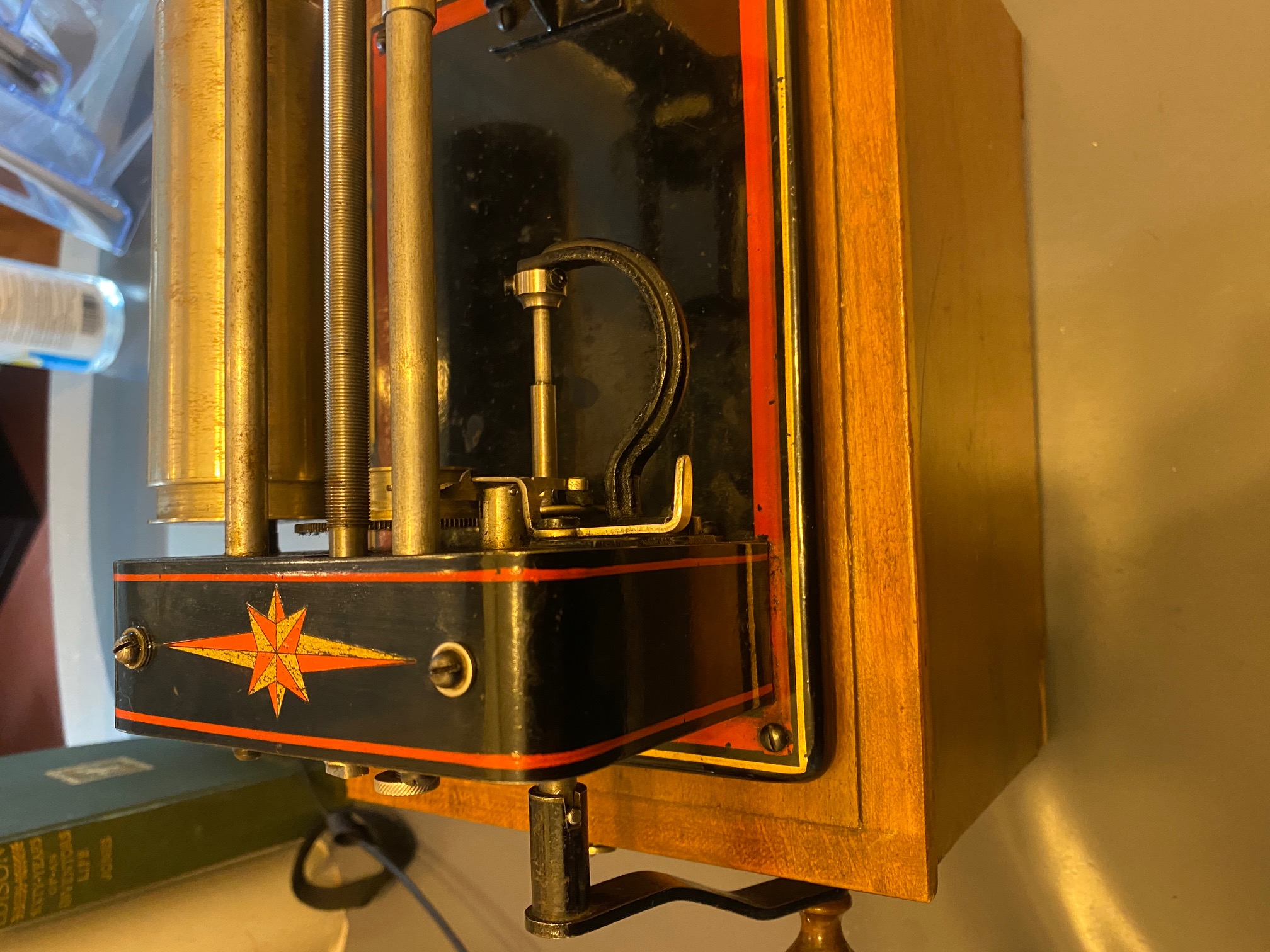

I have one of the same brand, not sure if the same model as yours - the decoration on the metal top is different, but otherwise looks the same. The governor weight diameter is 1.62 cm, see photos below. I also took a photo of the reproducer and the horn. Mine is an original horn, not aluminum, but painted tin. Aluminum horns are more utilized in the French Pathé machines, most German machines had tin horns. Hope it helps.

I think it can sometimes depend where the machine was sold.CarlosV wrote: Wed Jun 30, 2021 10:11 am Mine is an original horn, not aluminum, but painted tin. Aluminum horns are more utilized in the French Pathé machines, most German machines had tin horns. Hope it helps.
The small spun aluminium horns were pretty popular in Australia and I believe also in the UK, so you do see machines like Excelsior, Thorens, Edison Bell, and even Columbia Q's turn up with original (and reproduction) aluminium horns.

You are correct, I had in mind the phonographs sold in Germany, where most EWC machines shown in the advertisements of the period had tin horns, either conical as you say or like mine. For sure the aluminum horns were very popular in France, probably due to Pathé's dominance on the market. EWC sold a lot in England, and it is likely that as you say the consumer could choose among different horns at the time of the purchase.gramophoneshane wrote: Wed Jun 30, 2021 12:25 pmI think it can sometimes depend where the machine was sold.CarlosV wrote: Wed Jun 30, 2021 10:11 am Mine is an original horn, not aluminum, but painted tin. Aluminum horns are more utilized in the French Pathé machines, most German machines had tin horns. Hope it helps.

Oh, yes, these are very common all around, and mainly in France. But the straight tin cones were also in the old German EWC advertisements.gramophoneshane wrote: Wed Jun 30, 2021 2:07 pm

Carlos! Thanks so much for the great photos! It looks like your weights are nickel plated. I was going to use weights and governor springs from a Columbia Q, but they are smaller than yours. I can order some brass balls almost exactly the same size as your machine has and then drill and tap them. I found that the 3/16" Victor governor spring is a nice match for this both in width and thickness. I'll nickel plate my new weights and they will look like yours.

You're welcome , Dave! Yes, the weights are plated (they are the original ones), and your plan to get brass balls and plate them sounds very promising. Good luck with your undertaking and don't forget to post the results!Dave D wrote: Thu Jul 01, 2021 11:09 am Carlos! Thanks so much for the great photos! It looks like your weights are nickel plated. I was going to use weights and governor springs from a Columbia Q, but they are smaller than yours. I can order some brass balls almost exactly the same size as your machine has and then drill and tap them. I found that the 3/16" Victor governor spring is a nice match for this both in width and thickness. I'll nickel plate my new weights and they will look like yours.
