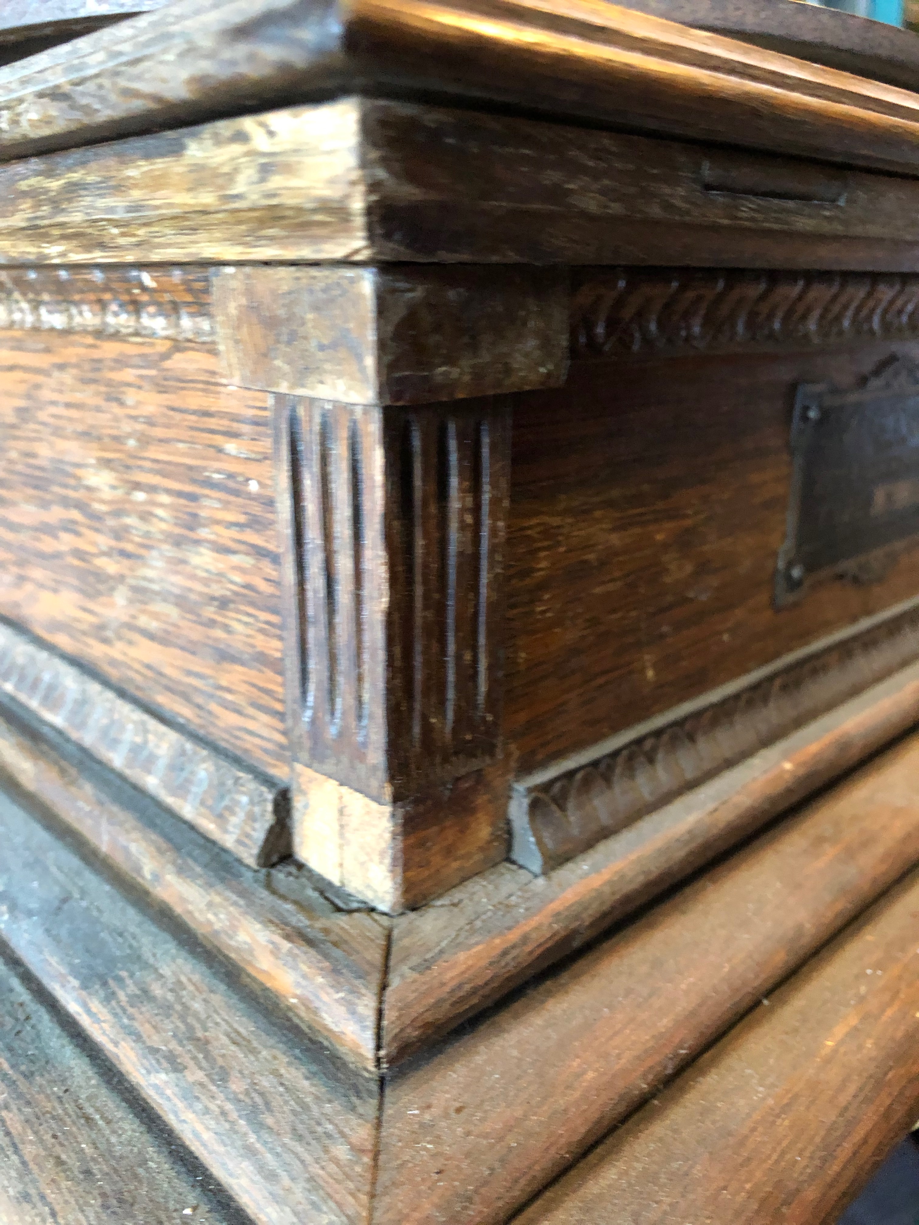

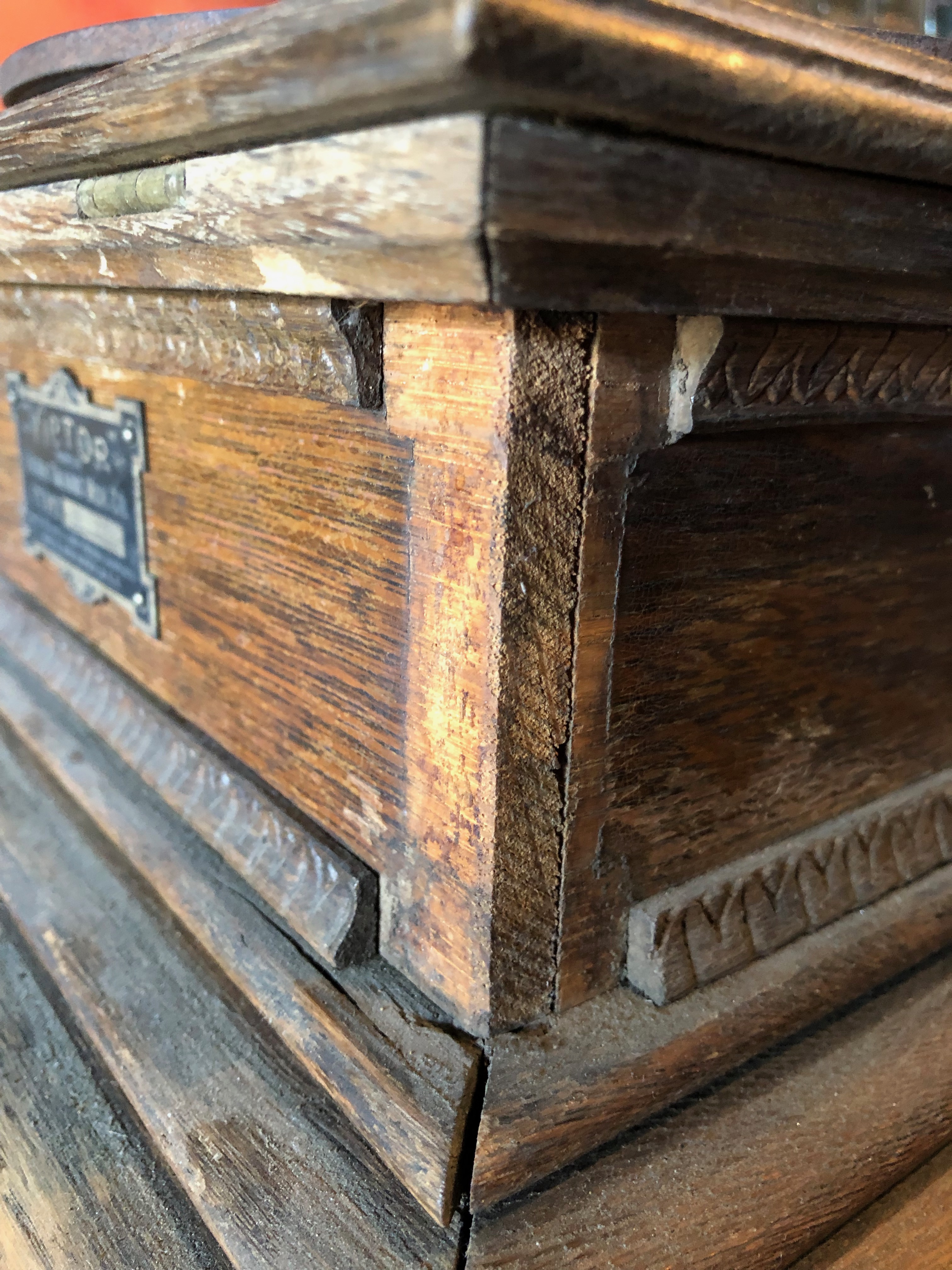

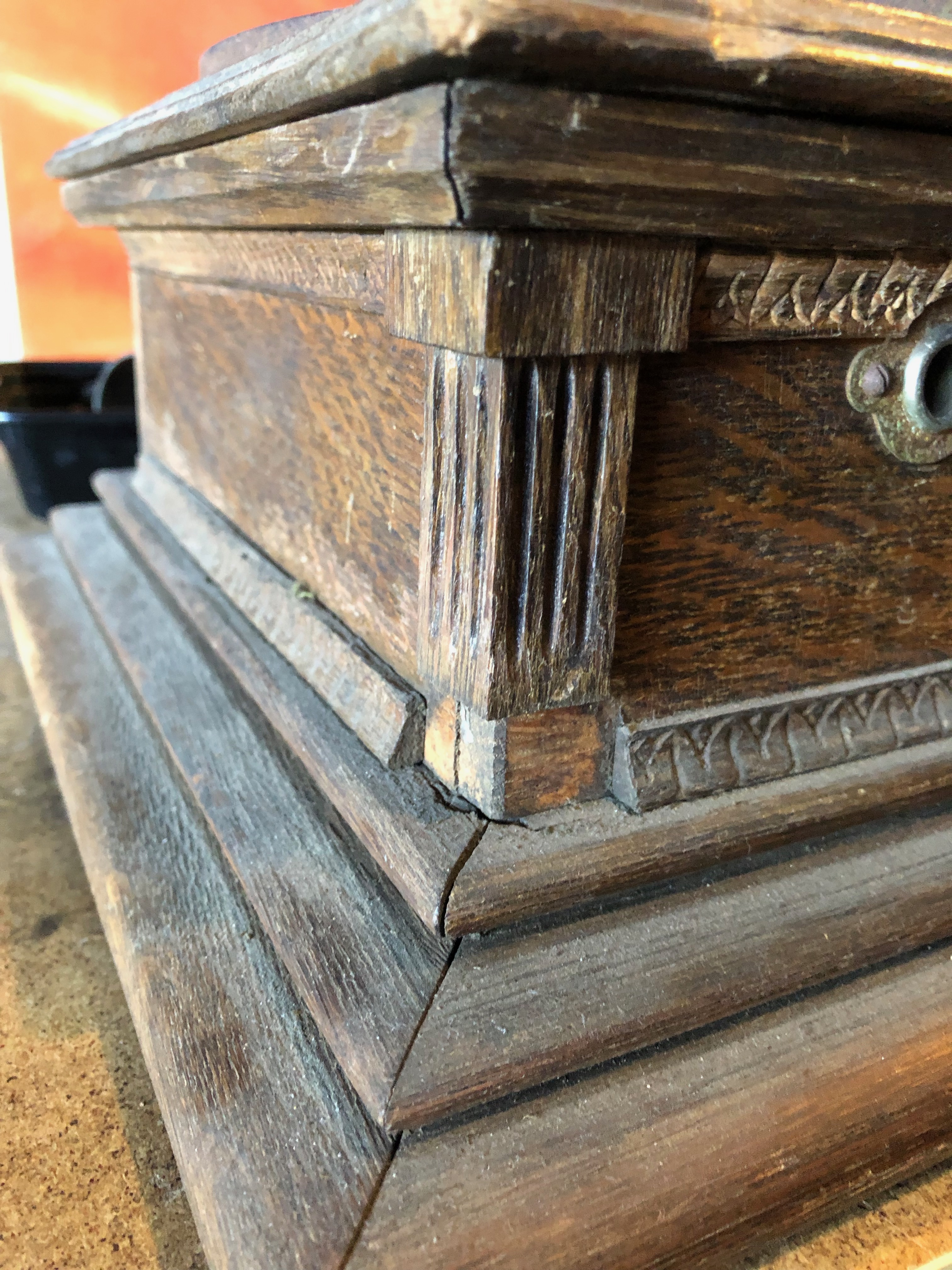

Does somebody make or have replacement corner columns for a Victor Monarch? My M is missing the bottom piece of two columns and the entire column on one corner. (I'm not really a woodworker, and don't know how to make them myself.)

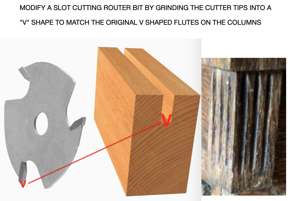

I made some for my M several years ago. They are simple to make if you have a table saw... Although to make the "V" shaped flutes, I had to modify a router bit and set "stops" on my router table to make them the correct length...

Foe anyone who wants to make their own, here is how I used a router bit to cut the flutes...
