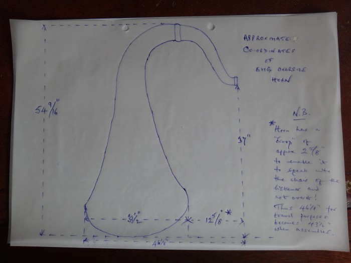

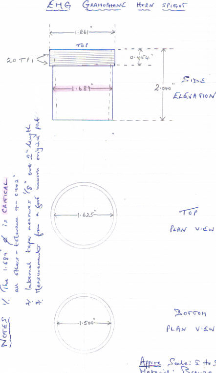

The straight answer is yes---for the larger examples. The details are available in page three of this post : viewtopic.php?f=11&t=15076&start=20TN Allen wrote: Sat Jul 10, 2021 10:44 am .................are dimensions available for the E.M.G. horns?
Although the horn template is specifically copying the profile of the EMG Xb Oversize horn, the flare is identical---but shorter---for the standard Mk Xb and Mk Xa. The three bell mouth diameters are 33 ½", 29 ½" and 28 ⅝" respectively. Thus the template can be used to reproduce exactly the original shape of these horns---or indeed any horn with desired final diameter lying on the same curve. The standard Xb 29 ½" horn was decided upon as being the maximum size that would coveniently fit through a single British standard door opening of similar width and had little to do with acoustic considerations per se.
It is important to note that the EMG sound does not just rely upon the horn---the whole carefully designed acoustic track through the bronze spigot, cast aluminium conduit, cast brass tonearm, swinging copper section attaching to the soundbox and the soundbox itself are all vitally important.
If you decide to build a horn I should be happy to make and send a paper copy of the profile. I have attached rough sketches below showing the bronze spigot and Oversize horn dimensions.
