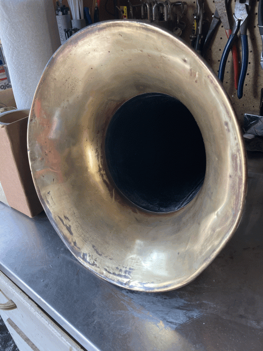

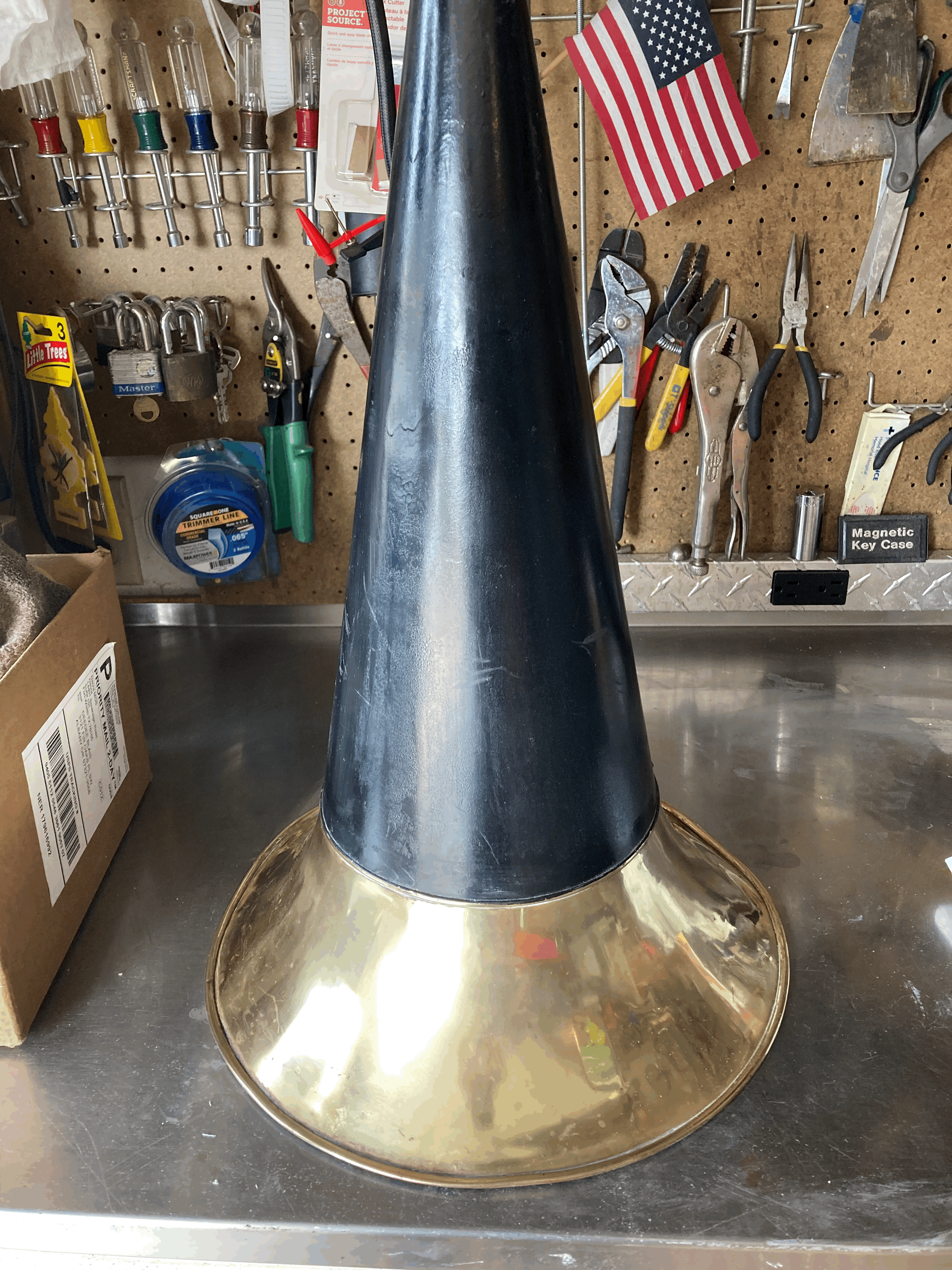

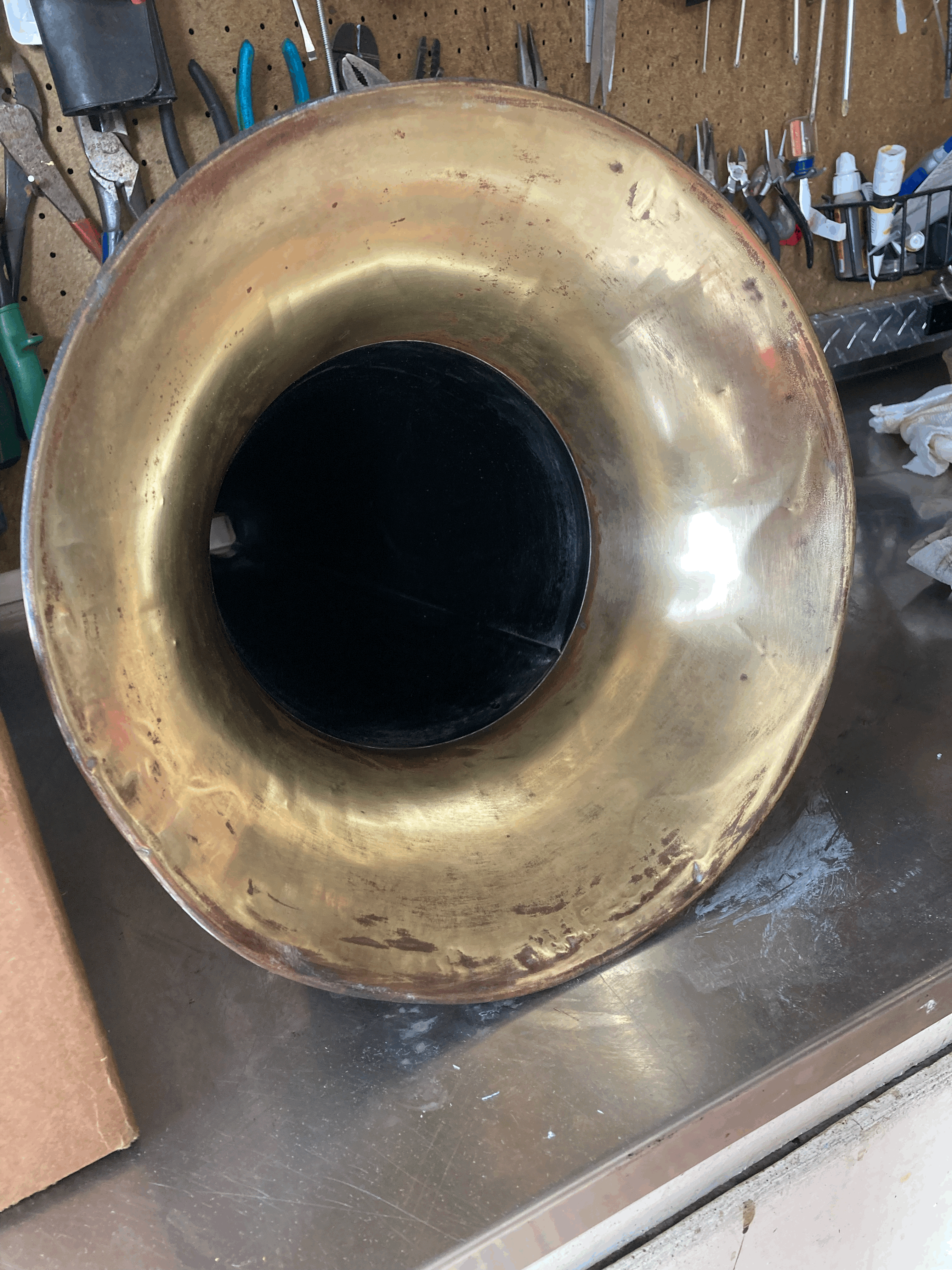

I am trying to get a Talk-O-Phone ready for the APS Expo. It's all ready except the polish on the brass bell. The outside is ok but I'm dying on the inside of the bell. I've used Brasso. I thought part of my problem might be that the brass was protected by lacquer but lacquer thinner had no effect. Any suggestions would be appreciated.

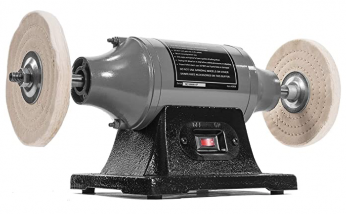

A buffing wheel with jewelers rouge would be the best option... One of the first tools I bought when I started doing restorations was a ½ HP 6" bench grinder with interchangeable buffing wheels and it has been one of the most valuable tools I have for parts cleaning and polishing. You can get a good one for under $100 and all you need is a variety of rouge types.

A small buffing wheel attached to an angle grinder would be my go to for that kind of thing

I used lemon juice with a tab of salt applied with 0000 steel wool. After cleaning I did a final polish with Brasso. It made the horn presentable. Sorry, no photos, like I said, it only looks presentable.
I do appreciate the suggestions.
