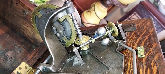

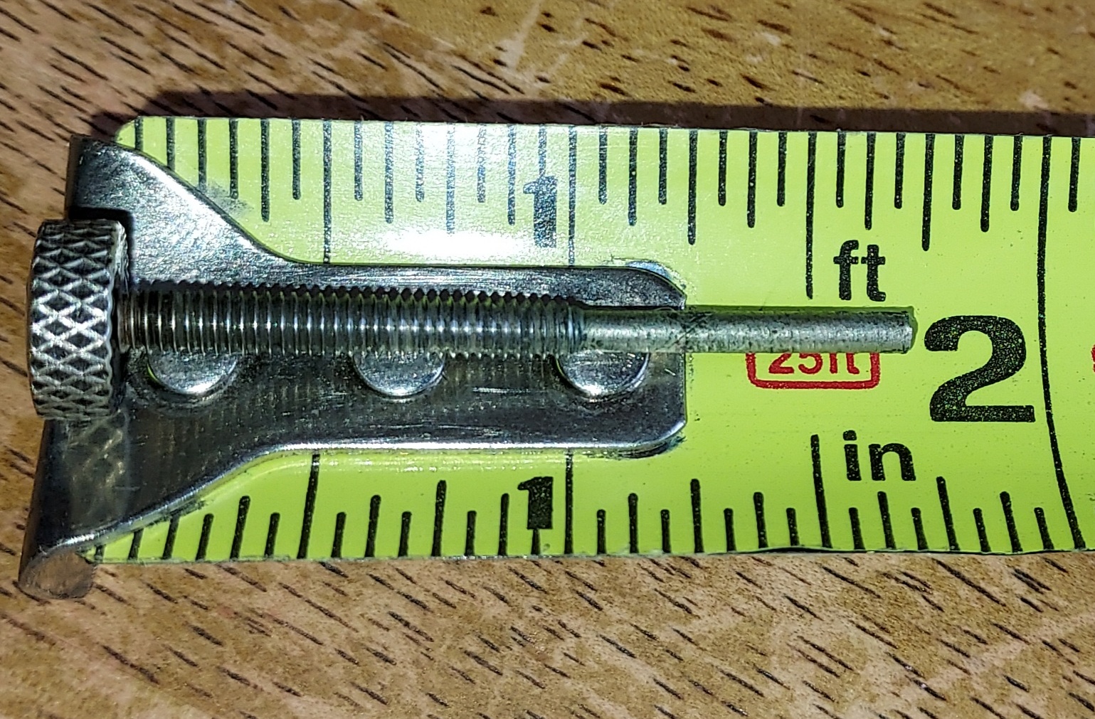

Hey guys. Having an issue with the speed knob to the speed arm. Appears the knob is around 1" too short of hitting the speed arm where it should be. I tried setting the speed ring against the governor disc and moving the arm in place but the ring goes back to its original place. I know i've done this on newer machines with success. Is there a way to adjust this? The speed knob is around 1 ¾" long. I dont see any set screws for the arm. Really odd! Any help would be great!

Somewhere behind the finger that goes from the rod to the ring there must be a collar with a set screw (square head probably) that you have to adjust to get the ring with the leather pads closer to the governor disk, supposed the governor is properly adjusted. In your photo it cannot be seen, it would be located in that difficult area behind the finger. That screw adjusts the position of the finger respective to the rod, and its angle.
The finger is double, at both sides of the ring? Then it's more like a yoke with two fingers at both sides. Not easy to adjust... for there is also that spring coil tensioning the yoke backwards, pulling it away from the governor disk. I don't know this arrangement very well,bbut I suspect must be similar to the simpler one finger version from smaller motors of this type.

Yes there is. I thought that screw just moved the collar left and right to avoid the springs from hitting it. The governor is set perfectly. I will try this. Thanks!

No the set screw also applies tension (coil spring) to the pitch control rod. By loosing it you have now removed that tension and the rod has dropped. This is why your pitch adjustor is now too short.
It is tricky to keep the yolk (ring with two leather pads) centered and the rod up and under tension.

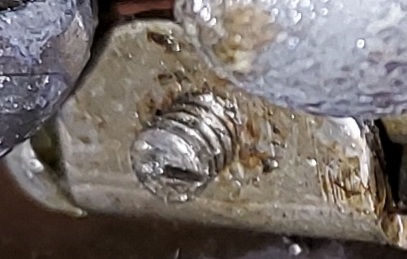

And this is what I'm dealing with.

Not the best condition but usable. You will have to reach the screw between gov weights/springs gap. a long skinny driver is needed. You will have to hold the rod up to the board and center the yolk while pushing the yolk toward the friction disc.....then tighten the screw. May take a few try's to get it where you need to be.
Also, don't over tighten the set screw. it will grab the rod. you do not want to break the slot.
