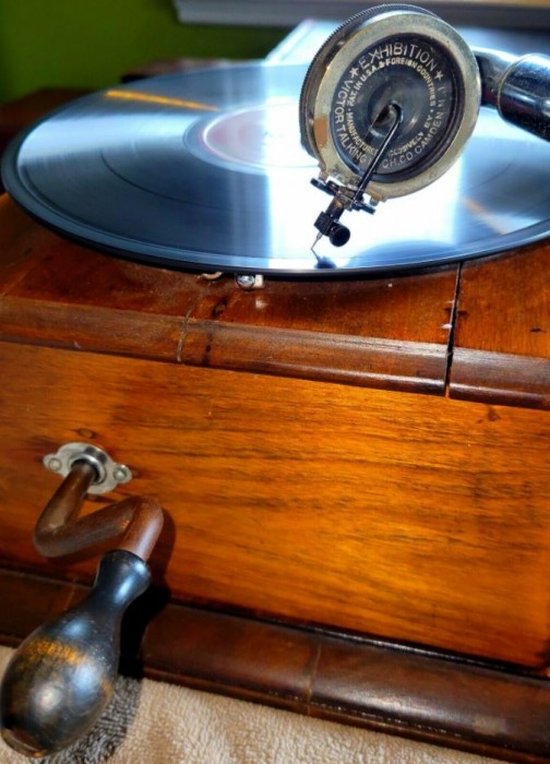

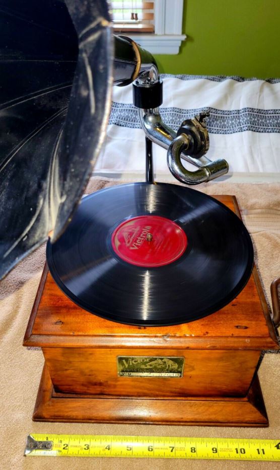

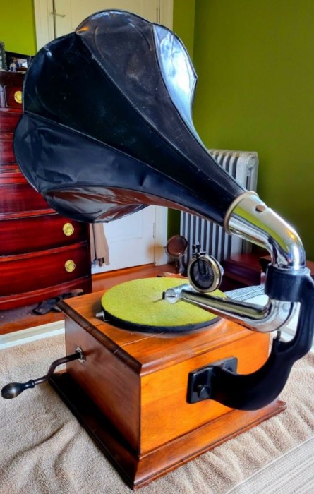

Here's some photos from eBay for when the sale ends and the machine is no longer available.
