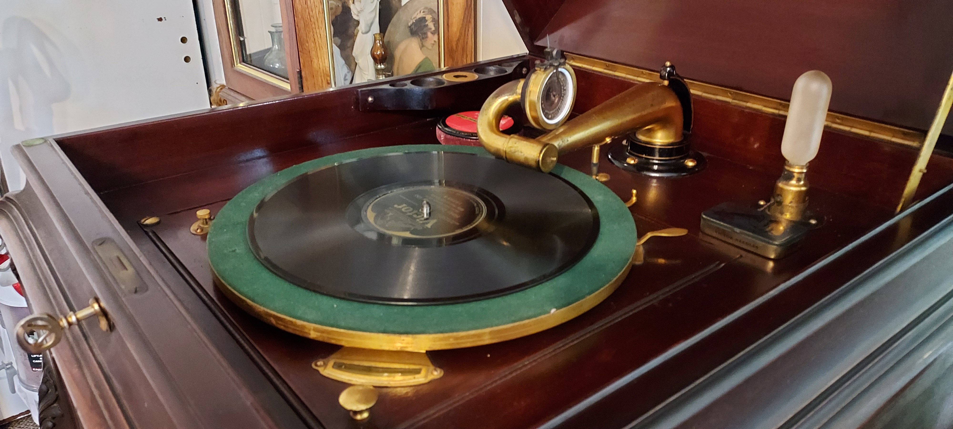

This may be a tough one, but can anyone tell me the specific size of the bulb that is used in Victor a phonograph lamp? Mine is blown in my VE-XVI and would like to get another. I need the socket size for the proper bulb (E12, etc)
Thanks!

Resolved! Measured the width of the base which is 12mm and found it to be an E12 bulb! Maybe this will help others!

Hey Steve, the original bulb was tested with an OHM meter and is ok. Its an issue with the socket itself. I tested the socked with a Multimeter and am getting power to it. I'm going to clean it with contact spray next and hope this does it!Stephen_Madara wrote: Fri Sep 10, 2021 10:19 am [url]https://www.amazon.com/15-Watt-Frosted- ... 410&sr=8-6[/urbulb.jpgl][
Do you know if there is anything other than the switch cord to turn on the light? I know the lid support activates it right?
