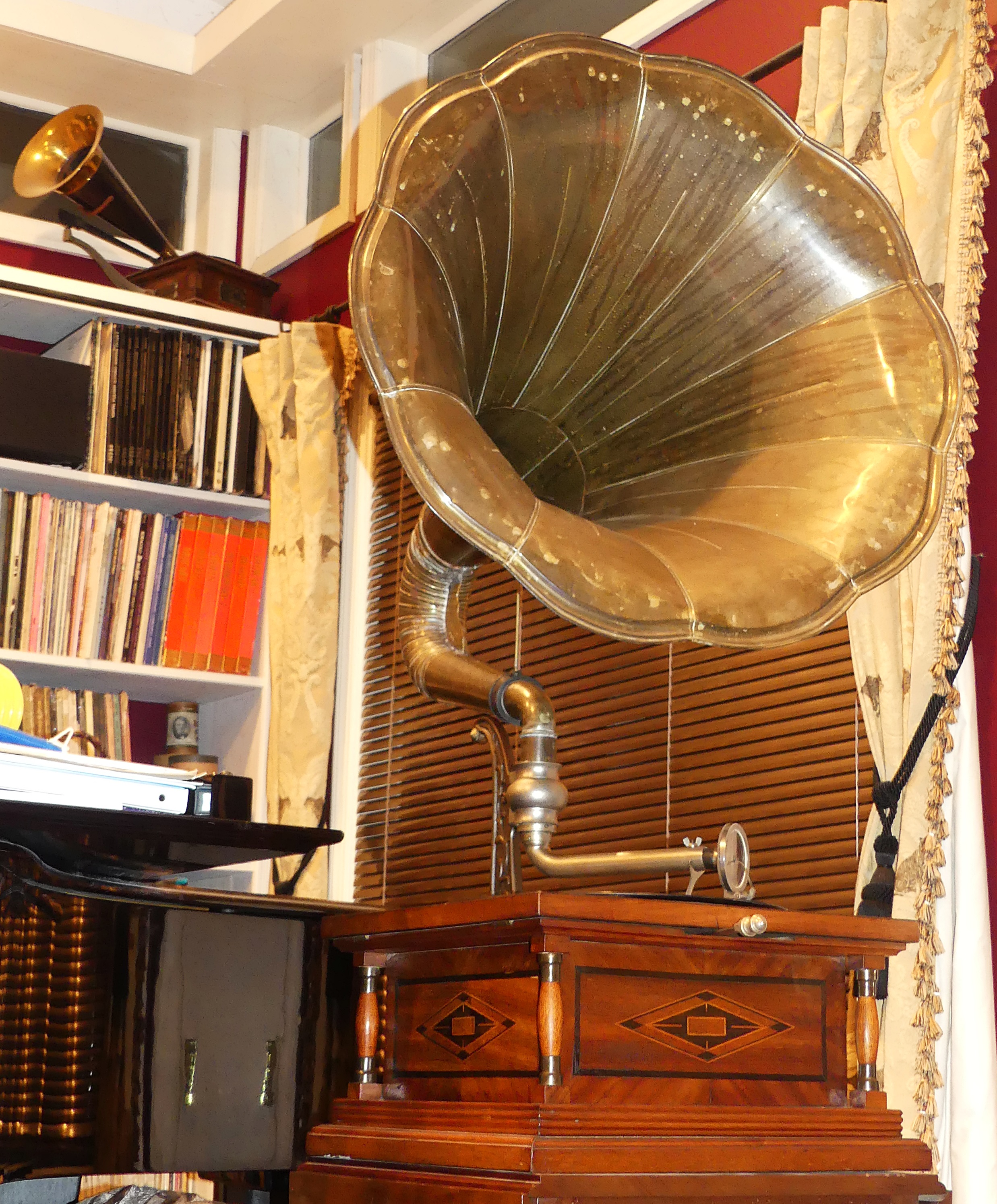

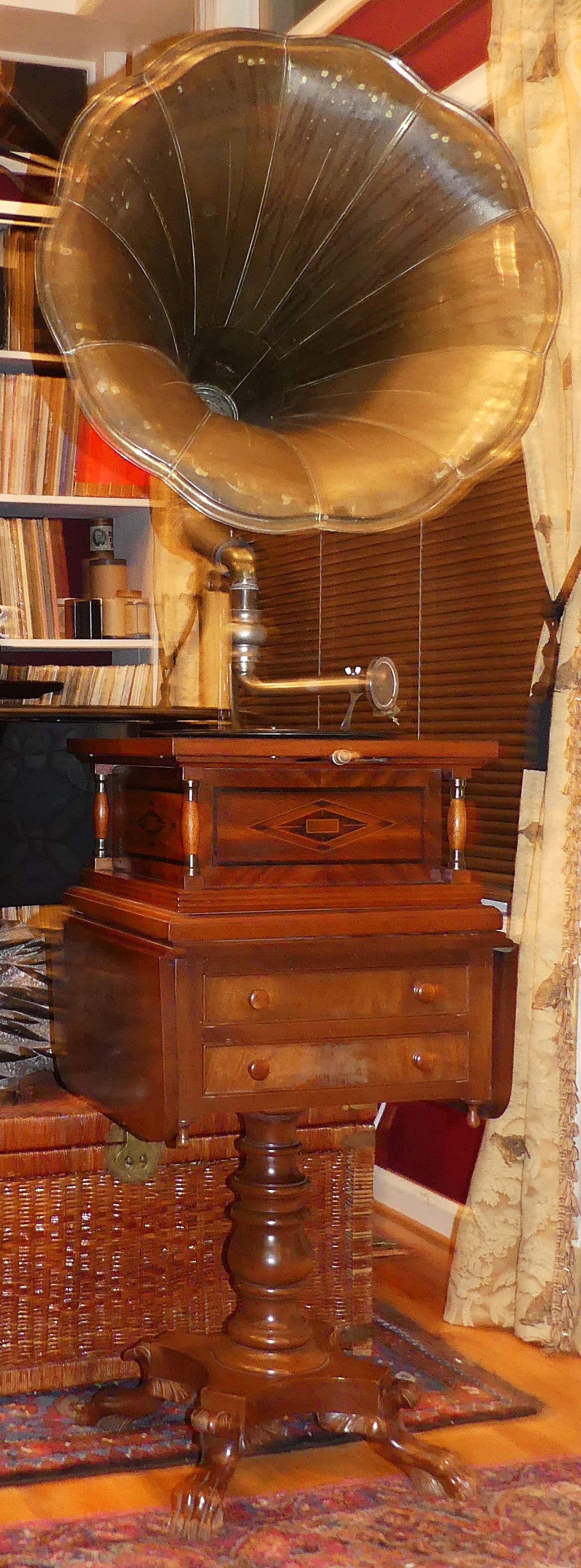

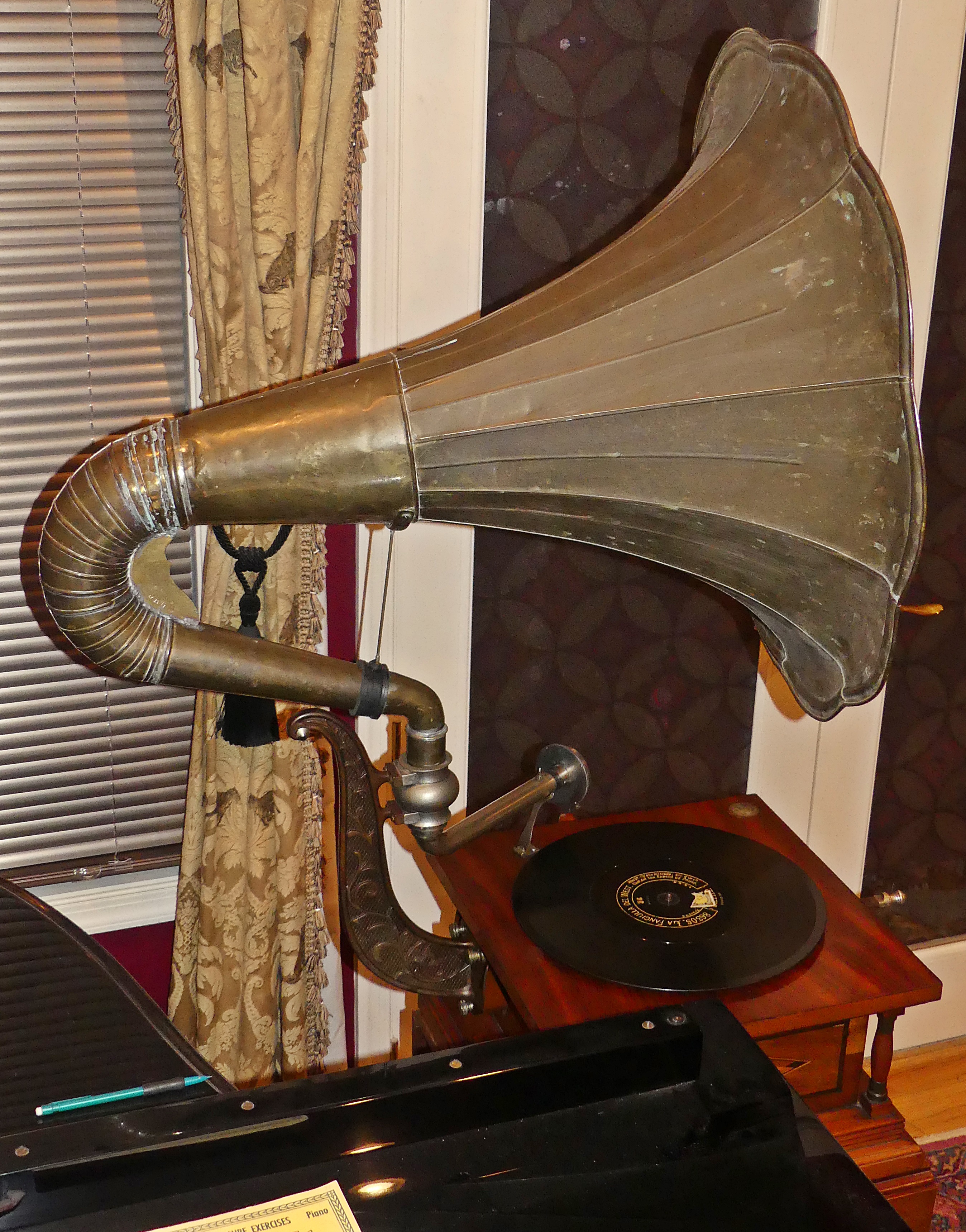

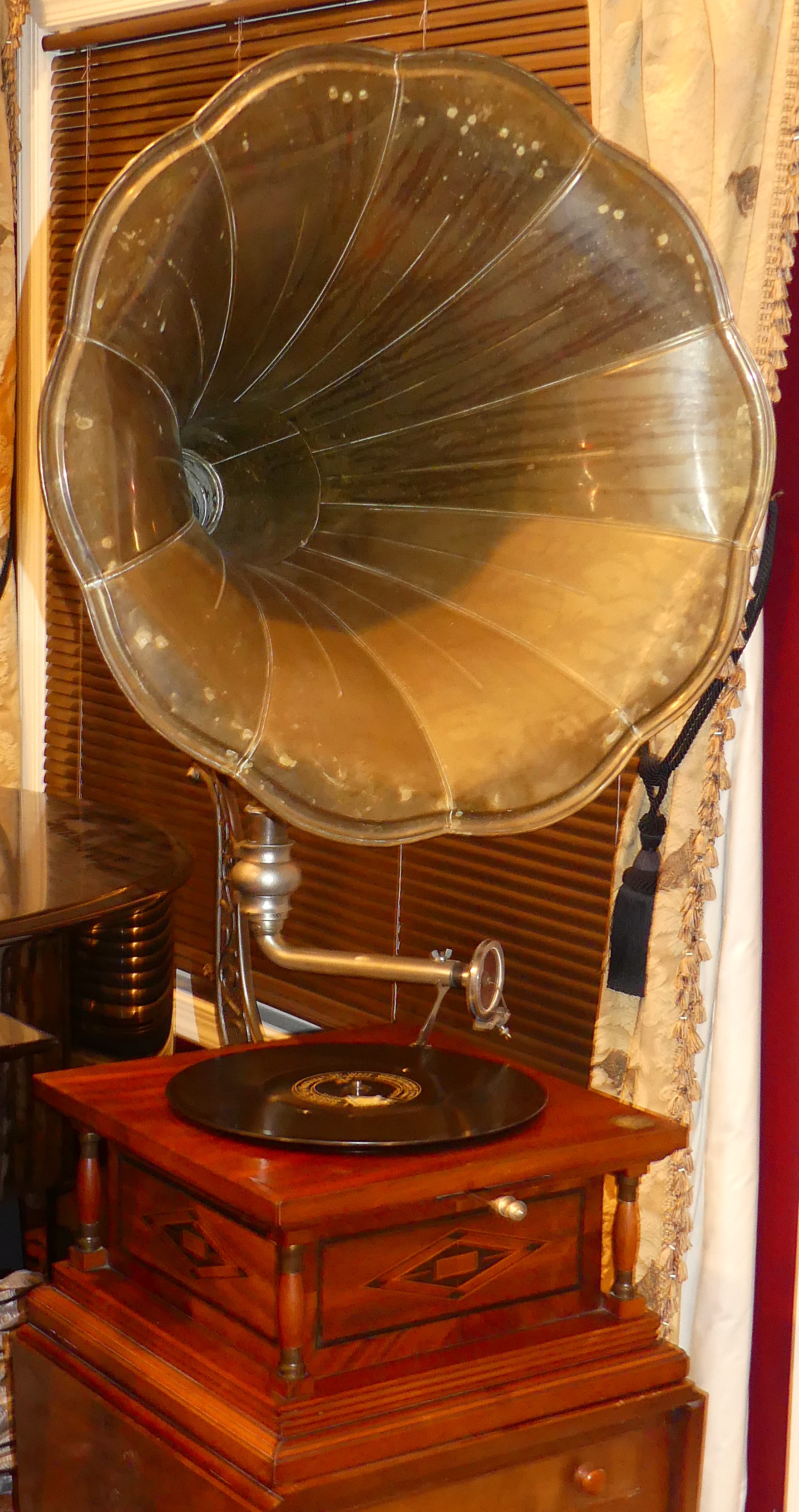

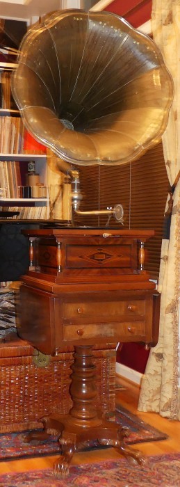

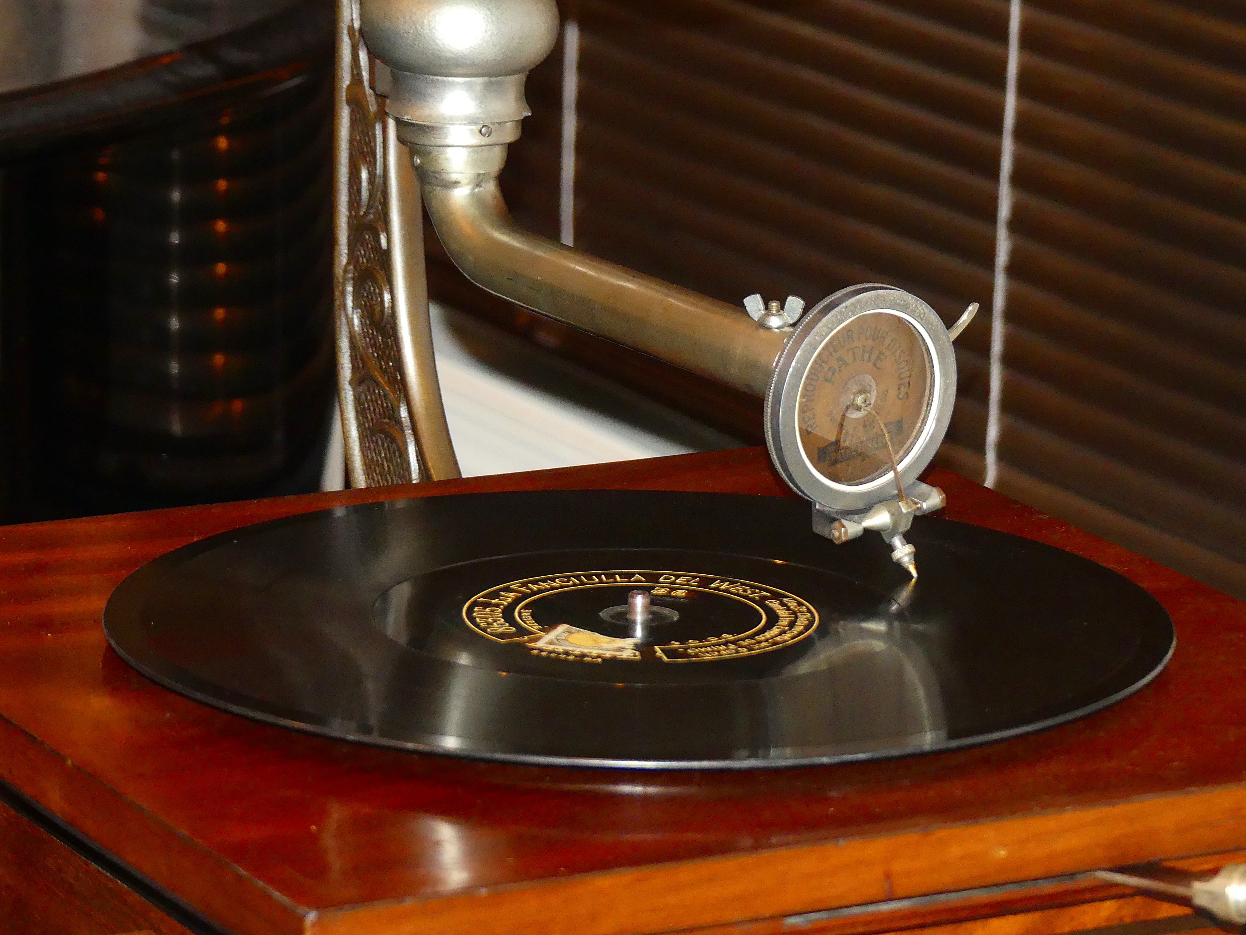

Last night and, to a lesser degree, tonight I've been enjoying a new member of the phono phamily: a Pathé Concert Model 20 open-horn machine. Phorum--uh, forum member kendphono overhauled it for me (thanks, Ken!), and it sounds really wonderful. With the right disc, LOUD, too. At long last, I have a proper machine for playing my 14" Pathé discs, and what a pleasure not to be standing nervously over a different-branded player with adapter waiting to jump and grab the tonearm if (when) it starts to skate. That straight arm does seem to track Pathé's wide, shallow grooves much better than an offset arm, like a Victor arm with adapter, manages to do.
The horn is German, not original to the machine, but of the same period and appropriate to it. To be honest, I prefer the "cygnet style" of this horn to one that would stick straight out into the room, and as noted it makes a lovely sound. I've commandeered my grandma's sewing table, formerly supporting my Victor V, for a stand; it could have been made for the Pathé, or vice-versa; the table top is exactly the same width as the machine's base and only about ¼" deeper. The Victor now lives on a rather austere side table, painted black, that to be honest probably suits its lines better.
Ken added a lower fitting for the strut between the upper and lower halve of the horn; that was missing, and it's needful to support the heavy upper portion, which otherwise tends to overstress the joints in the bend. He also fabricated a piece that was missing in the lever start mechanism--as a device, the lever thing is something of a Rube Goldberg contraption, but it does its job. Pathé is always different! He also refurbished the reproducer, which had a full set of completely dead original gaskets; cleaned and lubricated the motor; and polished some of the metalwork, which was heavily tarnished. Luckily, the spring grease apparently had already been replaced recently enough that it was still good, sparing us the necessity of removing that powerful Concert grade spring. Net result: a machine that sings and one happy phonograph owner.
Forthwith, some photos (the record is a 14" disc for scale):

Beautiful machine. From reproducer to the mouth of the horn looks to be four feet or more.

Very nice machine, congratulations! Just be careful with the interface of the horn: the ball is pot metal (zamac for Europeans), really thin and can crack under the weight of the horn if it is not well balanced and exerts force on the sides of the connecting tube.

Thanks for the warning. I wonder if the cygnet-style horn might be a good choice in that regard, as it would balance the weight more down in the center than twisting around an axis at the rear?
