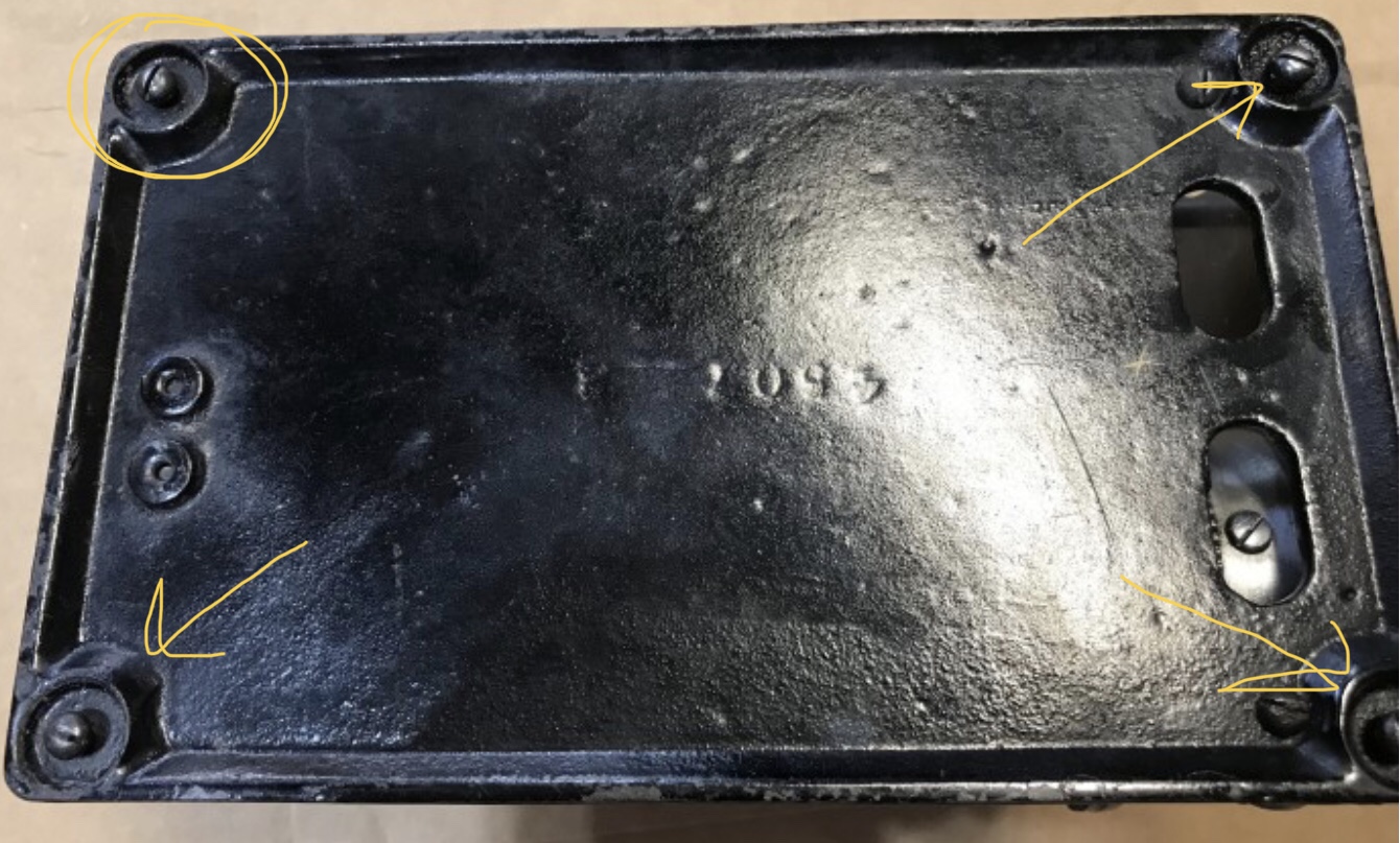

I’ve been looking for 4 feet, (pads) for my Columbia Q.Maybe I just don’t know where to look? Anyway,
It’s for the black base Q, without the wood case..
Has anyone made them and would like to share how it was done?

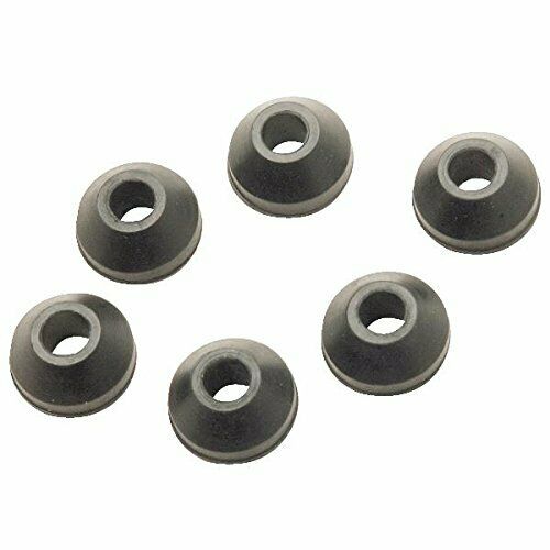

hardware store,, faucet washers work great. they have many different sizes.
blizz

fmblizz wrote: Tue Feb 22, 2022 10:53 am hardware store,, faucet washers work great. they have many different sizes.
Update on this in a few days, I bought some faucet washers.

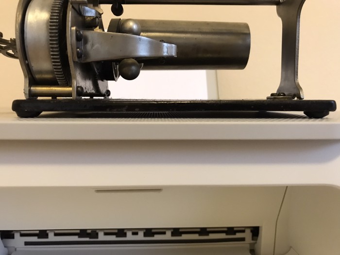

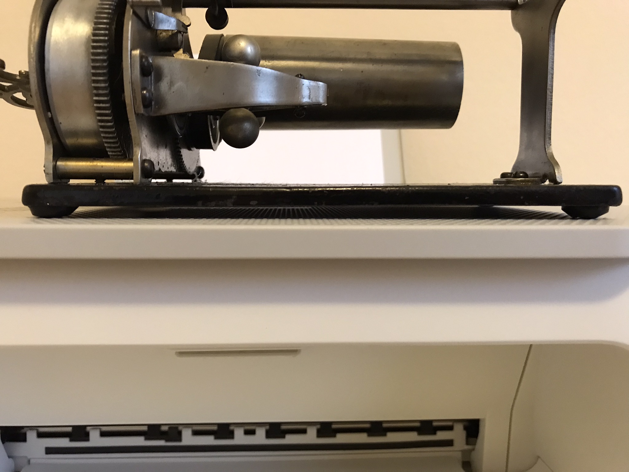

Re: Columbia Q Feet,
Post by columbia1spring »

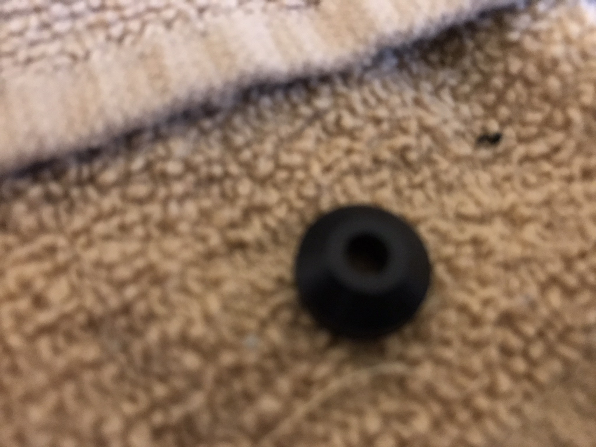

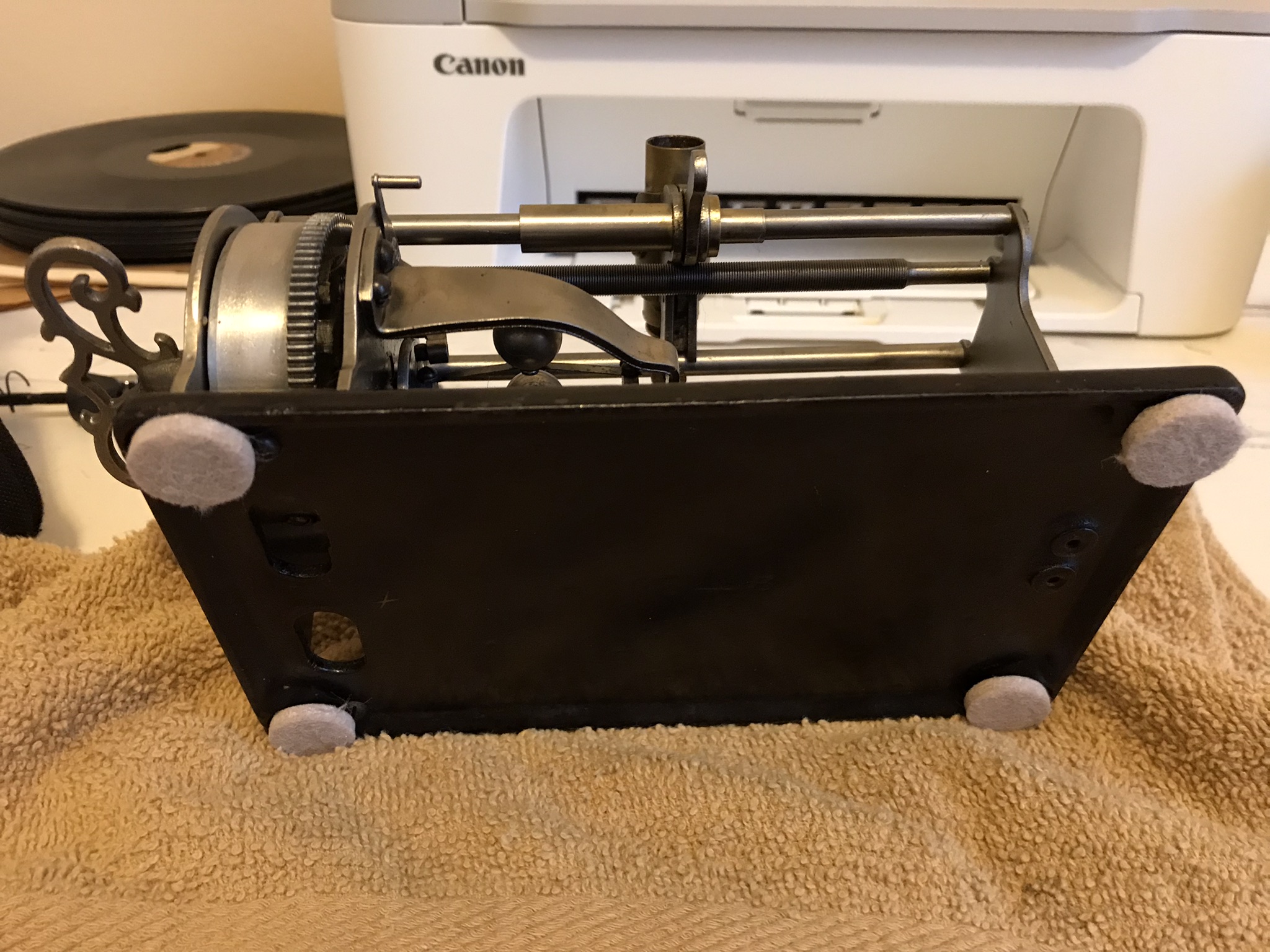

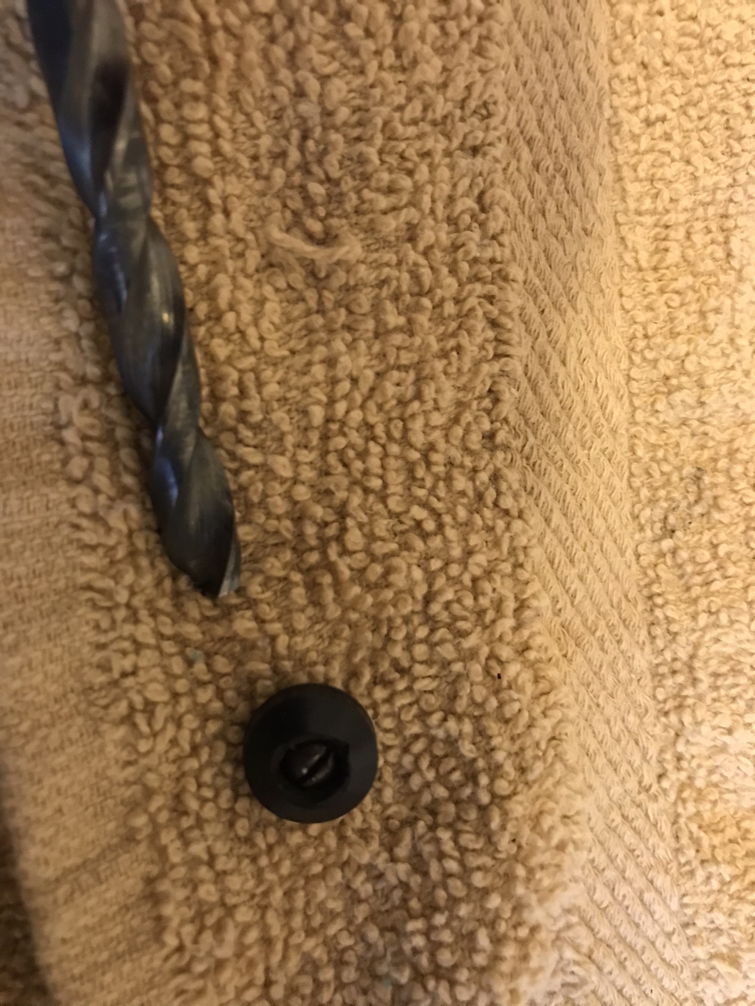

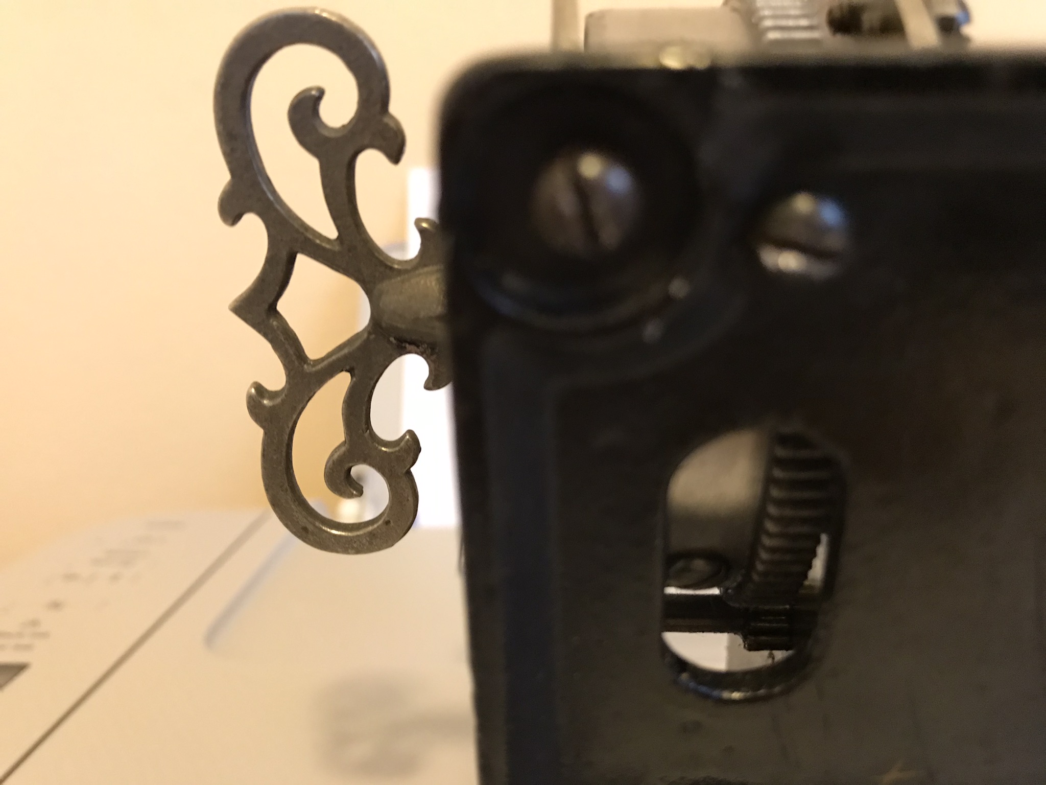

Ok...
I bought ¼” black faucet washers, drilled ½ through so the screws were recessed.
Original? No!
But the felt pads look like crap and the machine slides when winding.
No felt pads? Then it damaged the table.
Reinstalled the screws with the faucet washes, looks nice! And it no longer slides around and no more table damage!
Thanks Blizz.
