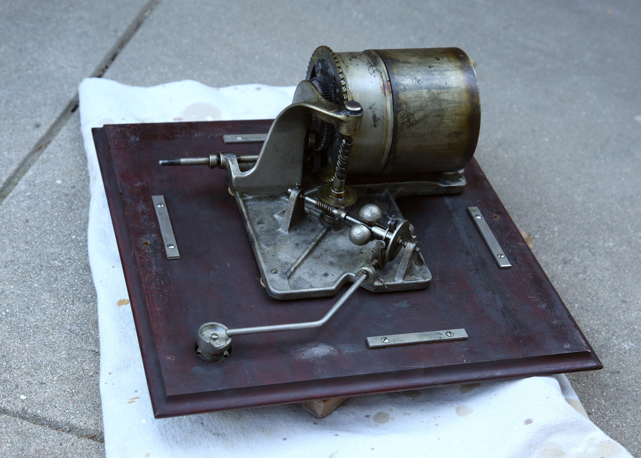

The turntable is cast. The motor board looks like a fugitive from an outside horn machine. The two mounting screws are mis-matched. The one on the left is nickel, the one on the right is blued. I wonder what what was used originally?

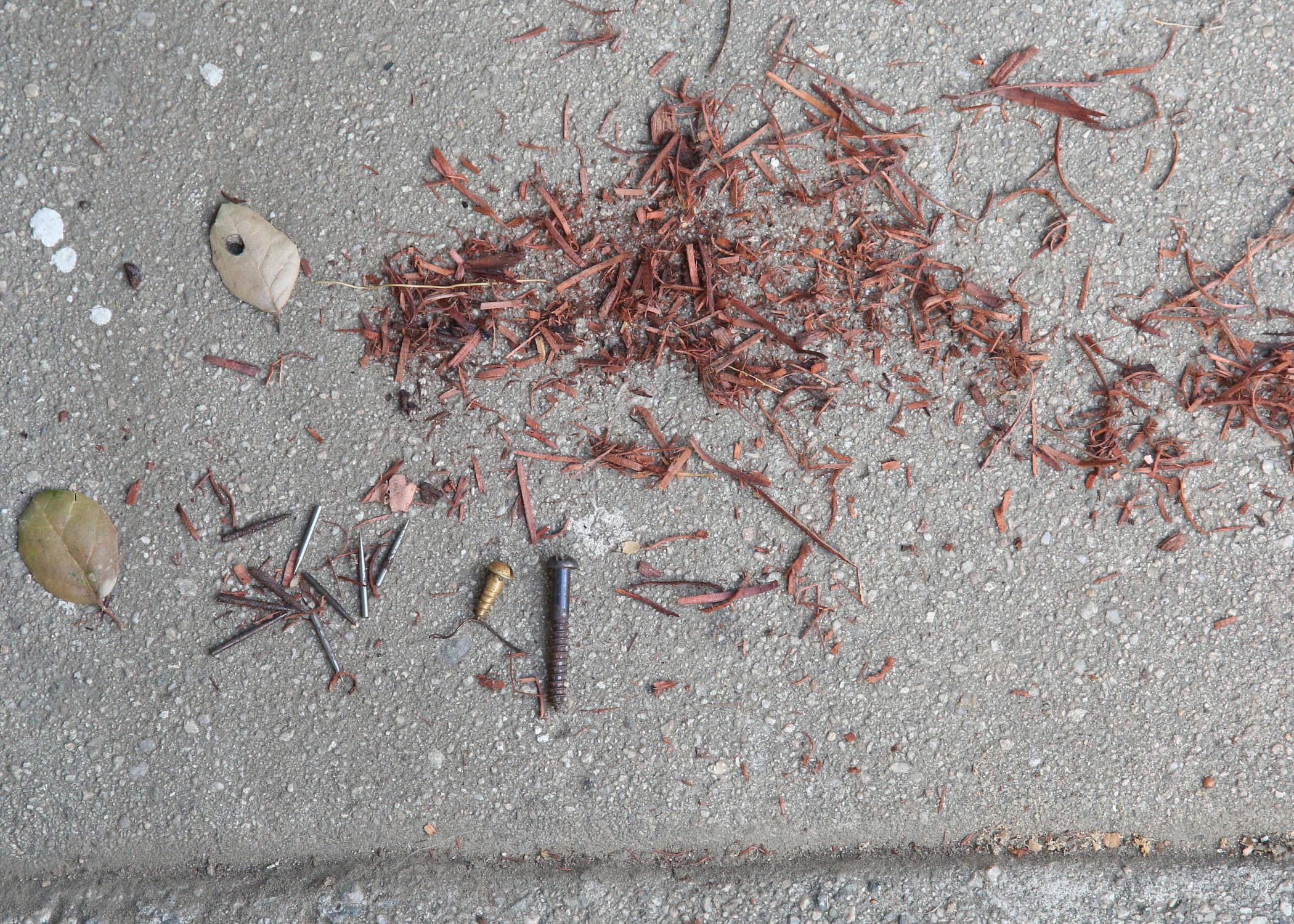

Here’s what I found in the bottom of the back of the case: many mahogany shavings, rusty needles, a gold plated screw (from the lid prop escutcheon) and another blued wood screw (for the motor board?).

Here's the motor.
