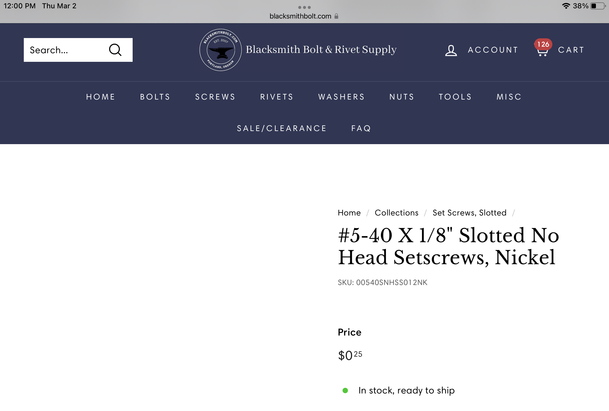

Re: WANTED: Victor Arm pin set screws
Posted: Thu Mar 02, 2023 12:03 pm
by MarkELynch
While searching for wood screws for a Gibson mandolin restoration I saw that the supplier also listed slotted 5-40 x ⅛” nickel set screws. 1/32” shorter than the Victor spec but a viable option.
https://blacksmithbolt.com/collections/ ... ews-nickel
