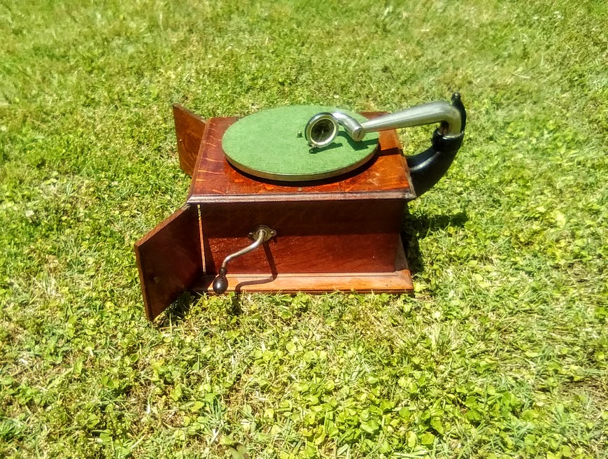

Posted: Mon May 01, 2023 1:37 pm
by VanEpsFan1914
Just installed fresh felt--scraping the platter with a razor blade for awhile, until it was smooth, & then cleaning it up with a wirebrush on a drill press worked pretty well as it was rather rusty. I took a photo but it came out blurred--so instead of taking more photos I went to it & started freshening up the machine.
Reproducer is "rebuilt" too, but I forgot to order a thumbscrew & managed to shear off the pin on the back of the new flange when installing--it snagged in the notch in the gooseneck tube & sheared off like candy--that was not good; Mr Parlier is making these things now with the absolute best rubber I've ever seen on an Exhibition back flange. But as I need to order another bearing for an Edison phonograph & get the thumbscrew I need, plus change the ball-bearings in the race at the back of the taper tube (why is there always one missing?) I think I'll have fresh parts before terribly long. Most unfortunate though to break off a perfectly good piece of brass in there & not be able to change it.
Looks nice anyhow--and the light green looks very nice with the light quartersawn oak. I've had this Victrola since 2020 I think and it's never really gotten much use. This tiny little guy is every bit as much a genuine Victrola (high quality, nice workmanship) as the massive VV-XIV that I usually listen to (which is currently getting an oil change as it was last overhauled in 2016.) I'm definitely keeping it around; it is a fun one to have.

Re: Light or dark green felt for 1917 Victrola VV-IV?
Posted: Mon May 01, 2023 1:42 pm
by Flying Dutchman
I think it looks fantastic! It certainly is amazing how outside natural light can change the look of a finish.
