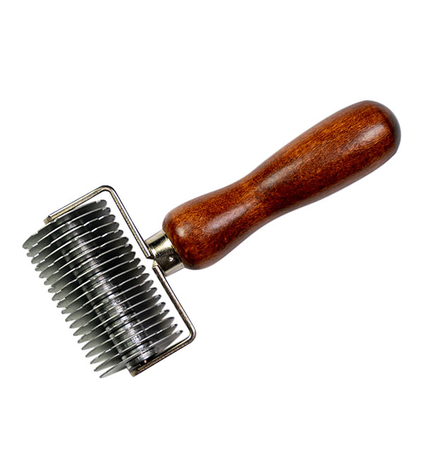

Danny Arms was a master wood grainer... unfortunately there is no good way to contact him, since he died a number of years ago. He explained his process to me, but I have never tried it. There are videos on YouTube showing the procedure - it's not terribly difficult, but takes practice and the right tools.
You need good quality metal graining combs and a check roller to start - not the wide rocker tools.

Here is a cheap, simplified technique that would work fine for your horn. Just try to match the colors to the wood portion.
Remember - you can't ruin it (it already is) and you can re-do it until you like it...
https://www.youtube.com/watch?v=CIZZfzCVmLo
PS: My previous comments were tools for oak graining - mahogany is easier since it is fine straight grain...
Here is another video:
https://www.youtube.com/watch?v=_6a6_4j7ZuM
