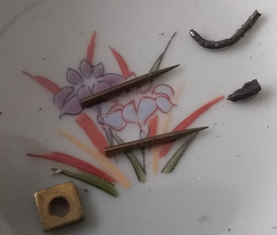

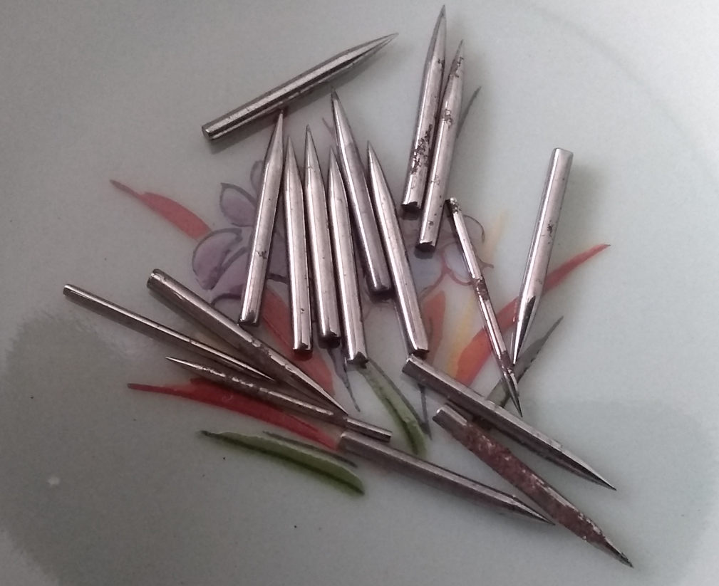

What fell out of the case while working on the leather:
A collection of used needles of varying tones and manufacture, some used to an alarming degree. One of the soft tone needles I will add to my collection because the tip is so worn that it looks like a drift guide blade for a microscopic slot racing car.
Less common items: two used needles that appear to be bronze, a small brass nut, a curious badly corroded small bent piece of metal, and a burnt-looking piece of something organic, perhaps wood. Were there bronze needles?

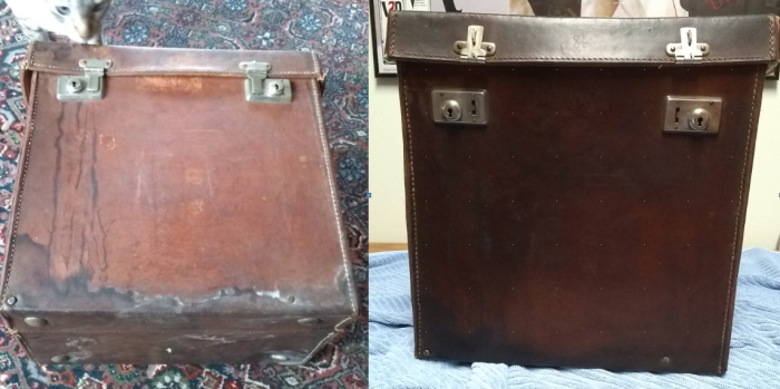

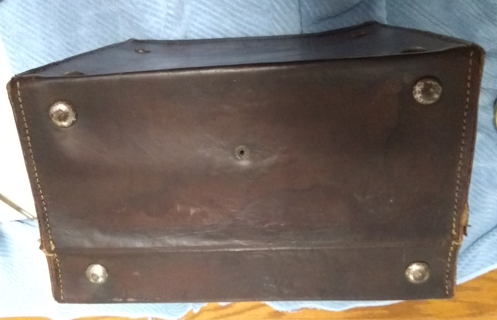

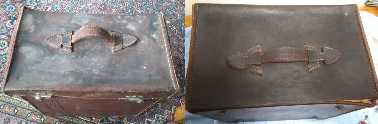

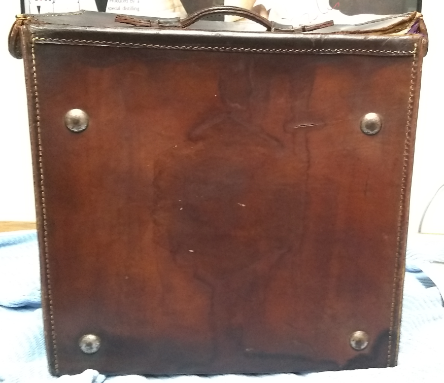

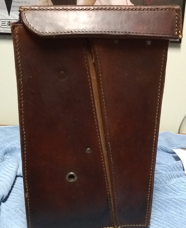

The Case Before and After
I am not finished with the case yet. I need to get another secondary restoration product, I think, a leather balm.
the rest of the case shows similar improvement.

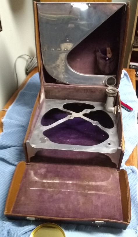

I would like to get the aluminium frame out of the case so that I can re-block it and try to get the warping out of it now that it is more pliable.
It appears to be held in with two split rivets on the sides at the front and with one screw at the back. I am struggling with the rivets at the moment.

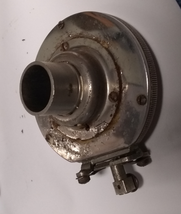

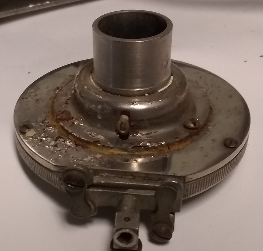

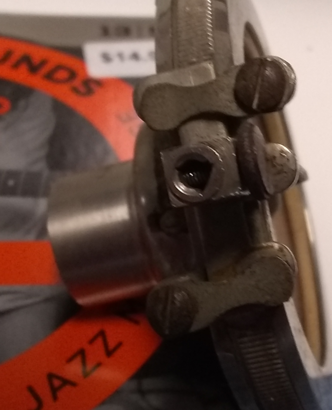

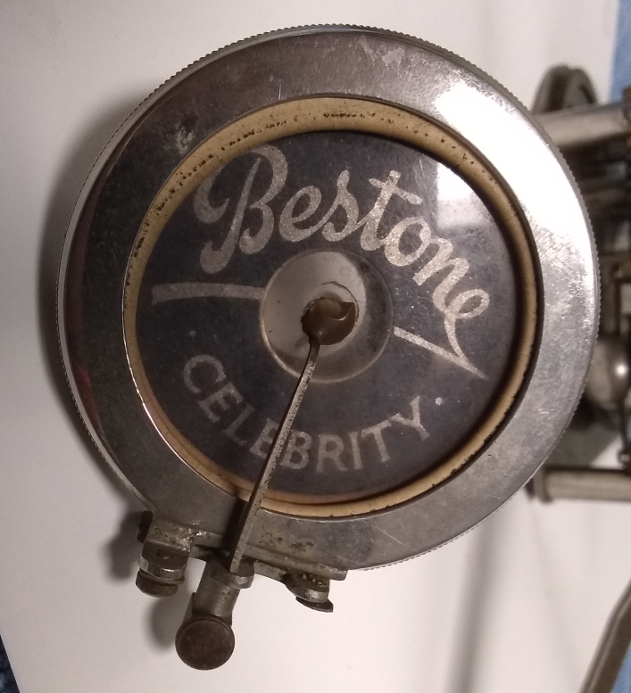

The Reproducer
The mica is loose in the reproducer because the gaskets have disintegrated. It looks like I might be able to save it.
The front of the reproducer doesn't look too bad, but the back is a bit of a dog's breakfast.

Re: Started on the Roberts Bestone
Wow, what a change in the appearance of the case!!! It looks fantastic
Lah Ca
- Posts: 1414
Thanks. And I hope it will look better, yet.Inigo wrote: Thu Jan 18, 2024 6:13 pm Wow, what a change in the appearance of the case!!! It looks fantastic

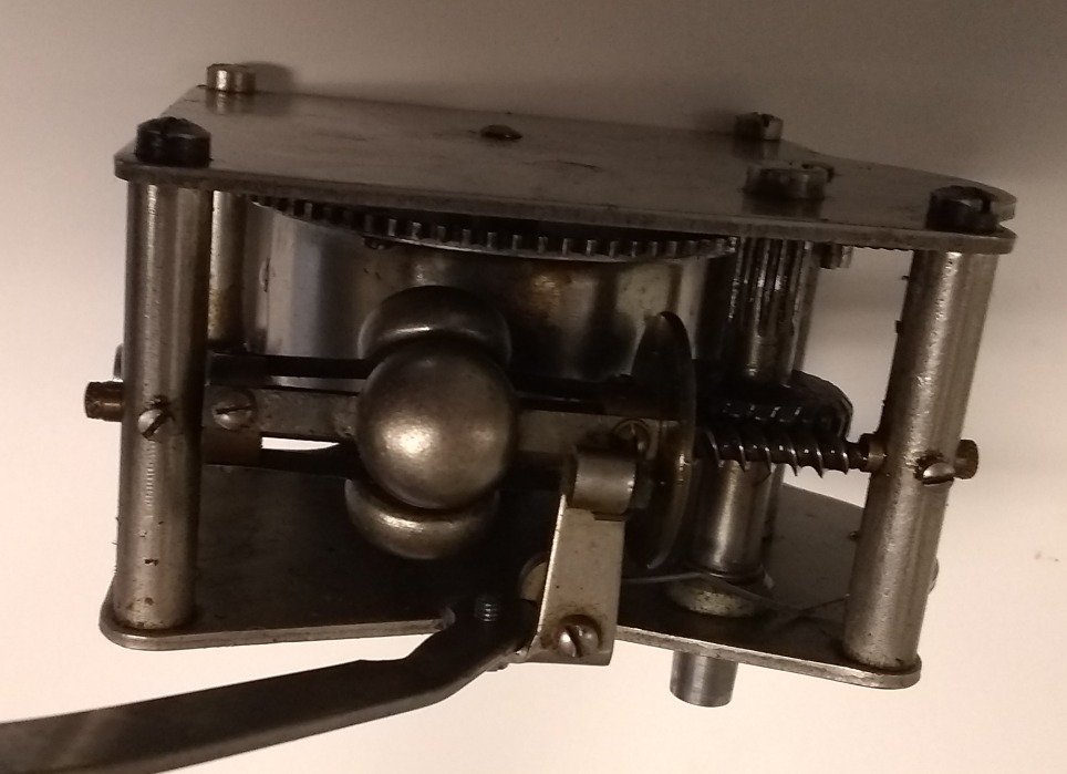

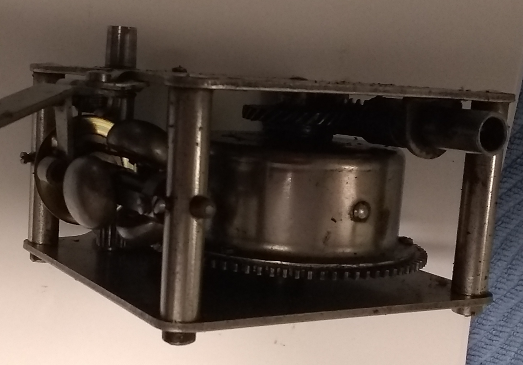

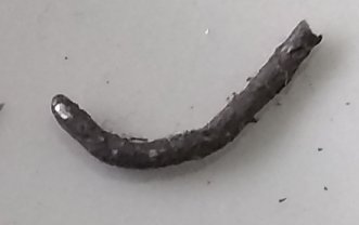

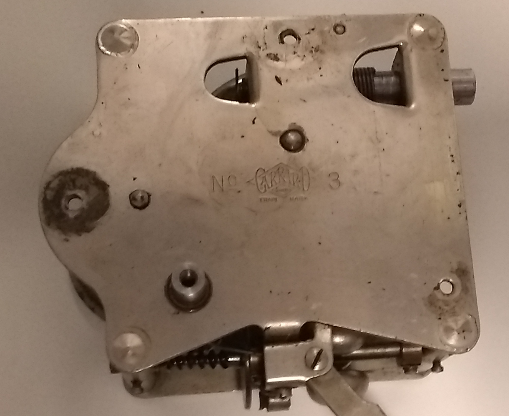

Well .. I know what this is now:
It is the end of the non-return spring, I think. For purposes of testing, I managed to uncoil a small part of the broken non-return spring and lock it under the screw down tab that holds it in place. It probably won't stay there.

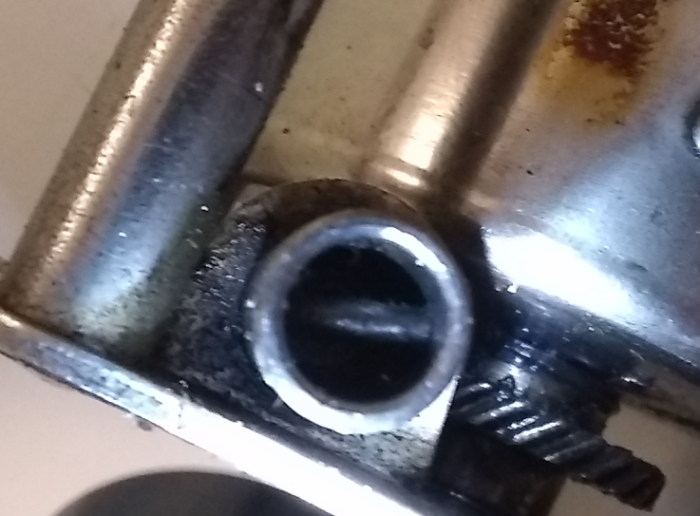

I also know what this is:
It is one of the nuts that holds things together, the speed control, the brake, the aluminium platform/motor-board (at the back of the case). Since none are missing, I assume that this one got left, wedged into a corner, in the case during assembly.
