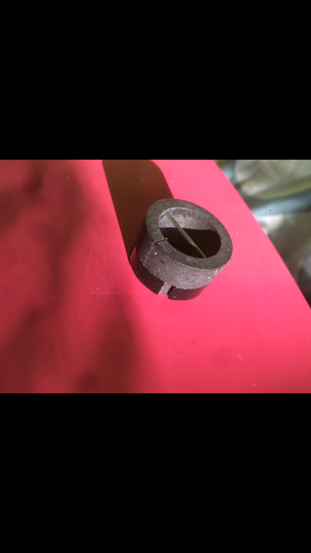

I suspect you are missing this part. It fits tightly on the spindle and the toy mechanism fits into it.
Contact Yamaphone on this forum; he makes them
I got a couple from him to fix my neighbours’ toys.

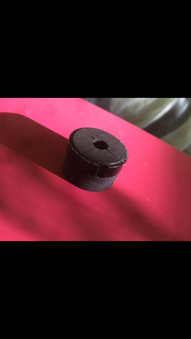

Posts: 200
Re: PHONO TOY KEEPS SLIPPING OFF SPINDLE
Post by Hoodoo »
Meant to attach this photo as well.
Curt A
Posts: 6892
Post by Curt A »
Yes, that is a necessary part. Brian Parlier at: thephonographshop.com makes them.
