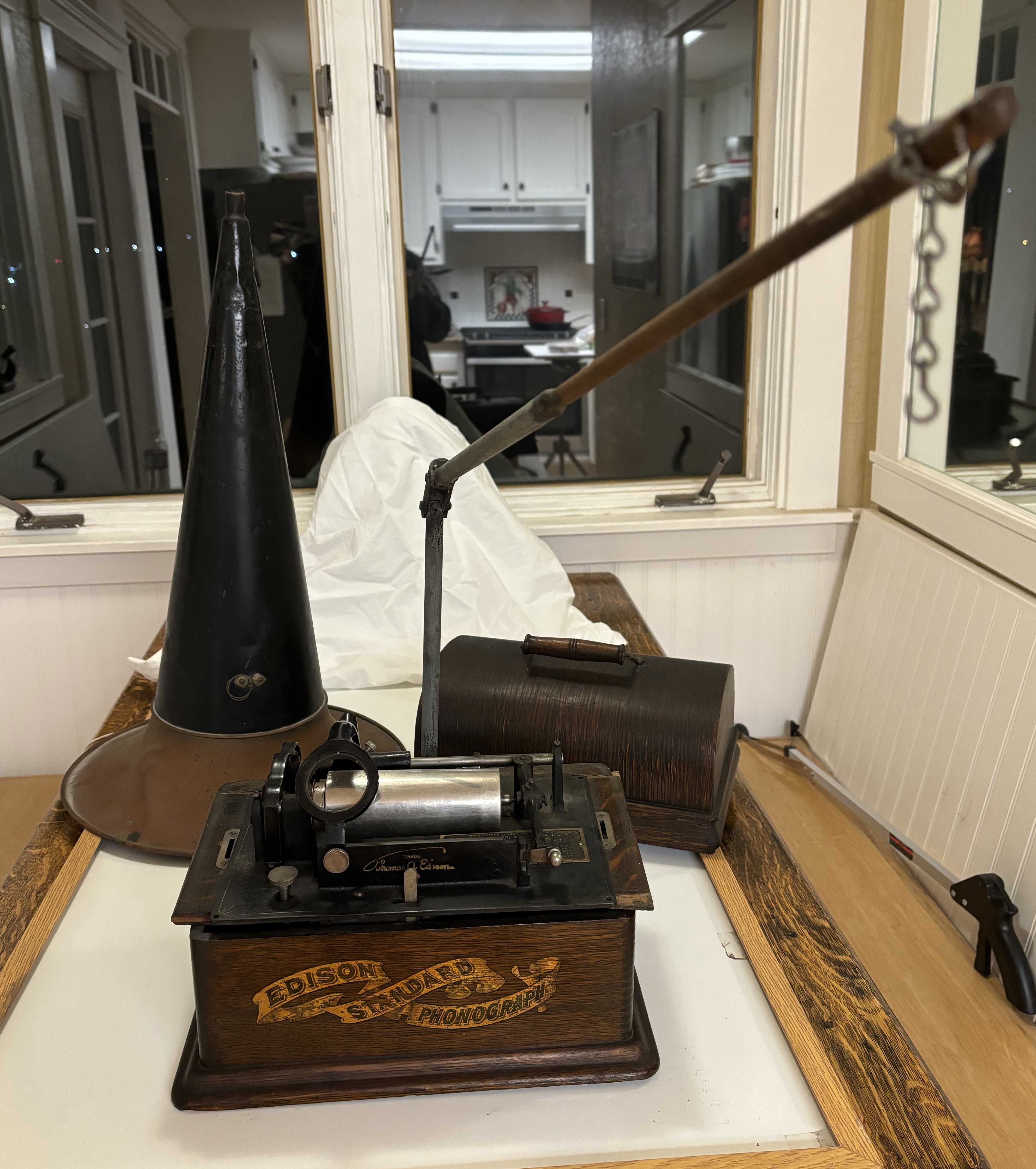

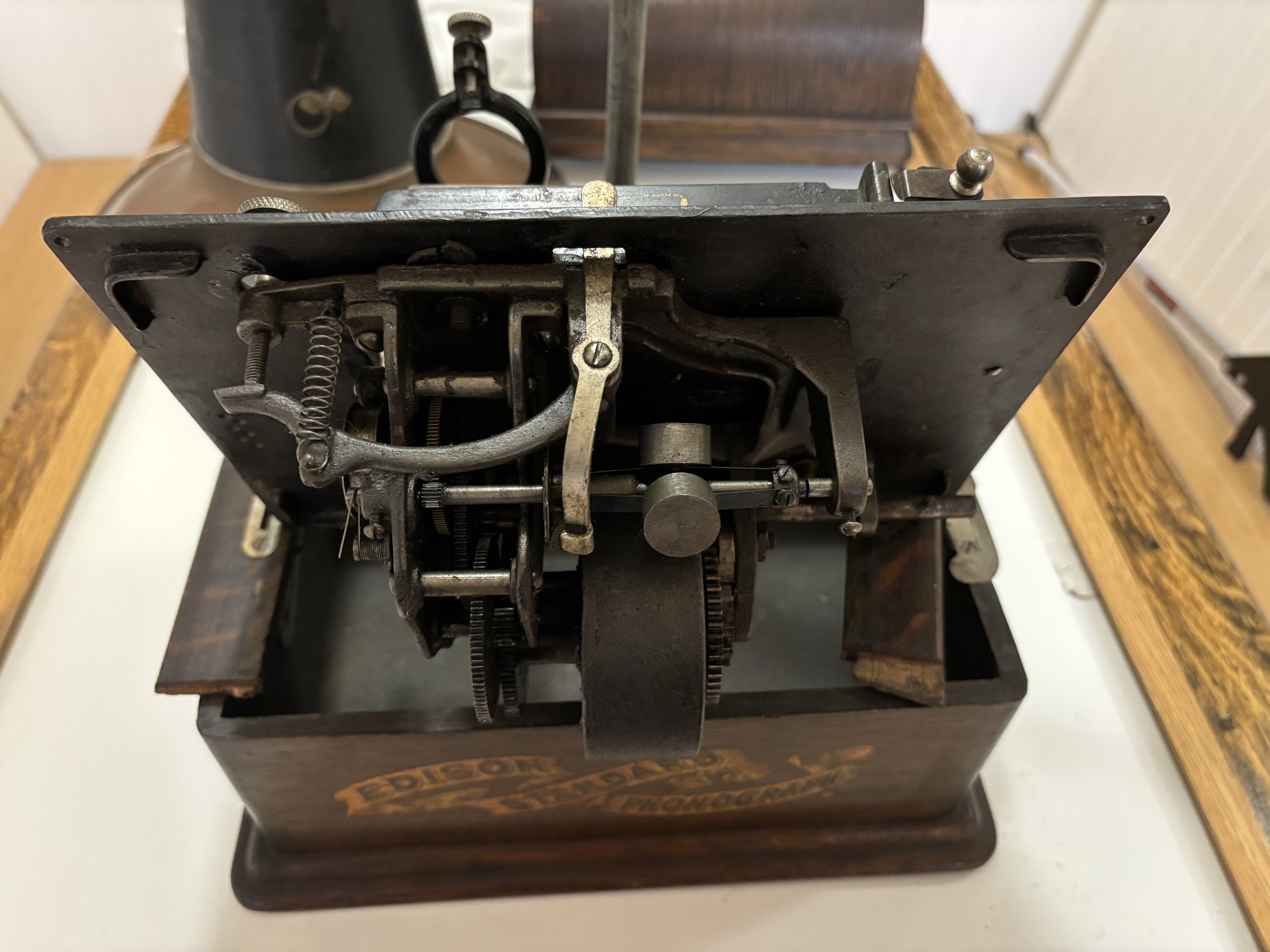

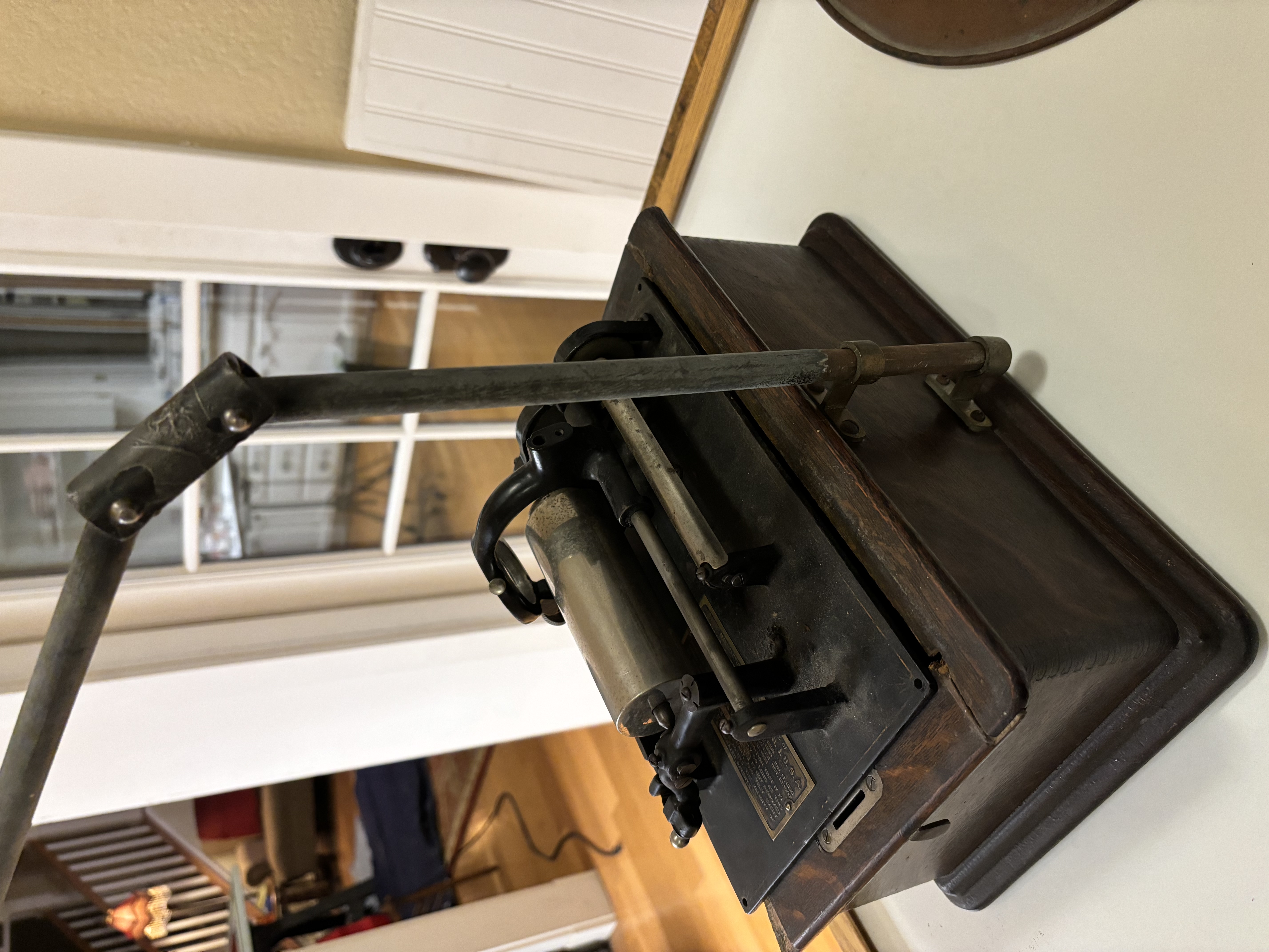

A friend recently gave me his Edison Standard. I’ve been trying to figure out the model and year without luck. The crane on it and the reproducer are throwing me. Was the crane added and the reproducer replaced? Without a belt it runs for about 8 minutes. Any help would be greatly appreciated. The serial number is S117411.

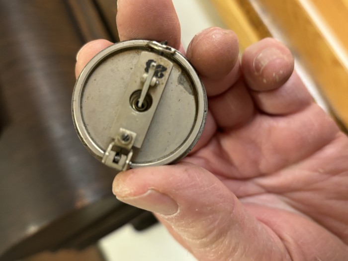

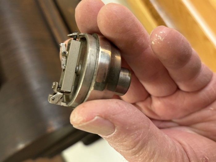

You have a nice looking Model A Edison Standard from around 1902/3. George Paul can give you a more accurate date. Your machine plays two minute cylinders. It was sold with a 14" horn with a black body and brass bell. It was common for owners to upgrade to a larger aftermarket horn and yours is an example. I believe your reproducers comes from a later business machine and is not correct. You should be able to locate a C reproducer which will give you good results. The Edison Standard was a very popular machine and sold in large numbers because it gave owners good performance. Welcome to our hobby. I hope you enjoy your Standard.

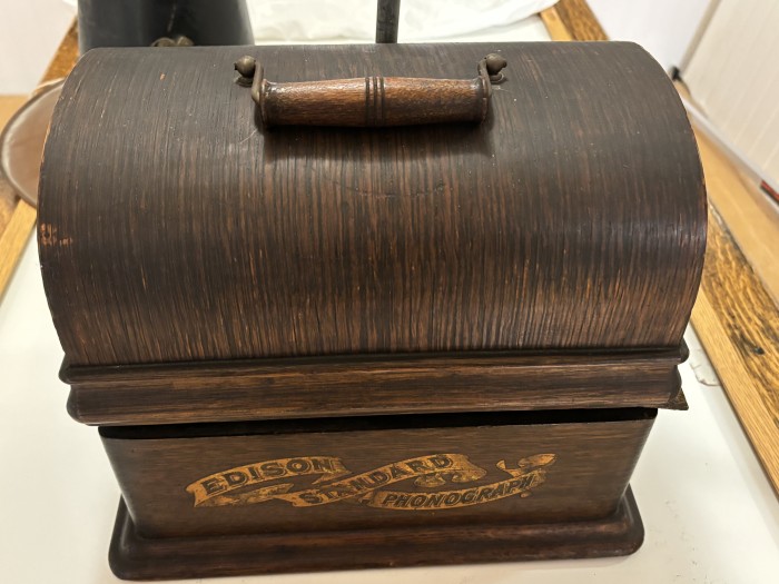

Frow has this to say: "By 1901 the Standard was equipped with an oak 'New Style' cabinet with a rounded cover. The motor was unchanged, but the top plate now screwed on to a wooden frame which was hinged for inspection. This new style of case also carried the full EDISON STANDARD PHONOGRAPH banner, and its moulding and corners were rounded, and from the Autumn of 1901 Standard owners could buy this for $3.00 and modernise the look of their machines."
I agree, the reproducer appears to be from a dictating machine. Cranes could change at any time at the whim of an owner who wanted to "upgrade."

Edison Standard #117411 left the factory in October 1903.
A Model C Reproducer, crank, and wooden frame for a Standard Model A should be easy to find. You just missed one that sold on this forum:

The brackets on the rear of the cabinet are for a Hawthorne & Sheble No.4 horn support. The rod sections are homemade. If you want originals, just advertise for them in the Yankee Trader section.
