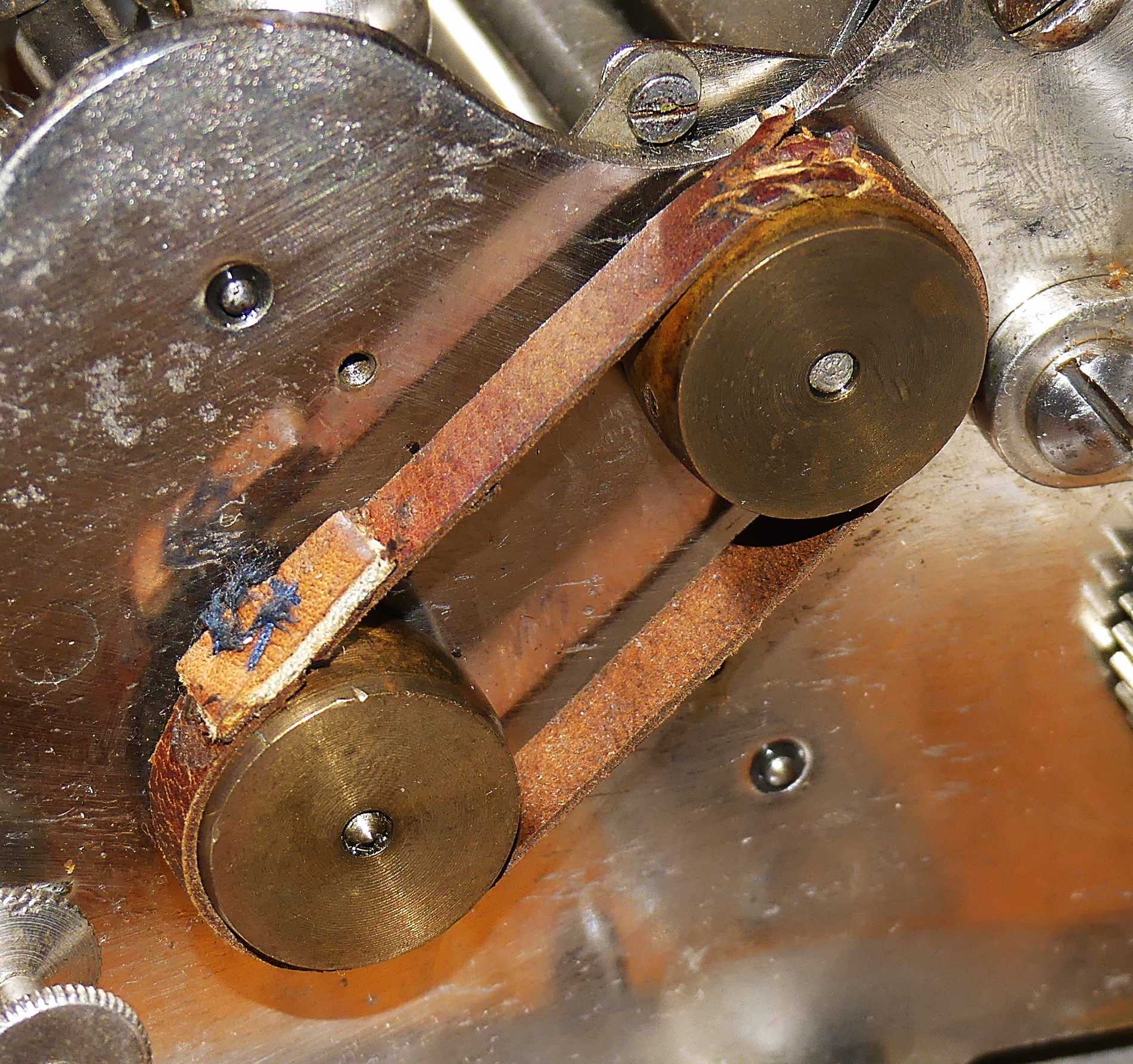

Now, a question. Its belt is shot--it's frayed; it's crudely patched; and, not surprisingly, it slips badly:
As things stand, the machine really isn't a useable player, but I'm pretty confident a new belt would resolve its issues. Anybody know where I could readily get one already made up?

You can make one for it yourself. There needs to be a fitting done - it’s not really very feasible to make measurements for someone to try to make one for you remotely.
Get some belting material or a piece of supple leather, cut a strip of the right width, and a little longer than needed, then slice each end to a flat taper. Then check for fit, make any adjustments, and glue the ends together with contact cement.

Cool machine! I agree, measuring and cutting a belt is pretty straight forward. All you need is the leather belt, razor blade and some glue. Get some extra belt as the first try or two might not work out right. It’s surprisingly simple and oddly rewarding too!
