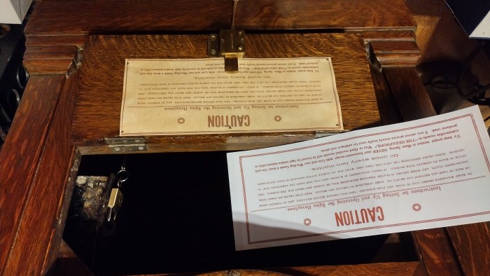

Recently bought a replica instruction sign to go into my 1916 Hexaphone. Shaun O'Rourke sells them in either white or aged look. I got the white one. I located some slim cardboard stock to use for the sign. To "age" it I soaked it in a strong solution of tea about 30 seconds. After removal and rinsing when it was almost totally dry I ran it though the ink jet printer....looks really good. I assume the same could be done for labels and other products. Try it and see for yourself. James. Manker. Sorry pic posted upside down....oh well.

After aging and printing with an inkjet printer, spray it with a matte UV preservative, like Krylon to keep the ink from fading or running.
White printed paper can also be aged with a coat of Amber shellac.

Thank you Curt....good tips

I am struggling with the opposite problem, trying to de-age and save foxing, self-disintegrating paper artefacts.
For the ageing/artificially-foxing of labels, I would suggest starting with acid/lignin free paper stock. I would get some litmus paper and check the pH of the ageing solution and use a mild acid or alkali to get it as close to neutral as possible. Your labels should then last longer than the originals.
