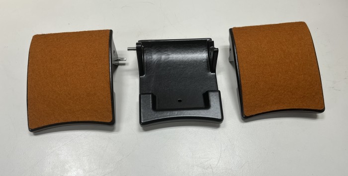

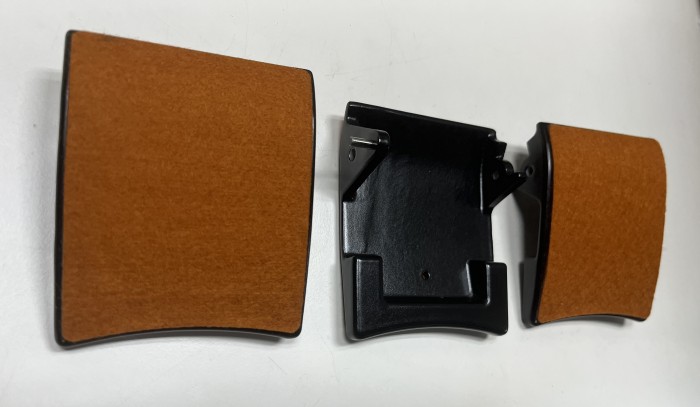

Preparing a few more new lift pads last night for the 10-50 Potmetal Elimination Kits we designed to help the collecting community.
The Lift Pads are a perfect fit and are made from aluminum with a baked-on black semi-gloss powder coat finish and stainless steel lift pin.
We imported the 100% wool felt from Holland after an extensive worldwide search for the right material. Victor used all-wool felts not the wool blends offered by others. The color is a fairly close match to the original.
The felts are laser cut for an exact and consistent fit.

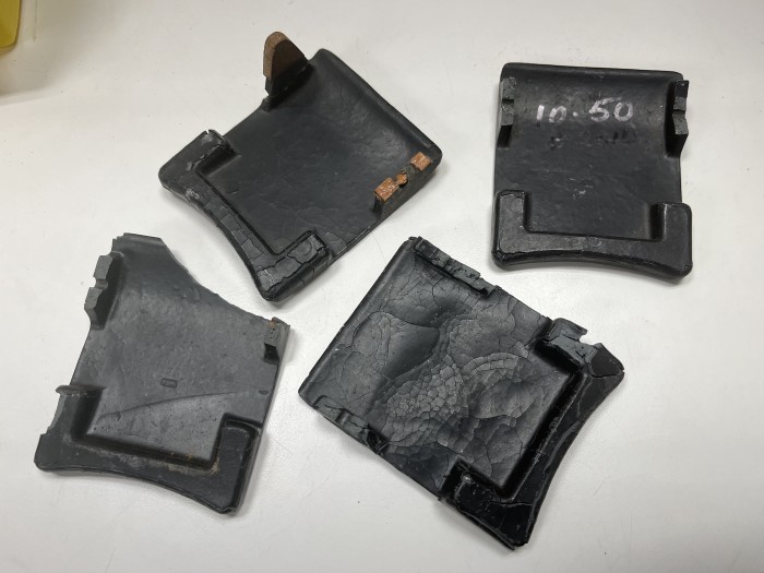

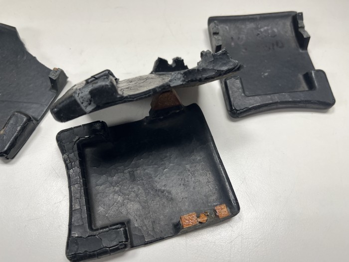

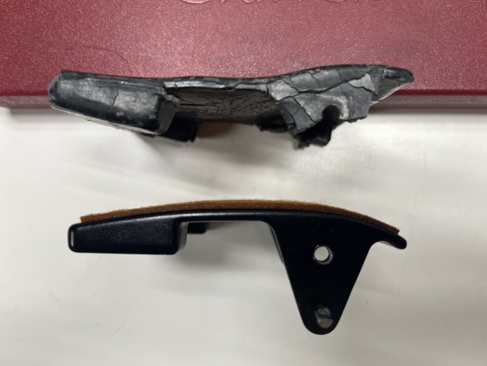

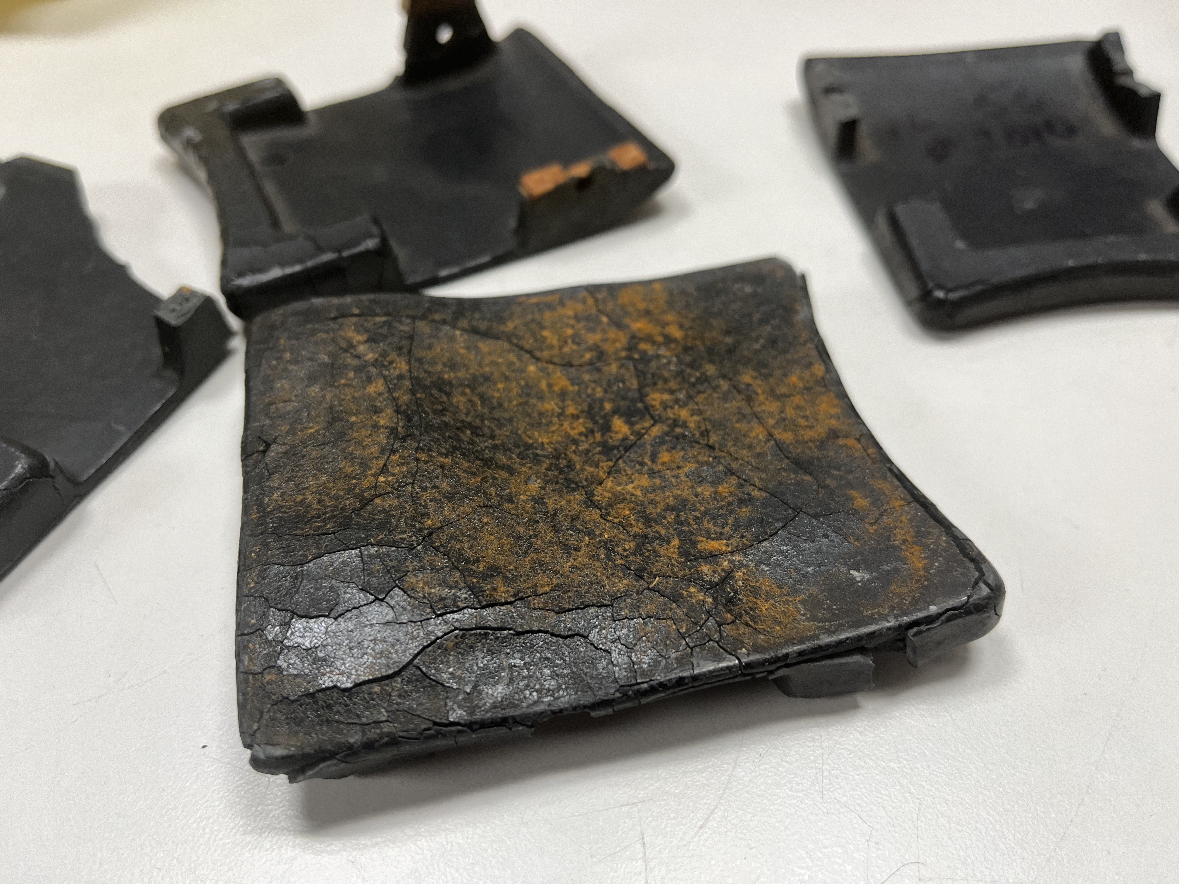

For those not familiar with this part it is one of five key components in the Victor Automatic 10-50 and is responsible for removing and replacing the record on the turntable. Now, ninety-seven years later, the originals potmetal parts are always bad and need replacement The potmetal material swells and cracks from internal forces, a feature not know at the time they were cast. Potmetal continues to expand and cannot be arrested. I have some changer parts that looked pretty good 25 years ago that are now horribly swollen.
Our Potmetal Elimination kits can make your 10-50, 10-70, 9-55 and 10-51 work like new again.
A few photos.
Mark and Bronson
An original swollen lift pad and the replacement for comparison. This original is so bad that the top surface is no longer convex!
A few other original lift pads.
