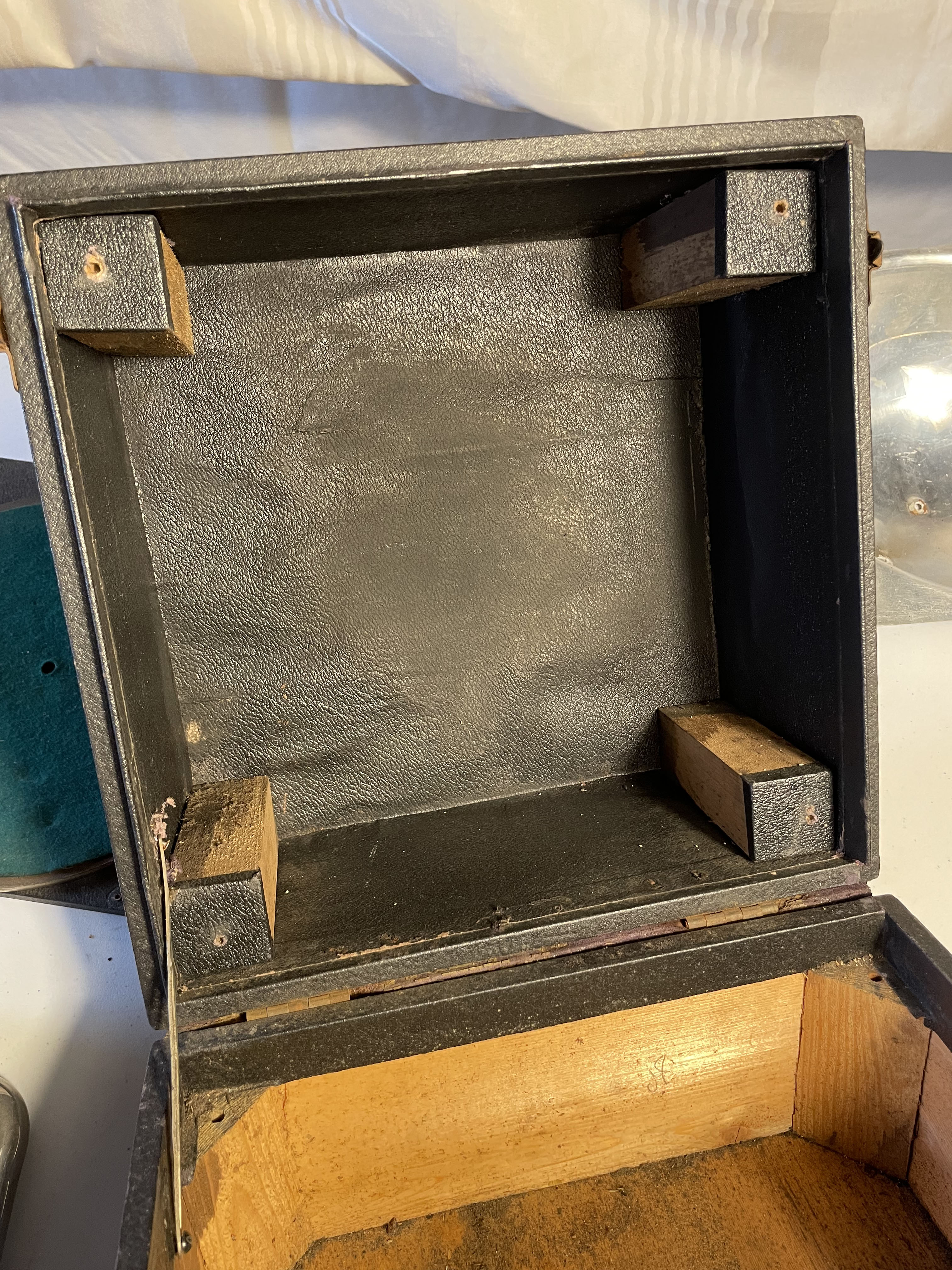

Ok, here are a few more details to share from this machine.
Oedipus mentioned that aluminum bowl (Dulciflex) machines were typically covered in maroon cloth (impregnated canvas, I assume, or possibly similar to Dupont Fabrikoid of the same era?)
Leather-covered machines had copper-plated bowls and black machines had black (oxidized?) bowls.
This particular machine has an aluminum bowl and what appears to be a black-colored impregnated cloth (or fine canvas) covering.
There are places where the covering has separated from the case showing a purple-ish color backing to the canvas cloth covering. Also, it appears that the case is wooden.
Here are a few photographs that show these details:

Interior of case lid - Dulceflex bowl removed

I considered whether this covering might have once been maroon colored and painted over in black after assembly but that doesn't seem to be the case.
This seems to be the original covering material and color for this particular machine.
