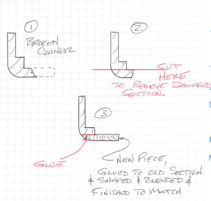

To my thinking, you do not need a new base/cabinet. The problem is that the 2 corner pieces have sections missing. Those corners need to be neatly removed. At that point, you have 2 options. 1.) make replacement corners. 2.) repair the existing corners.
Number 2 option:
(Why go to the trouble? Because I like to save as much original material as possible.)

JerryVan, Thanks for taking the time and effort explaining a good repair.

And thanks from me to. It would be a good repair if I knew how to shape wood. We'll see what I can figure out.

mjbarnes wrote: Thu May 23, 2024 10:55 pm And thanks from me to. It would be a good repair if I knew how to shape wood. We'll see what I can figure out.
You're welcome.
Careful use of a file and/or sandpaper, backed up by a sanding block, is all you really need to shape the new piece. Patience too...
It's made of wood. If it doesn't work, there's always more wood in the world to start over with. :)

Anyone with a table saw and some dado blades can make that.
The dado grooves are cut first from a piece of square stock, and then shaped to fit the cabinet with a hand plane and "blocked" sand paper.

The main problem is removing the old damaged corners to repair them...
