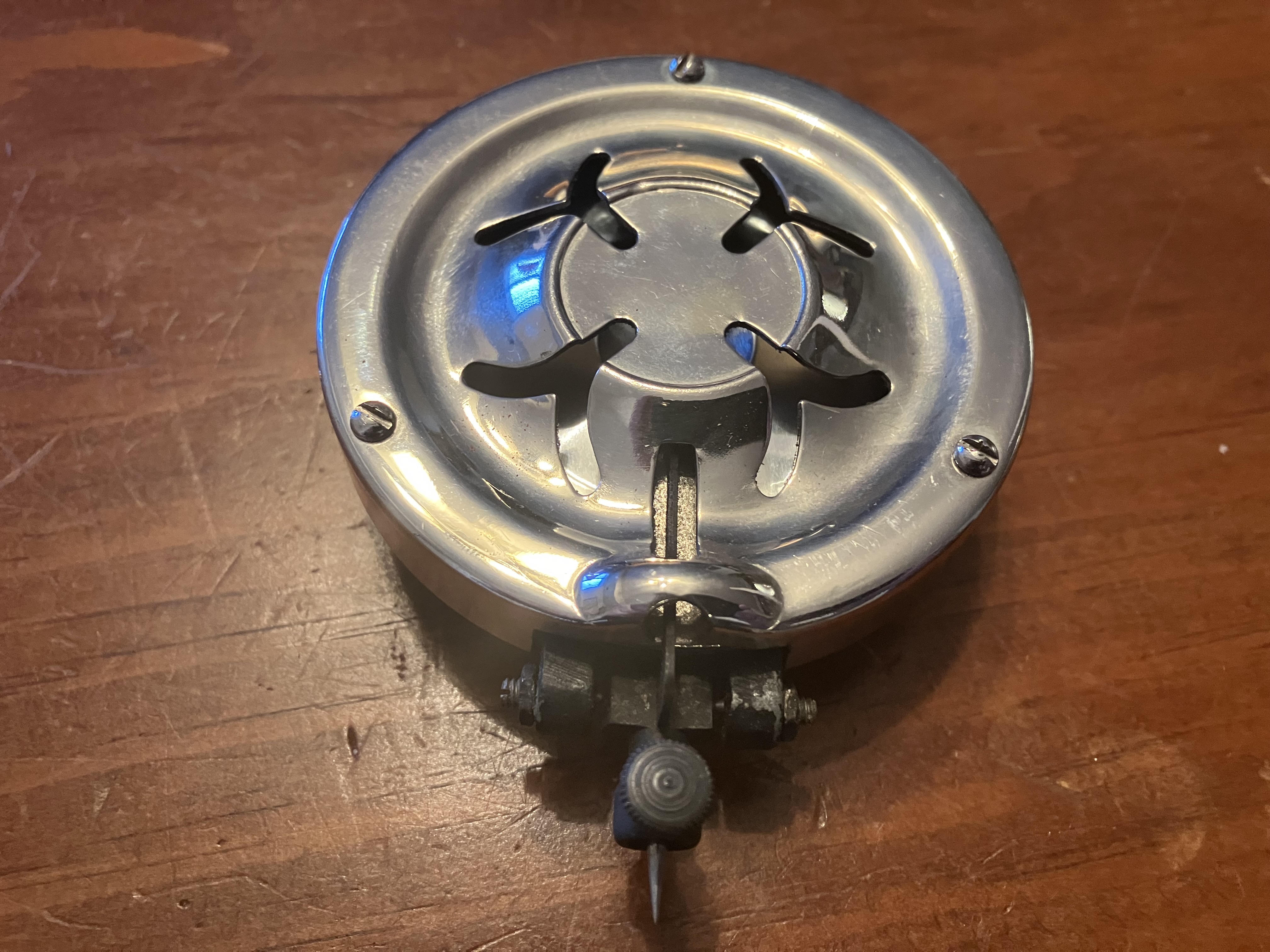

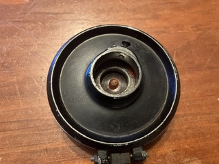

Okay, so my QRS Phonograph arrived today. However, inside rubber gasket that helps hold the sound box to the tone arm has deteriorated (no surprise) the old gasket was red. Just need help in where to find a similar one.

You can try one of the red neck rubber connectors made for the meltrope or EMG/expert soundboxes. Search on eBay.
Important details are the inner diameter of the soundbox metal neck and outer diameter of the tonearm at the connection.
If you give me these measures I can tell you if any of the two common red rubber types for hmv would fit (I have one of each in different machines).

Inner diameter of the sound box is 1 inch and ¾ in.
The tone arm 1 inch and ⅝ in.

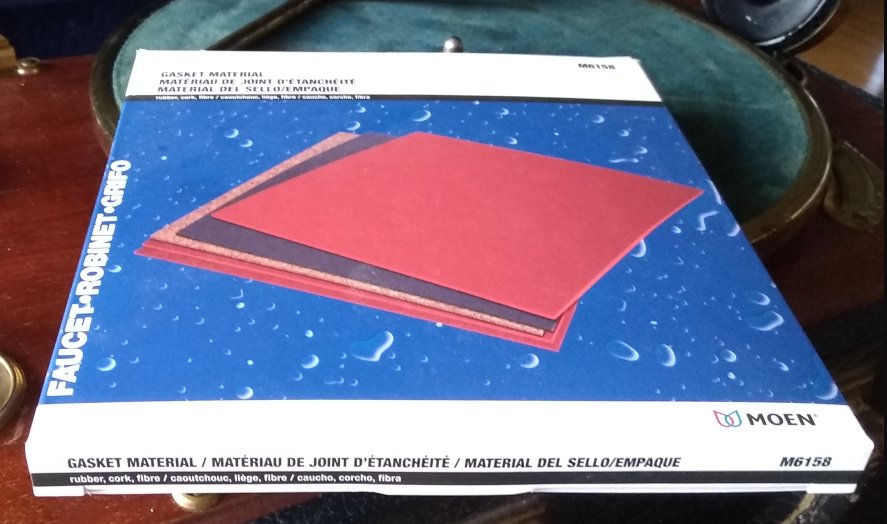

I have found multiple gramophone-related uses for this HomeDespot-purchased package of gasket material, including making quite a serviceable red throat gasket for my 1941 RCA Victor/(Birch) portable.
If you were concerned about leakage at the seam where the ends of the strip of material meet, a small amount of judiciously applied clear and inobtrusive silicone sealer could help.

Thank you, but, I was hoping to find something premade so I don’t have a pile of rubber sheets lying around.
Then use what you need and throw the rest away.
