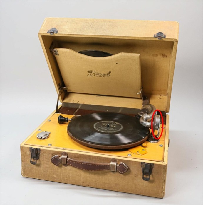

Here's a maintenance tip. I found a picture of a Birch 700 online:
The part that I've circled in red, which collectors in the United States will generally call the "reproducer" and those in England the "sound box," usually needs restoration to sound its best. The way these things work is that they have a diaphragm supported by elastic (in those days, usually rubber) gaskets and caused to vibrate by the needle through a link with a thumbscrew. Over time, the gaskets will have hardened, causing the diaphragm to buzz rather than play cleanly, and the lubrication of the pivots for the needle bar (the link) will have dried out, too. Putting in new gaskets and otherwise tuning the thing up can make an unimaginable difference in how it will sound. You can find videos on YouTube explaining how to do it yourself, but I'd enthusiastically recommend contacting Wyatt Markus, who is a forum member, and hiring him to do the overhaul. It's not terribly expensive, and he has a magic touch with these things.
[edit] Oh, by the way, the record shown on that Birch has a label marking it as from the early period I mentioned in my previous post. A rule of thumb: if a Victor record credits the Victor Talking Machine Co., it's pre-1930, and playback speed is open to question. If it mentions RCA, it's post-1930, and it *probably* plays at 78.

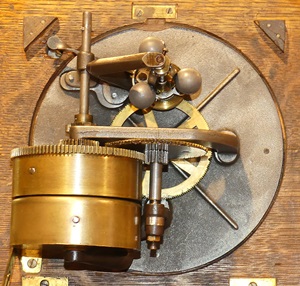

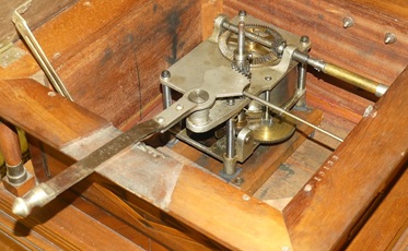

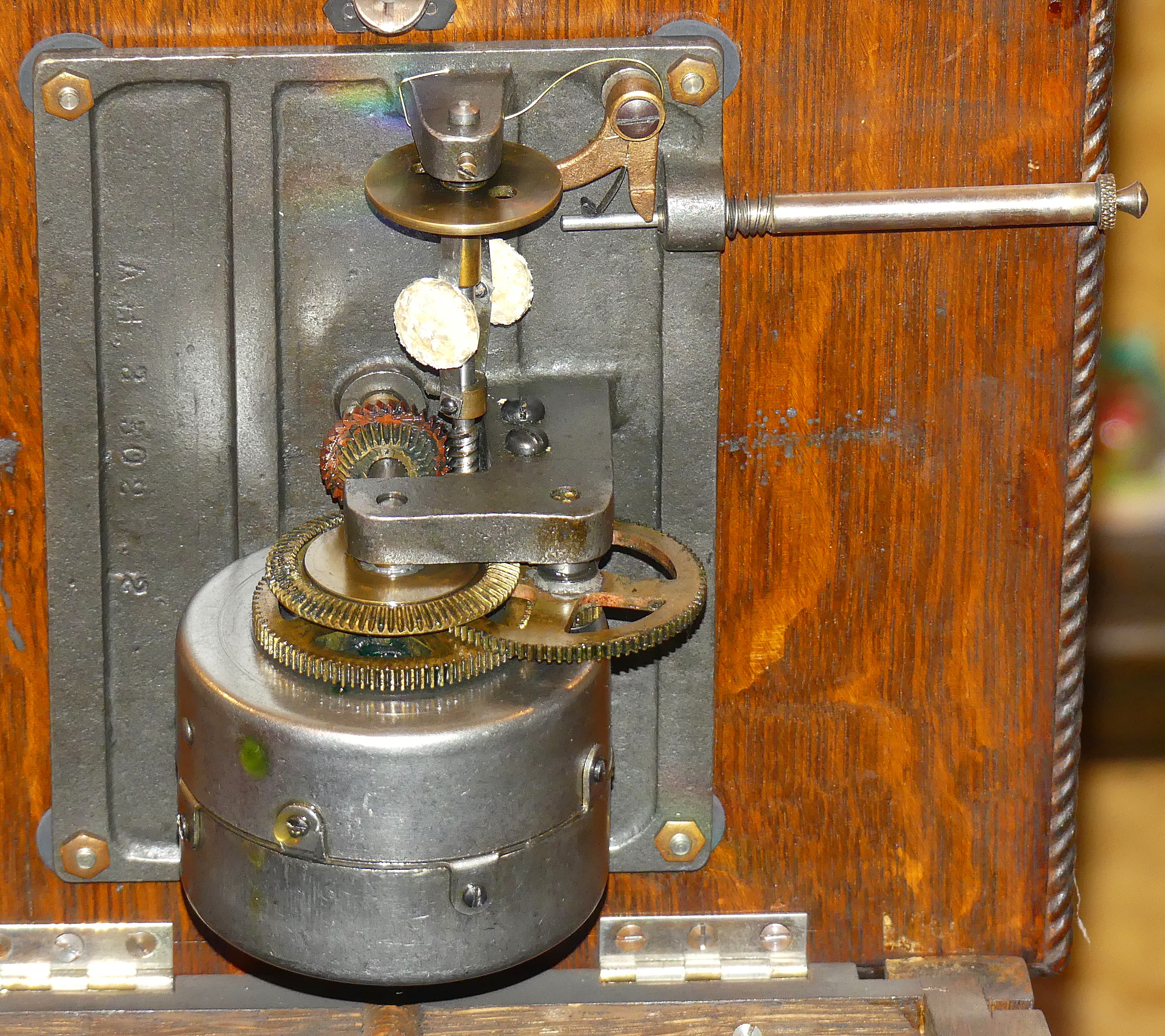

You probably should have the motor serviced as well. It's a spring device, like a wind-up clock movement. After all these years, it's doubtless covered in old grease and oil that has congealed and that will cause undue wear to the gears. Here are pictures of a few such motors; they're all much earlier, heavier, and more powerful than what will be in the Birch, but they will give you an idea of the variety of designs you can encounter in old machines.
