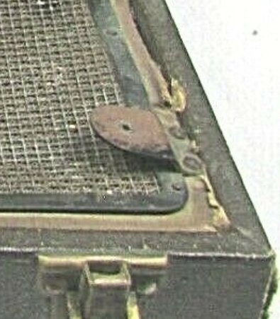

With absolutely no certainty or firsthand knowledge, I still suspect that the missing item from the motor board is a needle cup.
2024-12-01 07.14.59 forum.talkingmachine.info dc4e3d345b41.jpg (44.61 KiB) Viewed 15912 times

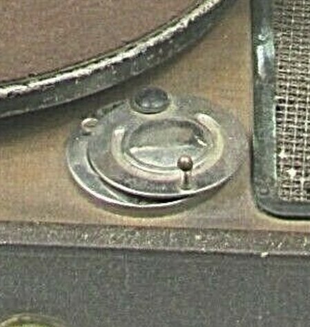

I further suspect that this below is the needle rest and arm lock thing, something requiring a needle to be left if the chuck for transport of the machine.
2024-12-01 07.15.21 forum.talkingmachine.info 862d2bc0c48b.jpg (38.14 KiB) Viewed 15912 times
