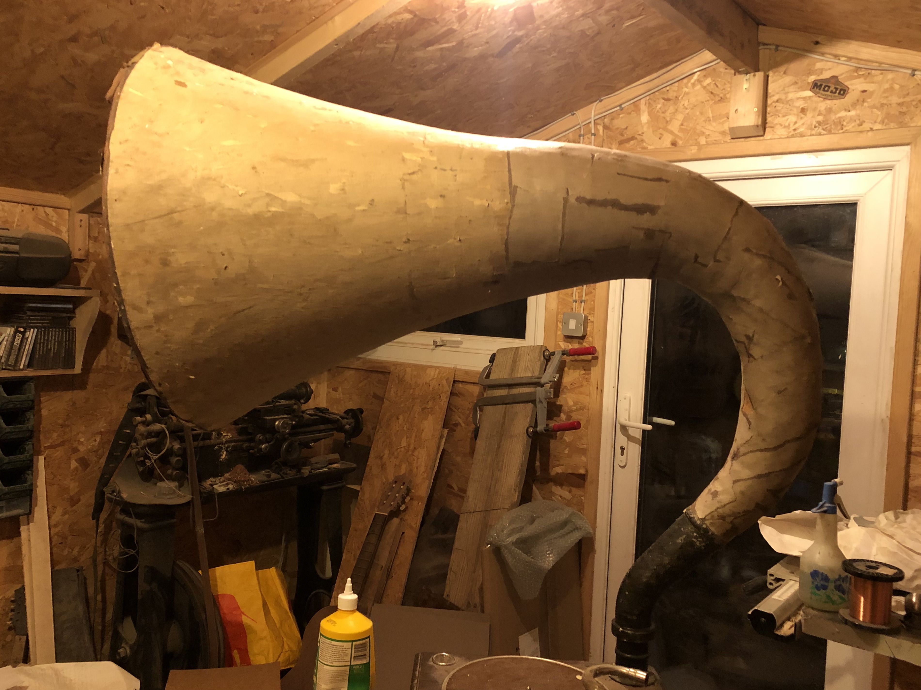

These horns were originally built around a very complex collapsible former, I was hesitant to go down that route, as I didn’t really need the former to be reusable, so I did a far simpler former, loosely glued together so it could be broken out of the mouth of the horn once complete, made to match the shape of a complete Mk IX horn traced 1:1 from blown up images, reduced to the internal dimensions, the former as seen in these images was wrapped prior to the initial layers to span the gaps and void any internal edges
This is a late horn (1947) and they were still using newspaper in sections even then, under the internal finishing papers

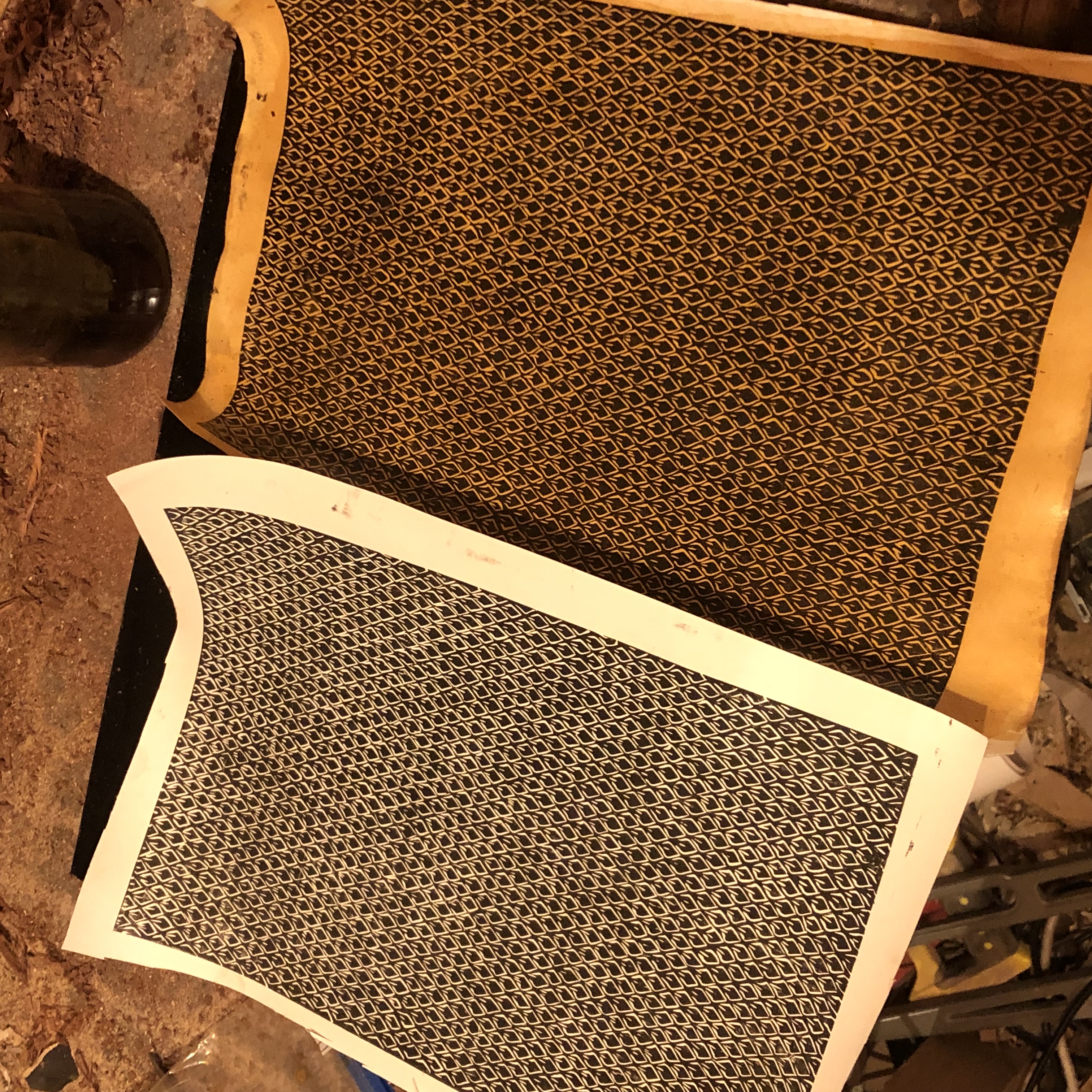

A challenge with EMG horn restoration are the finishing papers, there are no modern alternatives that are a suitable match to the originals, so the only way to sort that that is to go the long way round and make the finishing papers myself, I made a printing block, carved 1,370 scales into it and printed some papers which once treated with a dyed shellac mix, have a remarkable resemblance to the original EMG reptilian horn paper as it is seen now 80 and 90 years later
First picture showing I riginal EMG horn paper used for measurement and design reference, taken from Graham Rankin’s “Krakenhorn” EMG mk Xb Oversize
And finally the finished horn, it was a big restoration project but I’m very pleased with the outcome, all repair work was done in Paper Appliqué, alternating layer colours are necessary in order to show visually when a paper layer is complete, I went as far as using paper the same colours as the original, so should someone theoretically take a saw to it (again) you wouldn’t be able to tell necessarily where the original paper ends and new starts.
