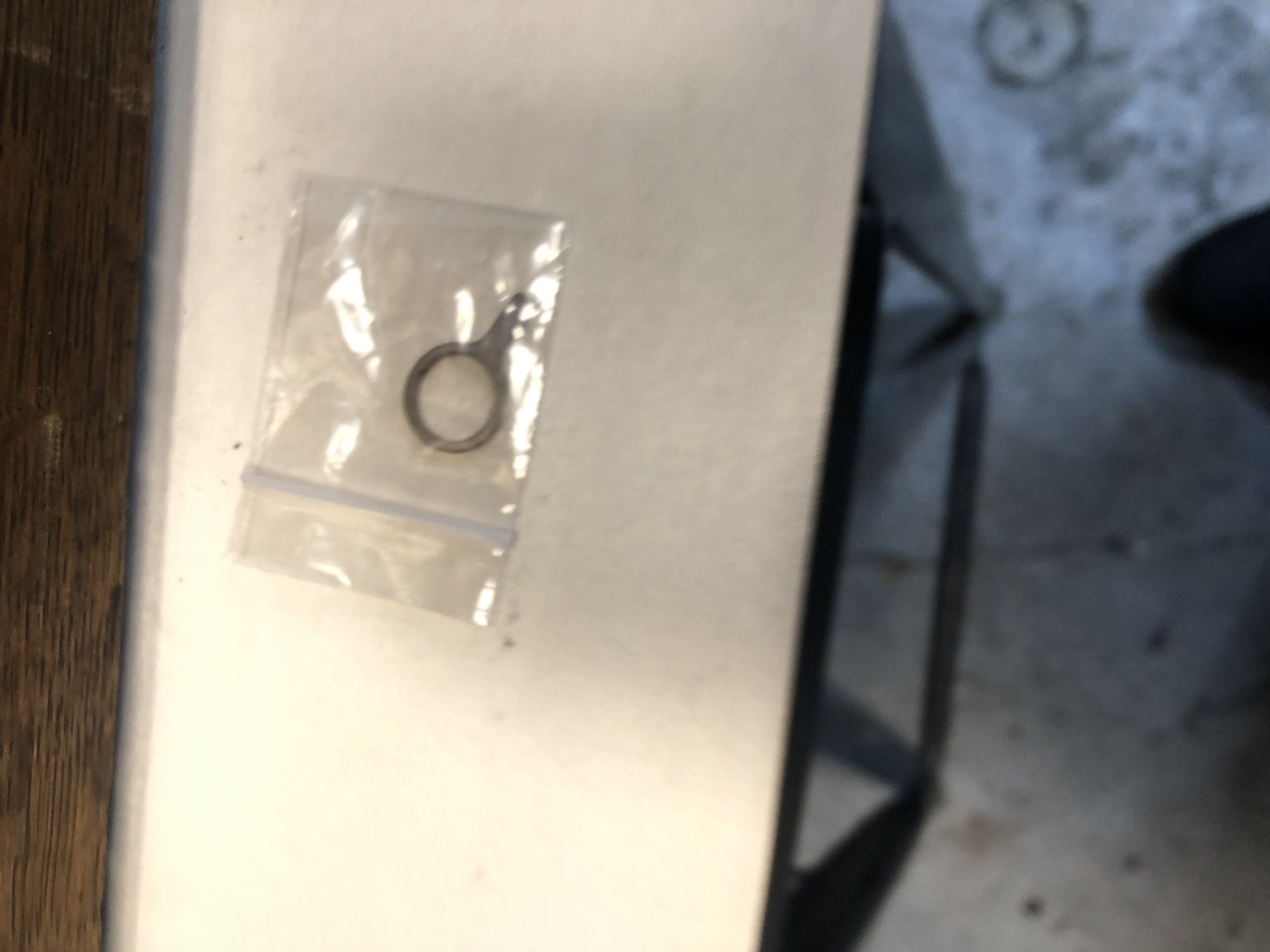

Re: Columbia Q lift collar help
This is the part
Okay. That's what I had in mind. If you don't want to do solder, then a tiny bit of epoxy would work as well. George, however, claims to do well with press fit only. No harm in trying that if it works for you. If you do want to use solder, just the absolute smallest amount is all you need.
