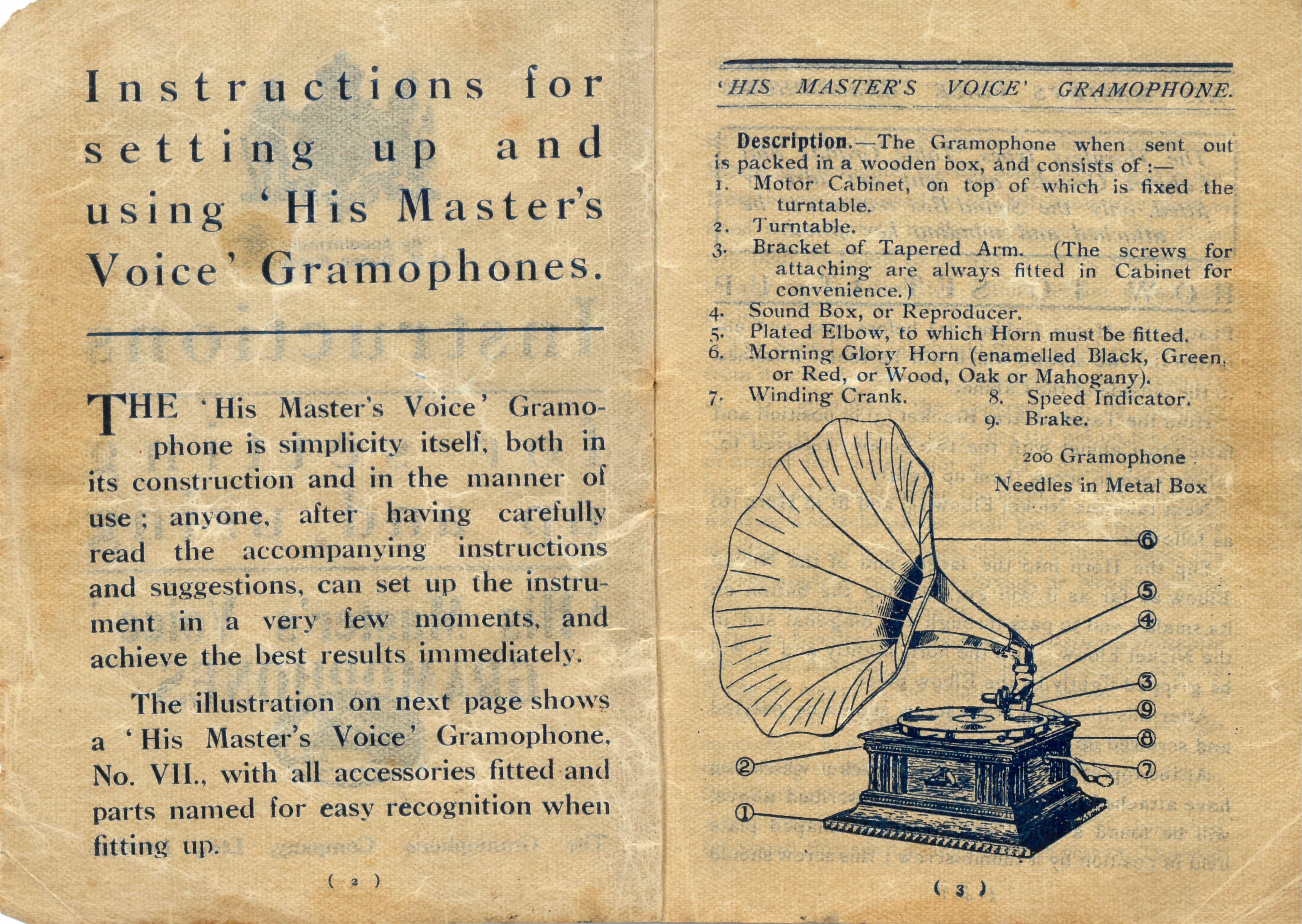

This fascinating leaflet in my possession was clearly supplied with new machines. It measures about 3 ¾ x 5 inches. I've no idea whether it has been posted here before, but I thought I'd upload it. No doubt someone will give us a fairly accurate date! The little tear-off piece (if that's what it is) attached to the back is intriguing - perhaps the remains of a warranty slip or something similar?

Very interesting, thank you for posting. Also the HMV style No. 7 shown would date this to around 1910-12. I was interested that the winding handle is referred to as a ‘crank’ I always thought of that term as American.
